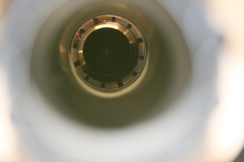

They will get hot during a static run, that's normal. In flight they get the airflow to cool them down. I really dont thing the gap is a big issue as long as the bypass is securely attached and the turbine exhaust is centered with the tailpipe. A picture would help

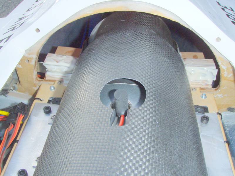

Here ya go: The best one I could get. Its not mounted just laying on top of the motor.
Thanks again for all of your help.
Andy

Default RE: By-Pass Question
I would not use it the way it is in the photo. Does your engine line up with the tailpipe? ie- center of the enigine= center of tailpipe.
Yes it does. The bypass doesn't match the circumferance of the bellhousing. It's warped as you can see.
See pick.
