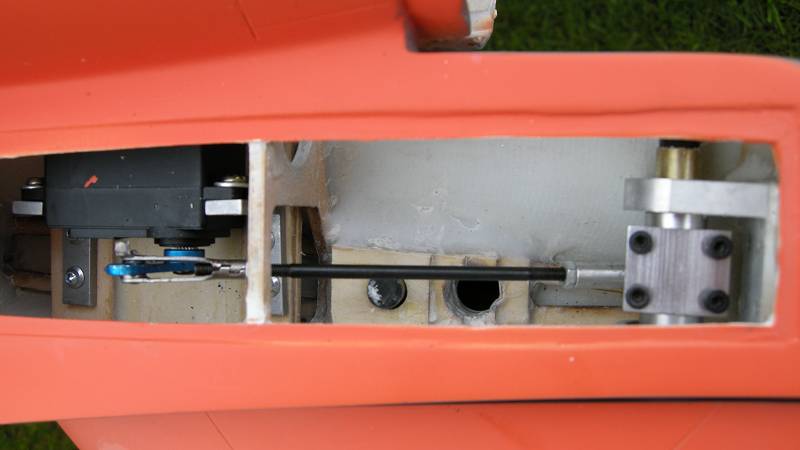

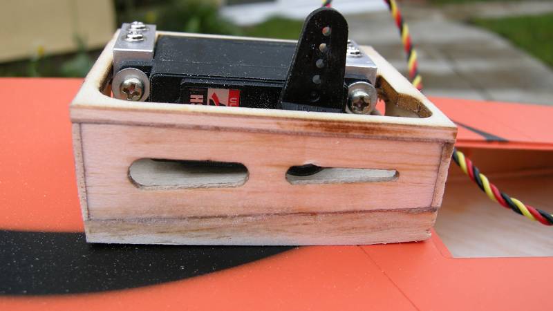

Hi All, at last i have got started on the F15,i have found that the flap servo needs to be raised up out of the wing as the wood cradle is to low,you could fit a longer arm but this puts more load on the servo which is a Hitec 645[flap] for ailerons i am using hitec digital5645mg 10.3 kg at 4.8volts regards Keith W

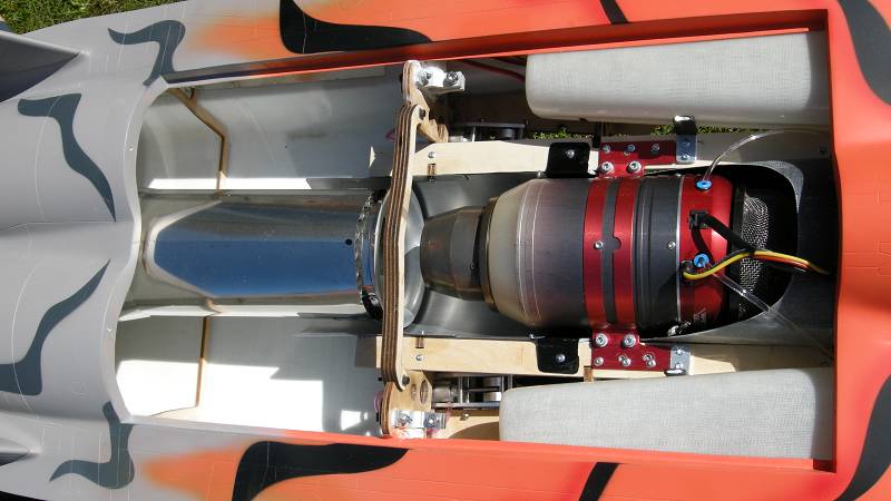

Hi Keith,
What size engine are you going to put in the F-15? Will you be using ceramic blanket or other means to shield from engine and pipe heat?
Regards,
Mike
Regards,
Mike
Joined: Feb 2005
Posts: 415
From: norwich, UNITED KINGDOM
Hi Mike i am going to put a booster 130 engine in it,but i think this is over the top,i am sure it would fly quite well with a P80 as it seem,s to be coming out light,i will put a ceramic paper in the top as i did this with my jet legends F15 not sure weather it really needs it but best be safe than sorry regards KeithW

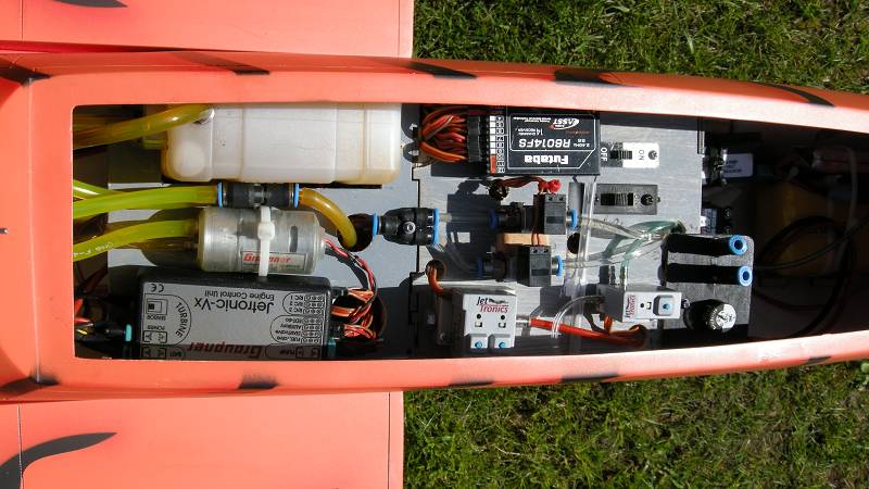

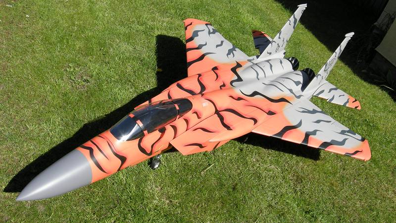

Hi All just a few pic,s of finnished FEJ F15 no problems worth a mention every thing was very straight forward flap servo had to have a piece of balsa to bring it out of the wing about 3/8 thick,finnished all up weight came out at 23lbs with 1ltr of fuel on board very good for this size of model,C/g came out spot on with batterys in front tray, will do maiden tomorrow regards Keith W
