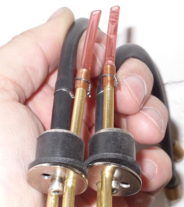

Hello Jason,
The tankstoppers are from a dealer in Berlin (http://www.airfighter.eu/) ~5 dollar for all ...
The rest is selfmade. The used material was carbon roving and a bit of 24h epoxy resin. to get the form i'fe use the tankstop itself
with a bit of releasing agent..
before i build this i used sander and thinner to clean and prepare the tank.

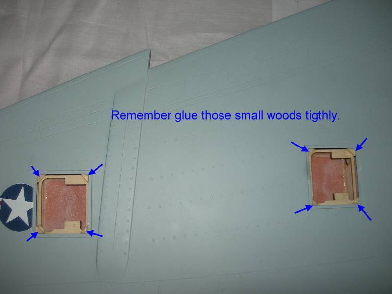

Funny I didn't get any "small woods" included with my jet. I also don't see them in this picture.
That would probably "fix" the issue I had and prevent it from happening. This would also provide something more substantial to screw the #0 screws into that attach the servo cover plates.
This is an evolution and I'm glad I got my jet back so I have a chance to make it right.

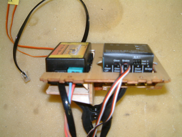

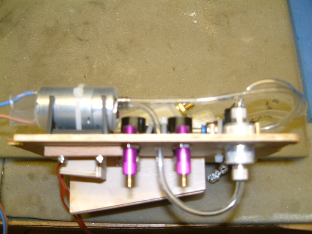

Hi Jason,

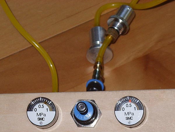

I use a barbed Y-connector after the Festovalve .. and use 2 further valves after the Y-connector... the festo one is a self closed valve vom Festo. It will bne close when you disconnect the tube.... from this.
I have a airsystgem for the retrakt an a 2nd airsystem for the brakes and geardoors ... i programmed the geardoorsequence with the T12fg TX... latest update (EU 1.6)
If you have a look to the picture you can see a Push-in Y-connector from festo ... i replace all the festo Push-in Y-connector where it is not usualy to use this because there are to expensive to use for nothing

Peter, your build is comming along nicely. Does the single festo on your air system plate service both tanks? If so, do you have check valves installed to prevent one system leak contaminating the other? I like your setup. I love the 12FG and have already been planning on a radio system upgrade. Futaba ofcourse! That will most likely be a purchase for next year.

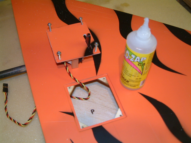

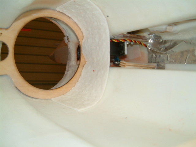

the "small wood" is for attaching the servo cover to the wing. I did something similar as the edges were too narrow for screw engagement. I do not remember if it was on this thread or the other, but I recomended Using strips of FG to secure the servo box. There just is not enough surface contact to prevent shear. Congrats non the first flight hope you have many more safe flights.

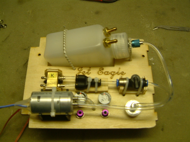

today were the day were i made the last things on my tanks .... ( not mine ... f15'th
the maintanks now are prepared to fit with festo 4mm tubes. I canged all messing pipes with a little bit bigger ones. The outside diamieter before was 3.45 mm and now is it 4mm.
The middle tank is now prepared to use 6mm Festo tubes.... as same as the UAT ... [sm=thumbup.gif]
I hope that i can build in the tanks into the f15 and can forget them for all times [8D]

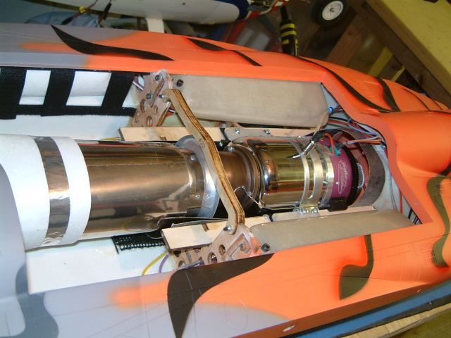

Hi Guys – Just put the finishing touches to the Eagle and I am please to say she comes out at 25 pounds dry.
C of G 150 aft (gear up) but may move some weight to the rear after her maiden.
My set up is elevon control and flaps. Kero start with Lipo’s. I have a battery backer using two 6v 5cell 2600ma packs. Three air tanks two in the rear for the gear and the break air is in the nose. 2.4 GHz Futaba FASST TM – 8 RF R608FS Receiver.
Digital Hitec 5965 for the Elevons and 645’s for the flaps and nose wheel.

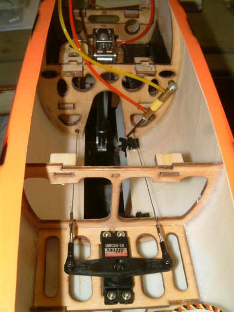

The flap servo covers were backed with glass fibre and the servo installed direct. Beef up the corners so that you can secure the covers with cap screws.
I have used all the Eagle jet hardware and the only problem was with a leaking door ram [>:]which was sealed.
I also ordered the Eagle Jet Cockpit which was very poor and some work had to be done to make it fit. Apparently the cockpit bucket is supposed to come with the kit. (Another e-mail to James) One arrived very quickly and his e-mail replies are super quick.
You will notice in my photos that I have also stuck some heat blanket around potential hot spots and covered the elevon servos.
Just waiting for some fine weather for the maiden – Hope this helps those still in the build process.

at 150 your CG is way too far forward. Once again the gear retract forward so it needs to be balanced with the gear DOWN. I have mine at 165 right now and it still feels nose heavy sometimes. Get rid of the blanket around the pipe unless you need tail weight. Its a dual walled pipe and the outer pipe never gets much more than 100 F. Put some padding between the wing spar clamps and the tanks, the tanks are not thick to begin with and it will erode thru. I cant really tell from you shot positions but you pipe gap looks on the small side. It should be about 20-25 mm. One last thing-Move your cables on the stearing servo as far in as possible. You have then set for max throw right now. These can be squirrels on the ground and you are just going to make it worse with all that throw. Have fun. Scott
