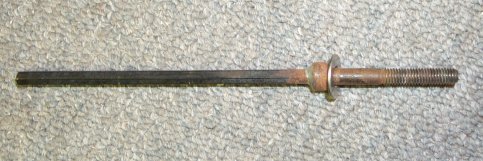

Ok guys...
Here is a simple solution that has work perfectly for me....
Take an allen wrench an cut the "L" off so you have a straight hex shaft that fits inside the head of an appropriate allen bolt your using to bolt the wing on. Silver solder the hex shaft into the head of the bolt, make sure it is straight. You can now install and tighten your wing bolt from the wheel well. A simple 1/4" drive socket wrench with the appropriate size socket is used to tighten the bolt by sliding it onto the hex shaft which will be at about the same location as your wheel (but above it). If you have any questions I can supply pictures....
Todd

Had a few request pictures....
Here they are...
Bolt with allen wrench soldered to it...

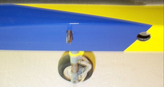

Old 05-02-2003 | 09:44 PM
lov2flyrc's Avatar
My Feedback: (24)
Posts: 6,102
From: Daytona Beach
Default Roo Wing Attachment???
and the bolt thru the fuse at the wheel well

Todd, is your's composite? On mine, the bolt hole is something like two inches aft of the wheel well.
Old 05-03-2003 | 01:33 AM
lov2flyrc's Avatar
My Feedback: (24)
Posts: 6,102
From: Daytona Beach
Sean...
No this is the older kit but it does not matter, you can make the wing bolt anywhere you want it to be. Just add anouther blind nut inside the wing....
Todd
