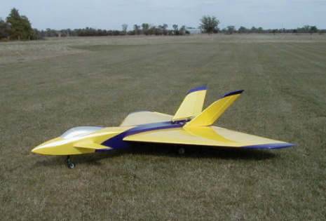

Oh great, just when I finish painting and clean the gun for the last time, along comes the instructions.
Would like to see your methods.
Thanks to Steven Ellzey and David Reid for their help in my first painting endeavor with automotive paint.
Also thanks to Joey Tamez for his advice on buffing.
BTW - my paint job came out pretty good, I think
