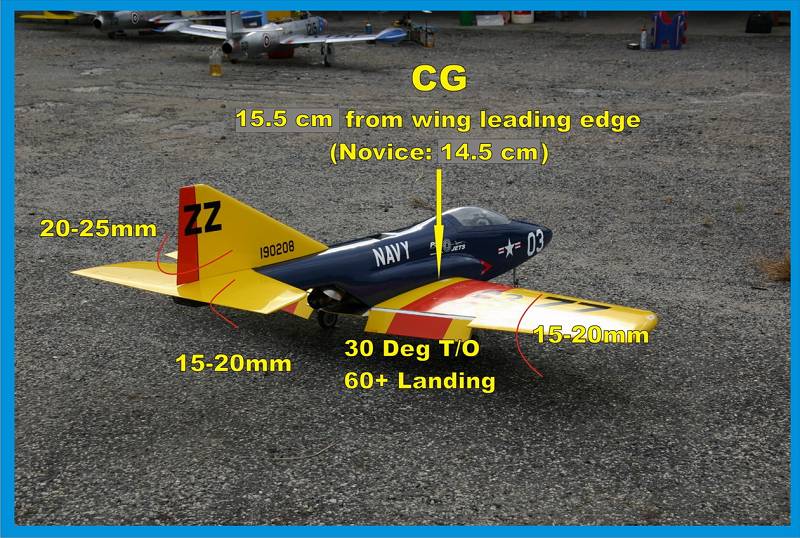

Manual is coming but for experienced builders, the Reaction is very straight forward. There was a construction photos on a CD with your kit. Please ask for this. I will post what I can on here as well. The throws and CG for a start.
Regards,
Kraivuth S.

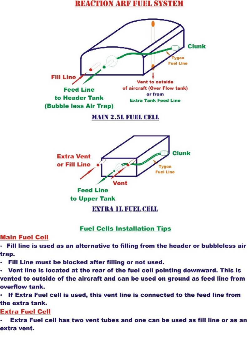

I have the fuel tanks layout and schematic here to help with installation and plumbing.
Regards,
Kraivuth S.
