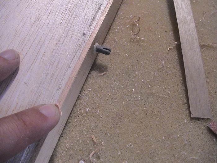

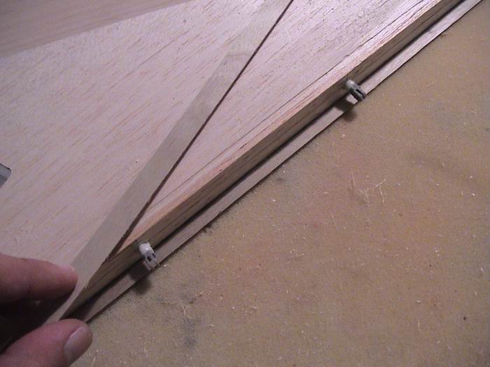

This is what it should look like. Clean up any loose balsa or rough areas with Permagrit files

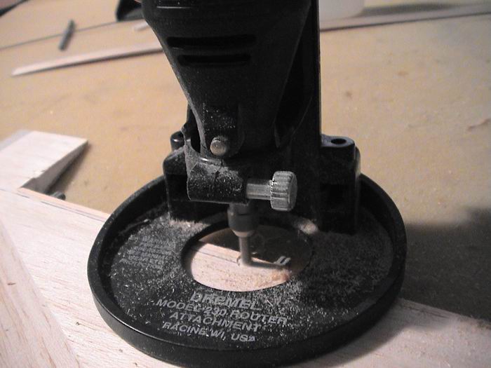

I use this Dremel freehand router for the next step. I guess you could also use a sanding block with a strip of 80 grit on it, but I have not tried that.
Now PRACTICE on some scrap balsa, and set the router depth so that the cap will fit flush in the pocket formed by the router. Now get up your nerve and route out the pocket you drew in the previous step.

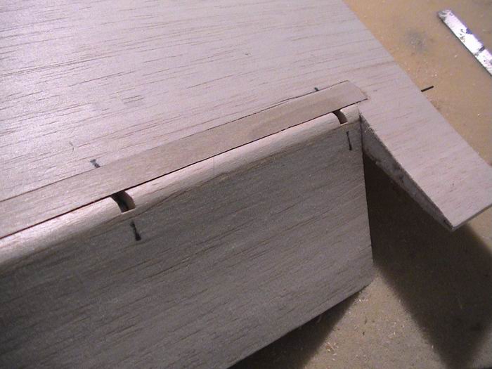

Glue one cap on at a time. I use the Gluit, and tape the cap in place to dry with the elevon installed. This is what the bottom looks like just before gluing on the cap.

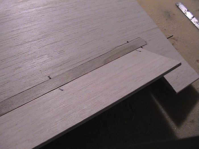

Here it goes just before the glue dries.

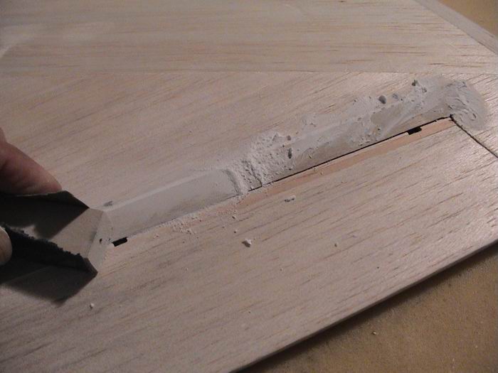

Go back and fill any gaps with Model Magic.

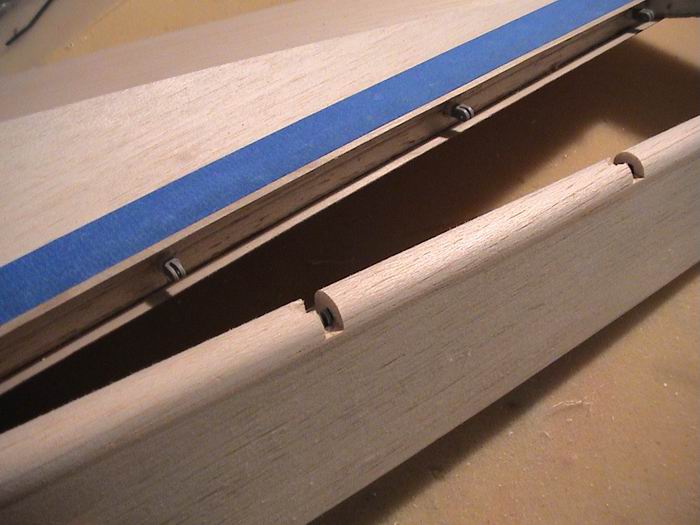

wonderful tutorial. I will be using soon. I understand how the long wire lines up all the hinges. one question I seem to miss. what sets the actual hinge depth, that is how much of the hinge hangs out of the trailing edge in post #13?
I love the idea of building the leading edge cap around the pivot point. rather than just "wallering" out the balsa.
Hi Pat,
Yeah I looked back through my photos, and I did not have one that showed the depth of the hinge. Just imagine the center of the hinge wire. It lines up precisely with the cap on the leading edge of the elevon. In other words it lies half way in the trough that you make in the leading edge of the elevon, before putting the cap on.
Yep that is the beauty of the whole thing. I do all of the composite surfaces on the Bandits and F-4 the same way.
