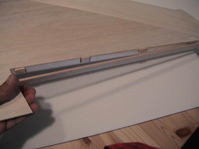

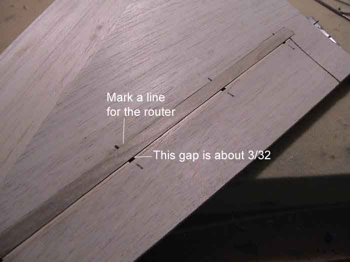

I am hinging a Yellow Aircraft Stingray wing. This is slightly unusual, as the elevons are already partially removed and feature a precut gap. Normally the gap is carefully measured and cut, in this case I kind of had to make it up as I went along. Anyway, since I use Robart large hinge points, I need full depth penetration of the hinge to get maximum shear strength. So first I route out some holes in the foam and insert hard balsa plugs, sanded to fit against the skins as best as I can without warping the skins. I glue these in with white glue or epoxy. I put matching plugs into the elevons as well.

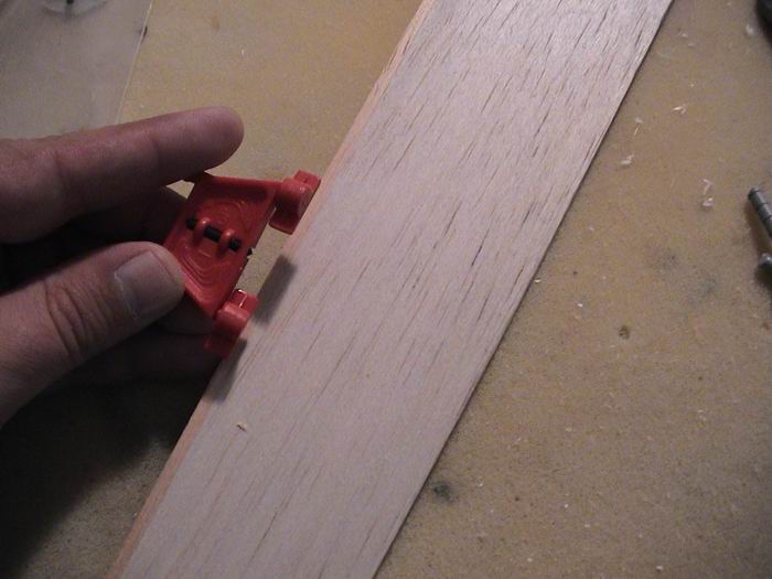

Trial fit ˝ of the hinge (you can actually buy the hinge points from Robart without the pins installed, or just cut them with a pair of small dykes). This shows how deep the hinges will need to go in. The hinge line itself is coincident with the edge of the elevon, BTW.

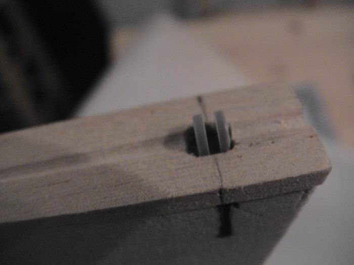

Now dry fit all of the hinges. It is a good idea to set the orientation of the “tangs” in some consistent way so you will not get it mixed up later. Anyway, with a piece of .055 music wire, line up the hinges. Almost no matter how careful you were while drilling, you will need to use those files to get the holes tweaked so that this pin is straight.

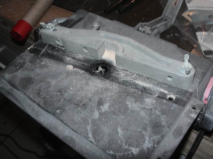

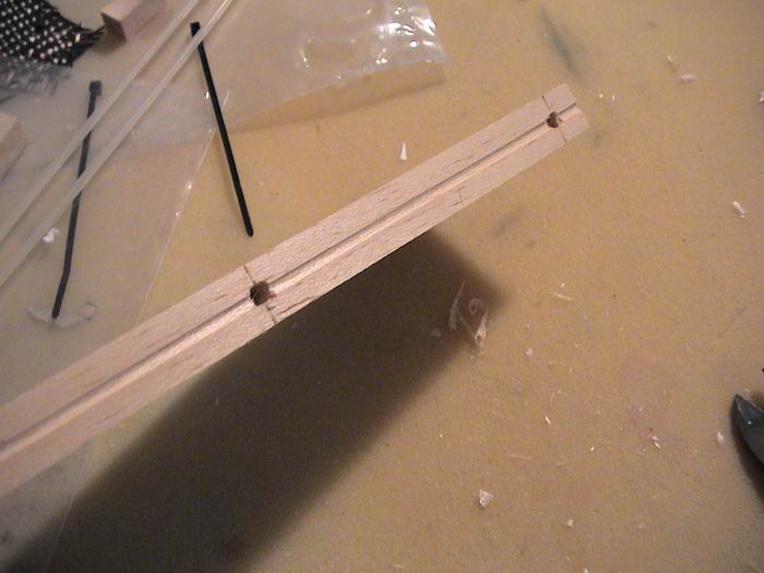

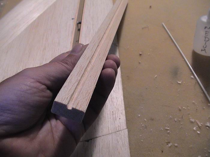

Now its time to make the elevon leading edge cap. Get some oversized medium balsa, and groove it, either with hand tools, or with a router.

I use one of these from Dremel. Can never have enough tools!

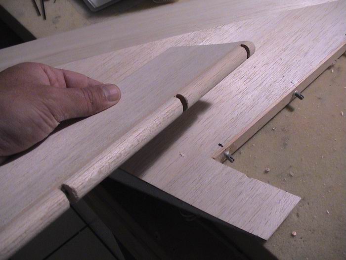

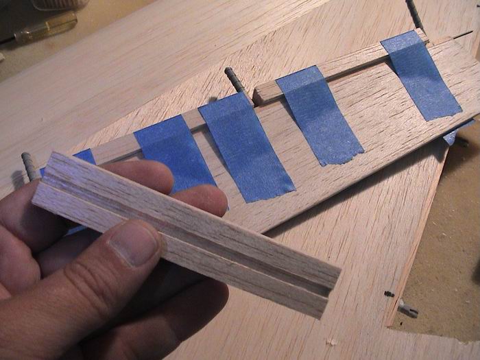

Cut sections of the routed leading edge cap to fit between the hinges. Install some extra hinge points with the hinge pin in order to check clearances. Glue them on with Gluit and tape them down.

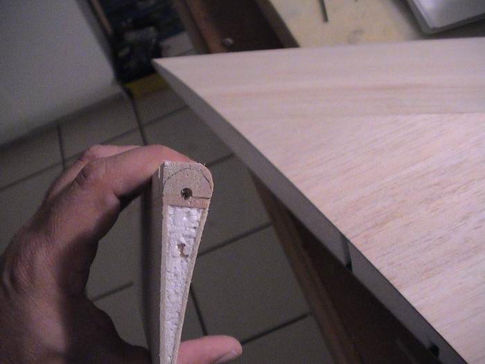

Now I mark the semi circle that is defined at the center by the hinge pin and the outer edges of the elevon trailing edge. Try to get this accurate. Sometimes I make a little template out of polyply, but here I just drew them on using a paper template.

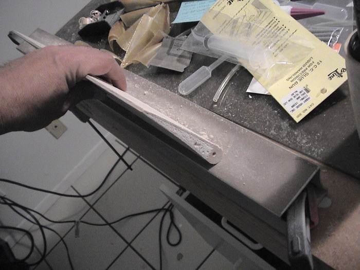

Now I clamp a long Permagrit sanding block to the bench (after clearing enough junk) and start cutting down the radius of the leading edge. Take your time and check the end template marks often. This step does involve some pretty handy craftsmanship so take your time.

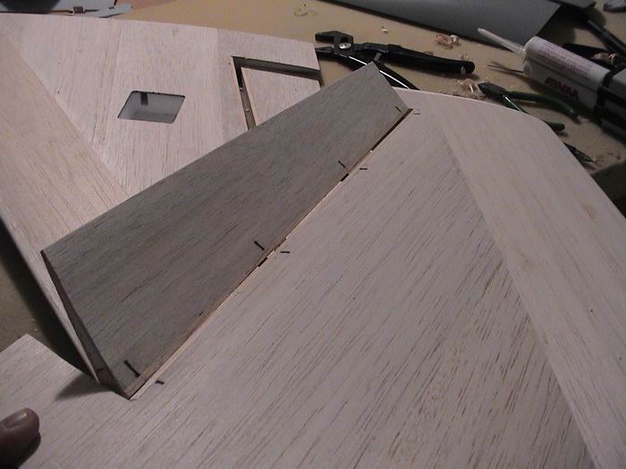

Lay the 1/64 ply cap on the hinge gap, and move the elevon up and down to get an idea of what kind of cap clearance you are going to need . I usually end up about 3/32 back from the hinge line. Mark a line all around the cap where is touches the wing.
