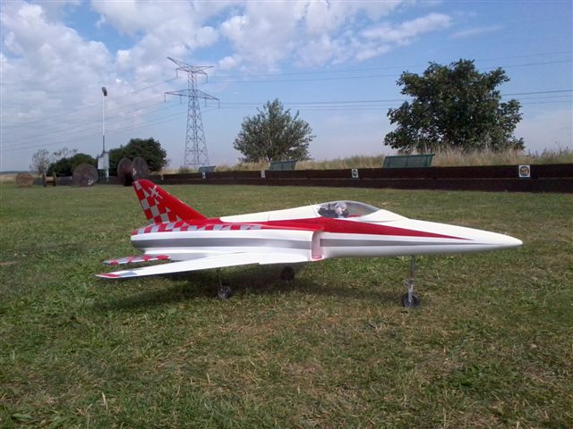

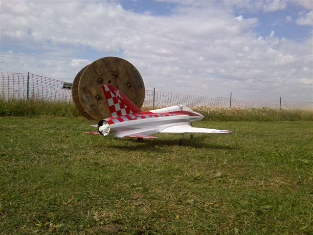

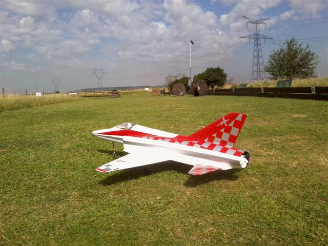

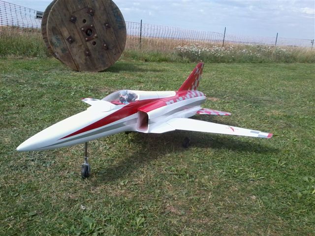

Hi Paul,
I used always your PMP pipe and O ring system now I am flying a Spectre ( look my last post here ) and broke the two PMP pipe I had, where can I found these pipe plus the 2 black O ring , the bumper ring , the expoxy part that fit between the manifold and the pipe, also I never found exactly where you attach the pipe with the big O ring at the end of the pipe or at the middle near the balance point ?
I also have a weston uk inox short pipe but need the O ring ( they are smaller than those needed on your pipe )
thank you Paul ( if you are Paul Gray the maker of these nice and good pipes )
Daniel
