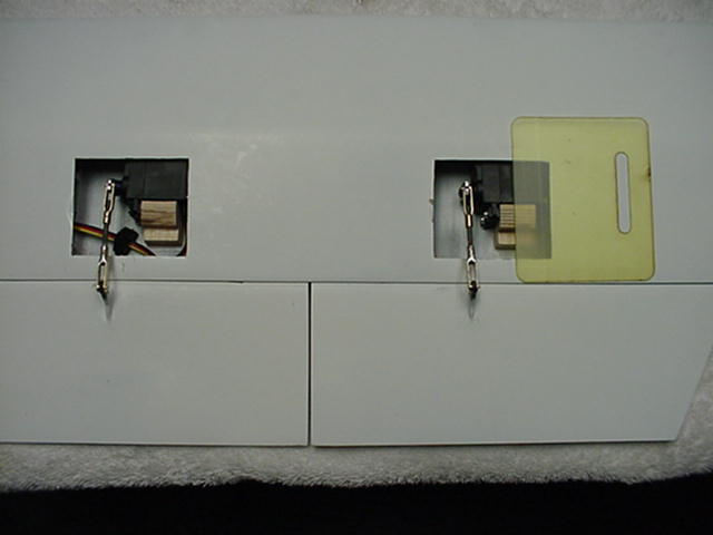

Hi Guys I have been following this post for some time and I decided to go to the full size servos for my new Bob Cat. I used Hitec digital 5925's Torque is 102.7 at 4.8 volts and at 6vt. it goes up to 127.7. As you can see by the photo by moving the servo forward and using a two pice hard wood back brace it will allow the servo covers to fit.The forward part of the servo interlocks with the webbing and will not move in any direction.And by using a two piece hardwood block the servo can be removed fairly easy. Take it for it is worth.or my 2 cents no charge.
Thanks and good luck. Paul Hopkins JPOFL

I tried to mount an 8411 the same way but found it would not fit that far forward without having to grind the spar at the center of the elevator. Although it probably would not affect the strength of the elevator enough to matter I was not willing to chance it. I am curious how you were able to get the hitec to fit, did you have to grind away any of the structure? You dont have any concerns that the front of the servo is not mounted (I realize it is wedged between the spars and the ply webbing), the servo does not want to shift side to side??

Hi Todd. Yes I did cut the vertical webbing to a slot but the webbing is fairly soft wood. Loss of strength was minimal. To the extra torque that I got with the Hitec servo. However I did (not) cut the structural part of the spar. Just cut a vertical slot in the webbing. By using the two hard wood blocks laid on there side and tapered the wood so the cover would fit. The servo can not move in any direction. So I feel that it will work just fine. But the test will come in flight. If I thought it would fail I would never risk the airframe or Safety. Since I live in the same town as BV and see him often I am sure he will check it out. I want to make it clear that this is what I did to overcome the Torque issue, and I am just offering my two cents worth. I am not saying this is the best way to do this. It is just a idea and if someone else uses this they should consider all options. I may catch some flack
from BV on this because I change the design in my aircraft. I will have to take the respectability for my changes!!!!
Safety First!!! Good Luck and Good Flying !!
Paul Hopkins JPOFL

There must be a slight size diffrence between the 8411 and the 5925, second check on mine and I would have to grind the spar to get the 8411 to fit. Much more comfortable with mounting the servo further back in the hole allowing mounting both sides of the servo firmly. I thank you for the information though
