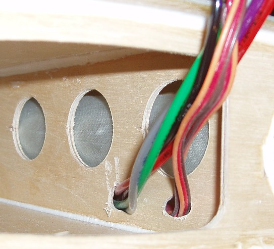

All, I have purchased the upgrade wing kit to convert my classic Lightnin to Ultra. But I found no space anymore to pass the air lines and cables from the front half of the wings, infront of the wing tube.
ANy ideas or pics how to do this instead of making another hole in the Lightning fus behind the wing tube?
Thanks alot, Tassos

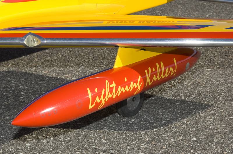

I agree with you Jason!
Personally! I think Lightning/Ultra Lightning looks like a Crocodile!!
Regards
Owner of a Lightning killer!
Lasse Palm

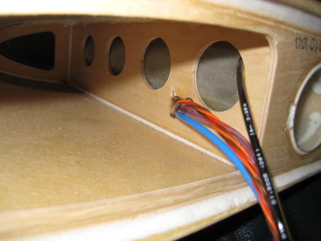

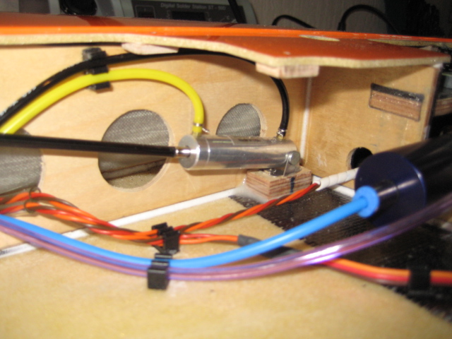

In my UL wings I dremeled a hole to pass through below the wing socket. It was not an easywire pull with 5 airlines and 2 servo leads. I made a seperate hole for the servo leads.

Can you please post a pic quist? And can you please take a pic of the aileron linkage to show me how you ve done it because it looks to me that for the UL wing the servo sits "deeper in the aileron servo bay opening than the Classic Lightning.

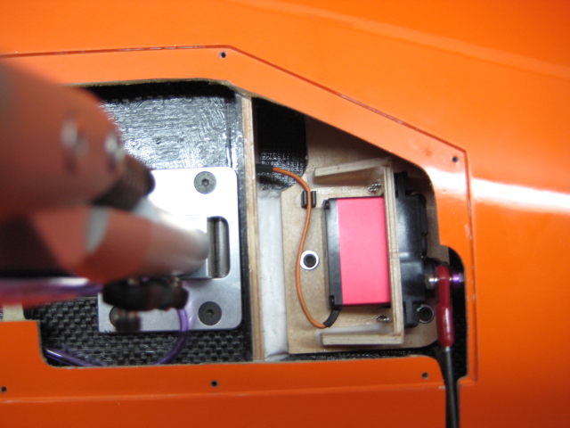

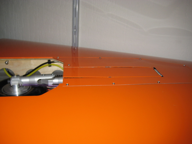

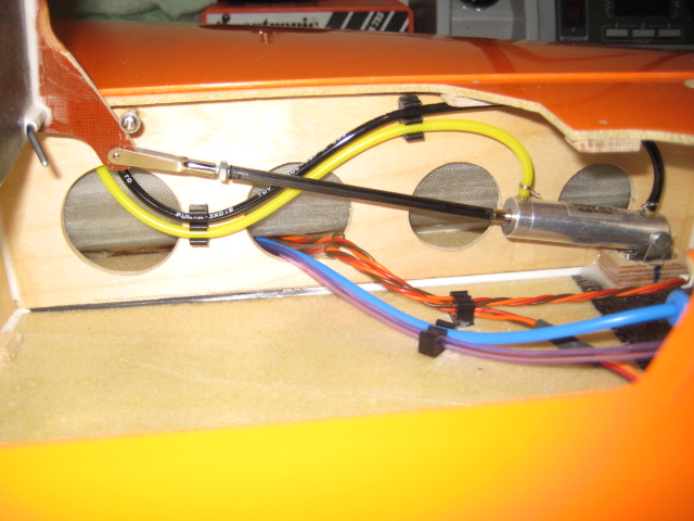

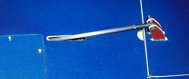

Tassos,
You are correct about the aileron linkage. I didn't like how long the linkage was so I put a carbon sleeve over the all thread. I did this on the Rudder and Elevators also.
The Ultra Bandit is an awesome plane, but I don't think it is worth the extra $7000. I also don't think it will fly as well on the titan se motor.

Got it now.
Thanks alot quist, I was planning to do the same thing in the linkages but to use brass tube instead of carbon to strengthen it.
For sure the BVM models are great but $7000 more? I'd buy a second Lightning in different colour scheme just not to get borred like the one of this post: http://www.rcuniverse.com/forum/m_82...tm.htm#8237546.

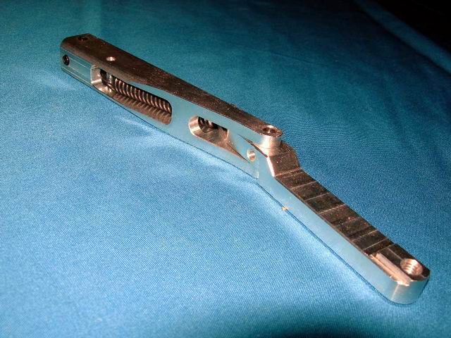

Does anybody knows where i can get Alum. gear door Mount like the picture.????
Thank you !!!
Nikki Ko

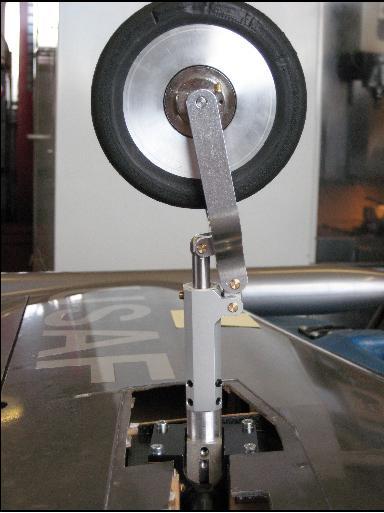

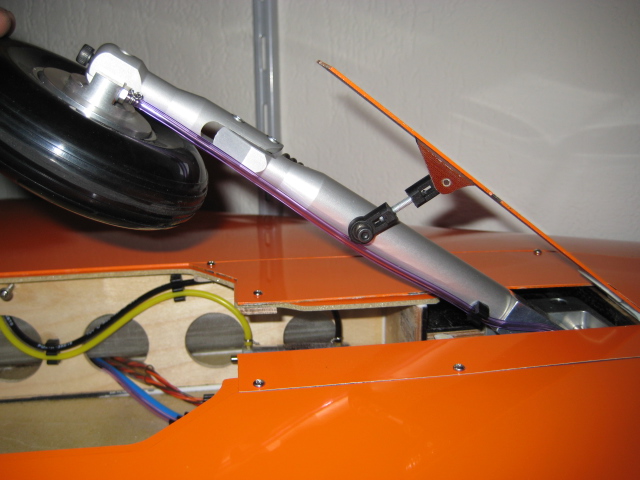

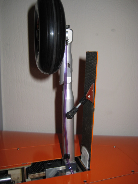

Here some pictures of the Jet-1A/Prolynx landing gear that is currently installed in the wing of my UL.

ORIGINAL: jet513
Your Comp-Arf Rep should be able to get them. Look under the older style Lightning, Related Products, Retracts, then Spare Parts... direct link here... http://www.composite-arf.com.hk/ar/Product?630515

If you have a choice of Jet 1a or Comp-stock landing gear , What would you pick???
The stock one seems nice too. Is that a lot heavier than Jet 1a????

We are running the new Comp arf trailing link gear. I have no idea whole makes these struts. They don't look as nice as the Jet 1A gear but they are working perfect. We are going to get rid of the Interairco tires and put on the BVM Mig 15 tires. They are 4" narrow tires. It may be a pain to screw the BVM tires in place, but they don't leave the rim.

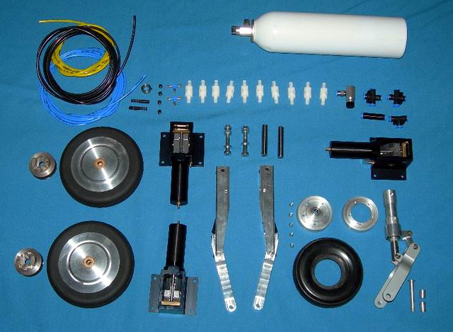

I looked altecare landing strut. That looks great too... Man!! ...hard to pick...
Is that the one??
Nikki Ko

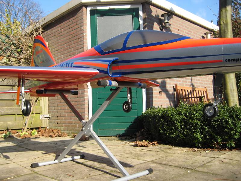

Old 03-24-2009 | 01:31 PM
  #75
Joined: Dec 2002
Posts: 603
Received 50 Likes on 30 Posts
From: Hoofddorp, NETHERLANDS
Default RE: Ultra Lightning at last!

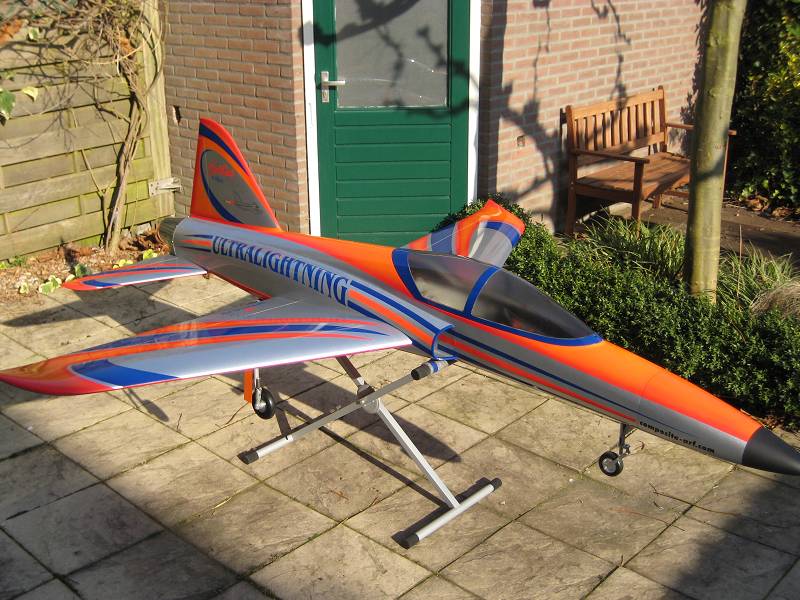

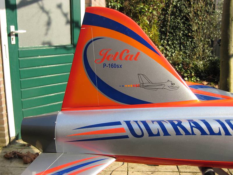

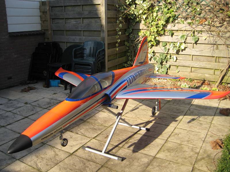

Yeahhhh!!! My UL is finally ready!!
Hopefully I will maiden this bird next week.
Final weight is 31.8 lbs with a full UAT and 5,3 oz lead in the nose. Hopefully its not to heavy.
I use a Jetcat titanium thrust tube but still needed the lead to get the recommended C.G. (15mm behind the front edge of the geardoor).
Strange as they advertise no lead is needed.
Anyway, will be blast to fly!!
