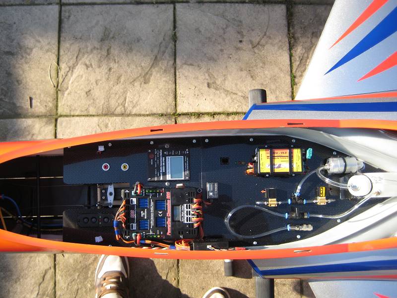

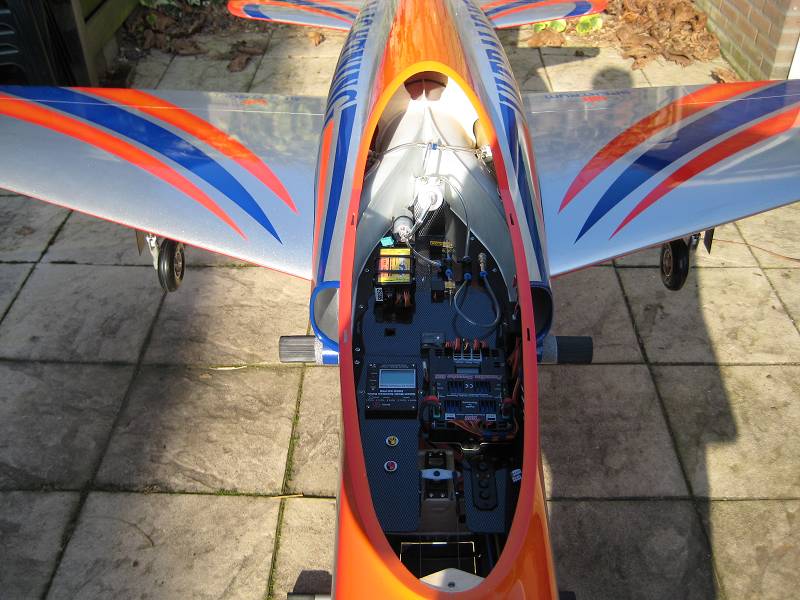

Very very nice Didier,
Is this real carbon you used to mount the Royal and the pump or just sticker?
I think also it would be wise if you installed a ball valve after or before the pump. There is a thread going on here (http://www.rcuniverse.com/forum/m_86...tm.htm#8607640) about the possible postitions of valves and how important they are.
Please keep us updated with your maiden flight.
Tassos
Tassos
#78
Hey Tassos.
The carbon look-a-like plate is actually a plastic plate with a carbon print on it.
Sandor of Digitech sells this stuff.
The "fueling" line to the UAT is 4mm, from there the fuel line to the main tanks is 6mm.
Together with a low voltage operating "fueling" pump the "fueling" pressure will be almost zero.
Even if the fuel valves of the Jetcat leaks, I can't image the fuel go's through the not operating pump.
Ofcourse it never hurts to install a ball valve after the pump.
Will let you know about the maiden! [8D]

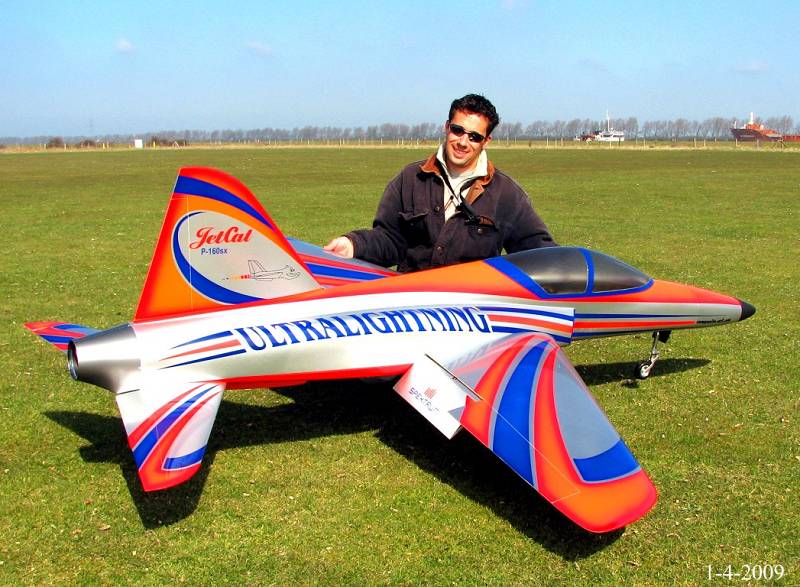

Finally the Ultra Lightning maiden last week.
WOW, what a great airplane is this.
So smooth, very very precise and very very very neutal in all 3 axis.
First I had some lead in the nose but found it a little to nose heavy.
The CG is further behind the recommended C.G. composite-arf gave.
This results in almost no mixers for knife edge needed. (4% down elevator, 0% ailerons)
It makes also the landings easier to to perform.
With a dry weight of 31,5 lbs, it can fly so slow and still very controllable.
The performance of the JETCAT P160SX (126 K-rpm) together with the JETCAT titanium thrust tube is very good.
I must say I'm very happy with the airplane.
Hope to get some video soon.
