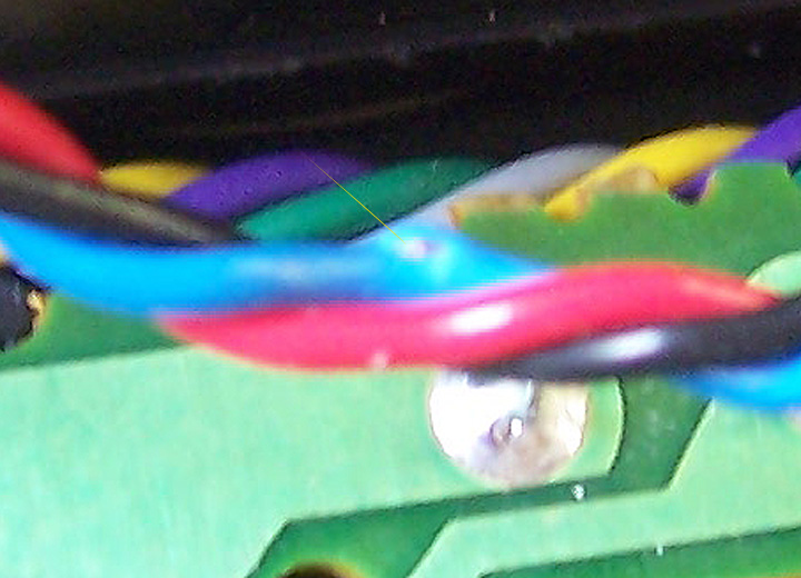

This may be old news, but I found out about the problem on another group.
The I.C. on the 2.4 P.C. board rubs on the wires from the aileron potentiometer.
I used heat shrink tubing to protect the wires.
Bob

Horizon has a service bulletin out about this and how to fix it. Here's the link:
http://www.jrradios.com/Articles/Art...ArticleID=1822
Bob

Limeybob,
How did you get a piece of heatshrink around the wiring without un-soldering one end?

Same here. I wondered that myself.

ORIGINAL: SGibson
Limeybob,
I split the heatshrink, then secured one end with a piece of thread (Half-hitch) to keep it in place.
Regards
bob
