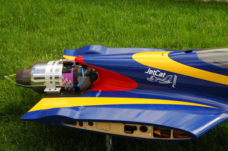

I have made my own FOD screen for my Titan on my F22 and p80's on other airframes. The Bobcat with P70 on it is a very tight space, so will the Jetcat screen be the best choice? Without haveing to cut on the fuselage.

Jed
Installed my P120SE with the new JC FOD screen. It fits fine!
Regards Thomas

Old 08-25-2008 | 09:45 AM
FL510's Avatar
My Feedback: (8)
Posts: 516
From: Helena, AL
Default RE: FOD screen on a Bobcat
Sweet, Thanks for the pic!
