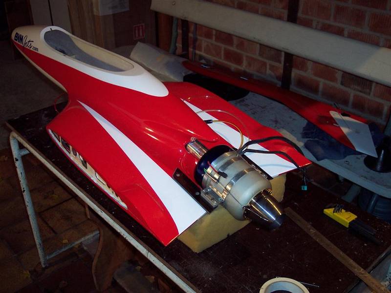

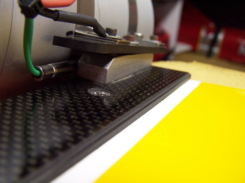

I've built Bobcat with a 28 lbs thrust turbine (Digitech Ulysses).
I had to make a hole in the fuselage for the starter engine. No problems at all. Just dremel it

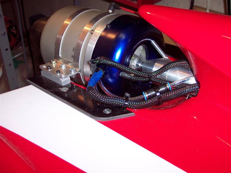

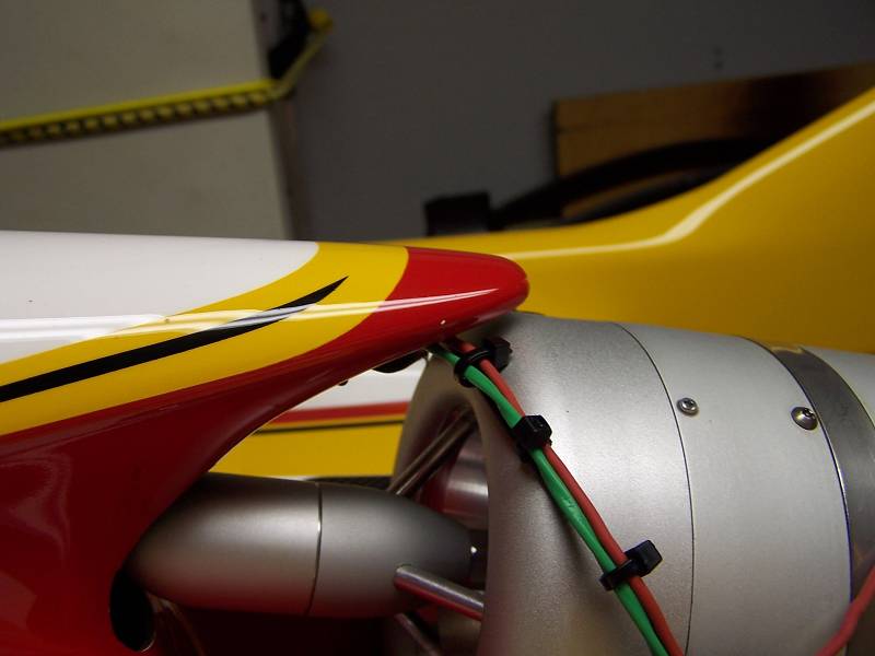

We have a Super Eagle mounted on our Bobcat Arf. We shaped the bottom mounting blocks (BVM) to help tuck the motor in place. I think we have (3) 4-40 washers under the mount to get the correct trim. We routed the hoses to the side and then up through the center of the fairing. We used the glow wires to help hold the fuel lines in place.
We also changed out the center hopper tank for a 30 oz tank for extra capacity. The tank is made by Jet Tech, if you get one, order one with the O-ring fitting (like BVM).
We did turn our Super Eagle down to 24 lbs, which flies the plane just perfect, (right at 200...)
Hope this helps!
Larry & Vern
