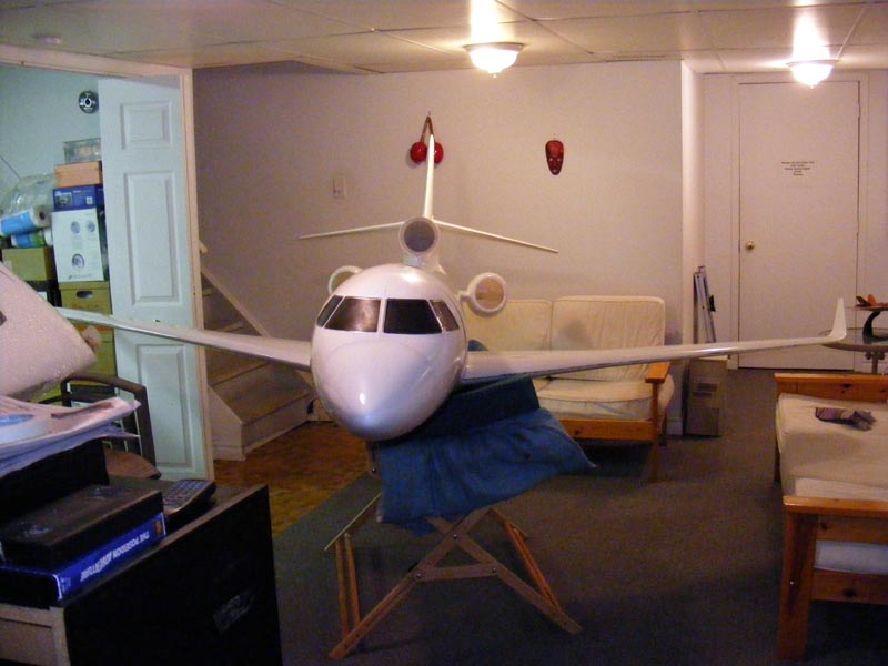

Winter project started early this year.
After finishing the A321, I wanted to start another airliner project and was planning to build the B727-200. I then decided to go a bit bigger and picked the Falcon 7X. When the 78”x39”x26” box arrived, I got scared and started having second thoughts about my decision. After working on it for the past 2 weeks, I am convinced this is a great project.
This is not an ARF; it is a builder’s kit and does require a lot of attention to building details and strength. The good thing is that it is big and there is lots of room to work in.
I have just finished with the manual corrections and it can be found at:
www.altecare.com/falcon7xmanual.pdf
Here are the specs:
FALCON 7X Business Jet for a single 35 ~ 42 lbs thrust turbine
Scale: 1/7
Span: 150" - 3.80m
Length: 138" - 3.50m
Weight: 27 Kg - 59lbs
Turbine: Behotec 180 Kero start
Radio: Futaba 14MZ running a twin receivers (2.4GHz or 72Mhz under review due to the amount of carbon fiber lining in the kit).
Servos: JR8411 throughout.
Gyro: Dual gyro on rudder and ailerons
Power regulator and distribution system to be determined.
I will not be using flaps since the wings are so large, the plane lands slow like a glider. Besides, tests have shown that there is no impact on lift or drag between flaps retracted or deployed. This will save a couple of servos and some weight.
For now, I am not planning an interior to keep the weight down. After the test flight, I will work on the paint scheme. After that, I can worry about the interior.
All the moving surfaces have to be cut and hinged. So far elevators and ailerons are cut, ailerons have been hinged and the main retracts installed.
The good thing is that the fuselage can be transported in 2 pieces as well as the wings, which makes the plane transportable.
Here are some pictures. Will post more as I go along.

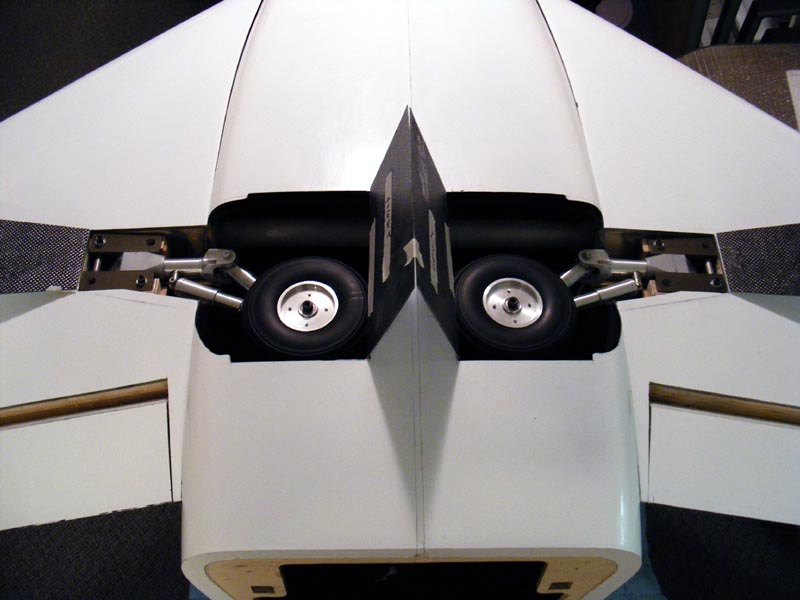

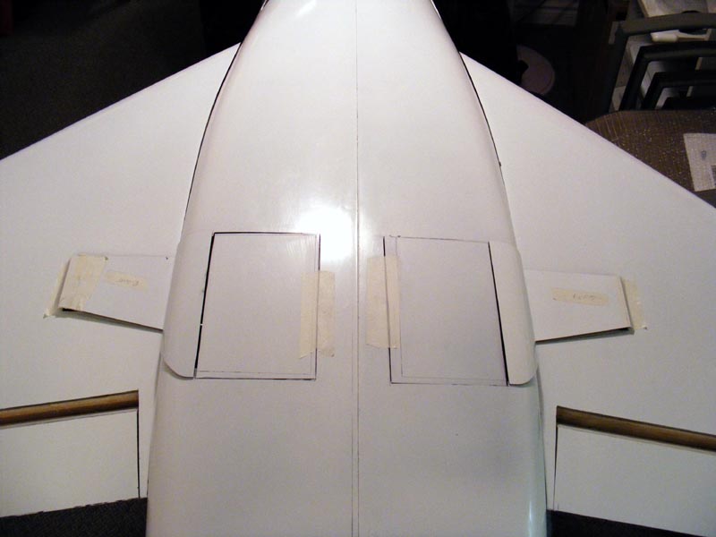

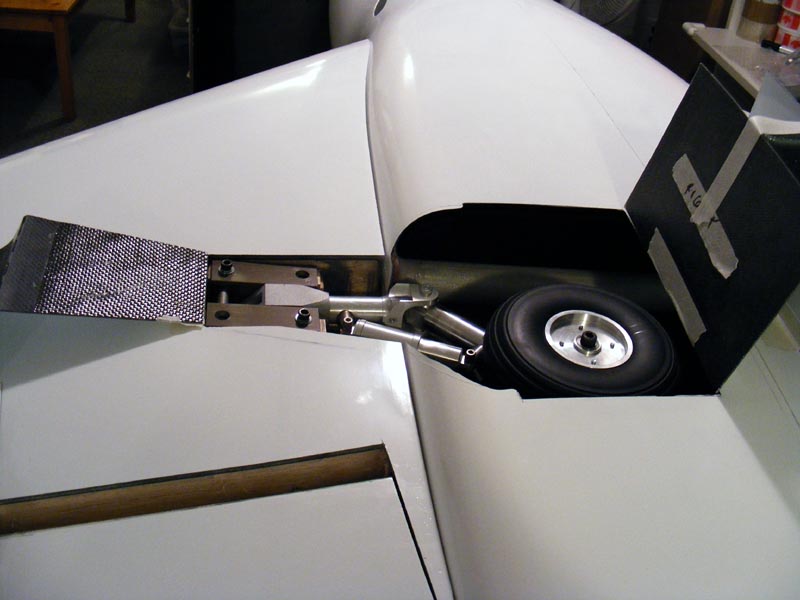

Progress is slow but at least moving along at a steady pace.
Trial fitting everything before beginning to secure doors, retracts etc.
Not much room to move around once assembled, but lots of room to work inside.
Engine ordered, control electronics and batteries ready to fit inside fuse.

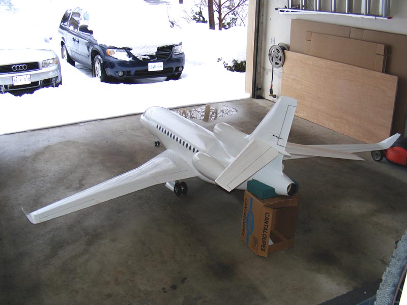

Nacelles installed and glued, decided to finish the stabs today, although it was cold, the garage was heated but there is no way I can do this step inside. All servos done. Now I move onto the internal work, door cylinder installation, all retract/door tube plumbing, RX, fuel tank & lines as well as engine installation.

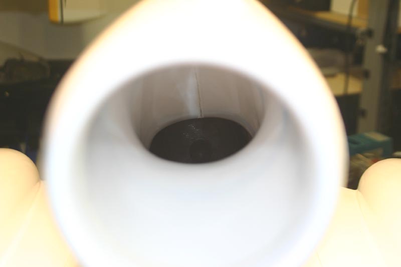

A small update.
Engine installed.
Also did an access hatch to connect the GSU when needed and control the shutoff valve since once the 2 fuse halves are attached together, it will be difficult to access.

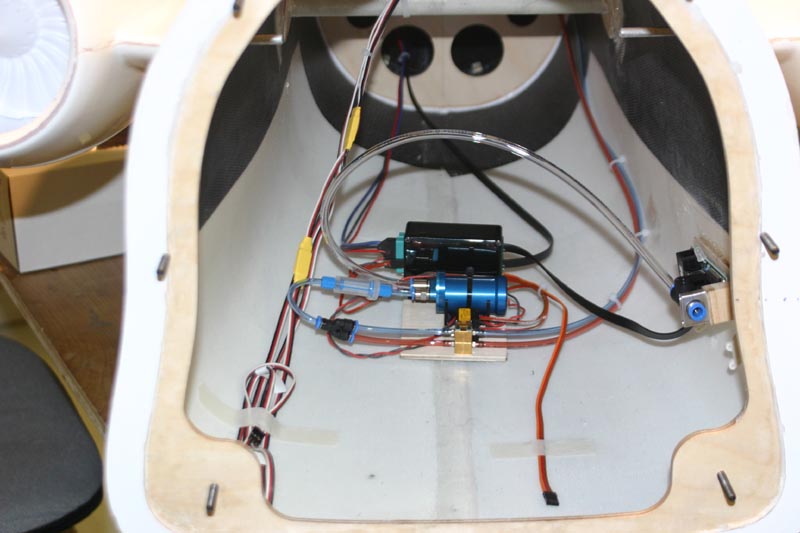

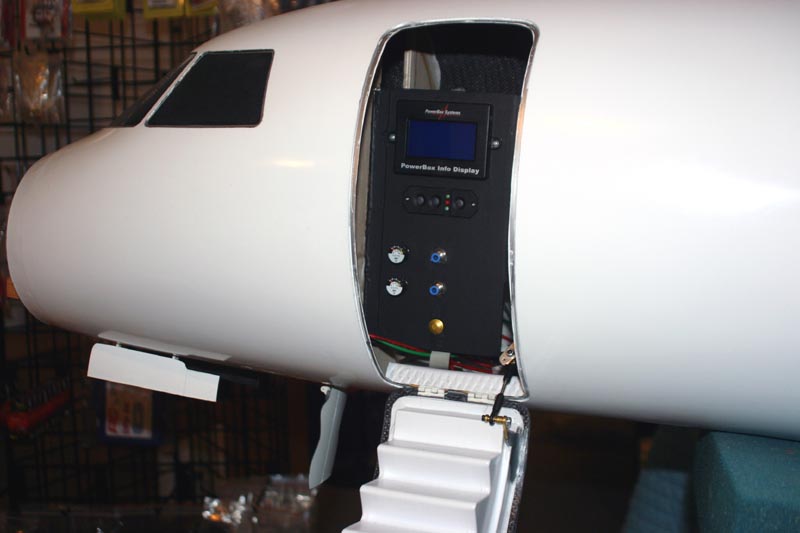

Here is a small update.
Retracts, doors, air cylinders, air systems and electronics finished. Will be using the 6 tube quick connect for the wings since there are 4 tubes per wing (2x brakes, retract air up and air down) and this will make life much easier at the field.
RX tray is ready, it needs 1 screw and it can be taken out of the plane. Power Box On/Off, Electronics control, air control as well as air & fuel fill also finished and will be accessible through the main cabin door. It also gets removed with 1 screw for easy access.
The next step takes the longest to organize all the wiring and tubing

a small update.
doors all finished (all 7) and sequenced.
retracts finished.
all throws set.
fuel system needs to be installed as well as some final clean-up then CG (most difficult due to size)...
here is a short video of the door sequence:
http://www.youtube.com/watch?v=l7lzEaf3Gjc
Target test flight is March 09
No painting this season...just some light sanding and prep work for now.

Almost there, nose buttoned up, final tank installation and CG and then the big day.
It was a lot of work but well worth it. Much more work to prep and paint but that comes after the test flight.
