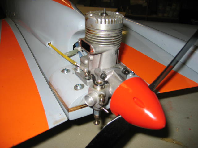

Old 09-12-2008 | 11:13 AM
jroth's Avatar
My Feedback: (60)
Posts: 350
From: Tinley Park, IL
Default RE: reversing an engine
Hi,
This is the modification I made to run a standard prop on my OS .61FSR engine, it works!
John
