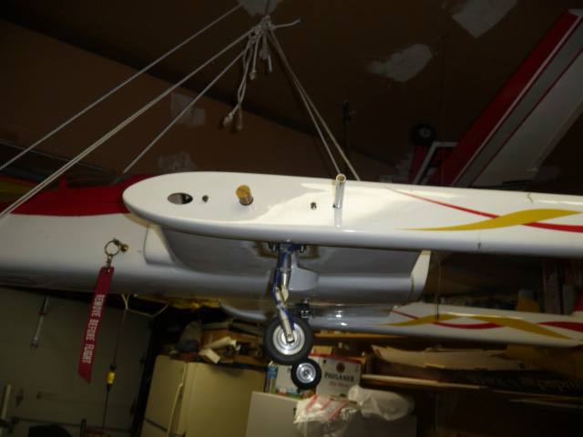

Floor space is at a premium in the garage, and would like to hang the jets with the wings on from a high ceiling well above cars etc.
Has anyone done this. if so could you let me know how you did it please.
Any thoughts appreciated.

I just used an Eye bolt screwed into a ceiling joist, and some rope rigged in two loops and a hook on the other end that snaps into another eye bolt in the wall, simple set-up.
When you want to let it down disconnect the hook from the eye bolt in the wall and lower.

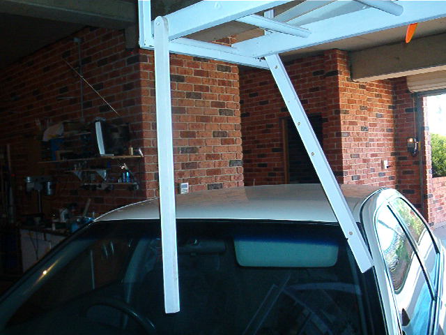

I'm an electrician & when the ex boss changed from wood to fibreglass ladders they were all going to the dump.
I made this stand from one, one end is hung & hinged from the ceiling, the other end hangs on a trapese. To gain access one end drops down, a couple of simple legs fold to keep that end a couple of feet of the floor.
You could make something similar fro 4 x 2's if you had no ladder. - John.
