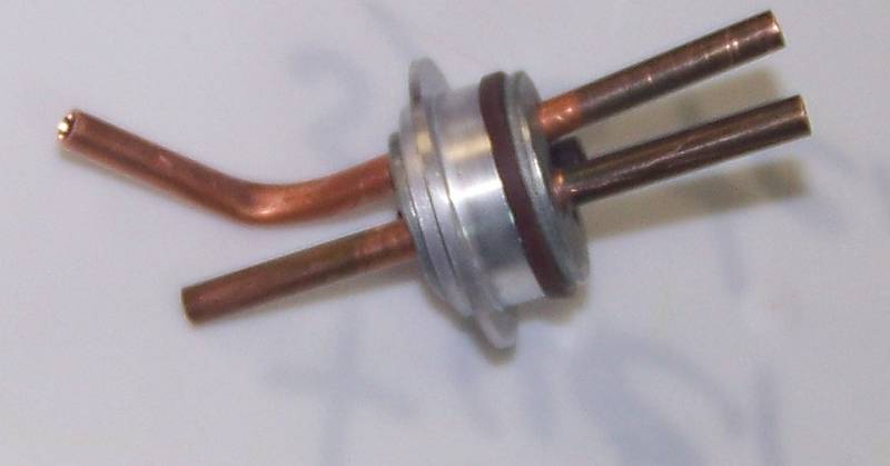

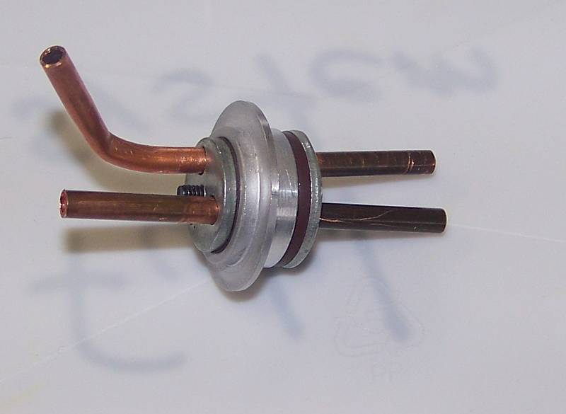

so do you just insert the brown plug into that new piece? What holds it in place
Old 12-03-2008 | 07:08 PM
  #27
RCISFUN's Avatar
My Feedback: (44)
Posts: 6,931
Received 34 Likes on 30 Posts
From: Erie, PA
Default RE: fuel tank fitting
Look at post #17, according to Bob they are hysol'ed into place[X(]
And yes the rubber stopper is inserted into the Aluminum part.

ORIGINAL: RCISFUN
I got that part. So the brown stopper will just squeeze into the inner hole and just stay there despite any tank pressure?
I know with the dubro versions you have the screw and plates to squeeze the stopper so that it exands on the hole.
Put me on your list......I'd need 3 for my JL F-16 tanks
Same thing here you have to have the screw and backer plate to squeeze the rubber stopper.

ORIGINAL: RCISFUN
Now it all makes sense.
Yep, its basically an aluminum DuBro tank neck that you Hysol into the fiberglass tank. As far as the Hysol part is concerned, all BVM tanks use Hysol'ed (brass) neck fittings and all Composite ARF tanks use Hysol'ed (aluminum) ones as well. I have not yet seen a problem with the glueing part of the system.

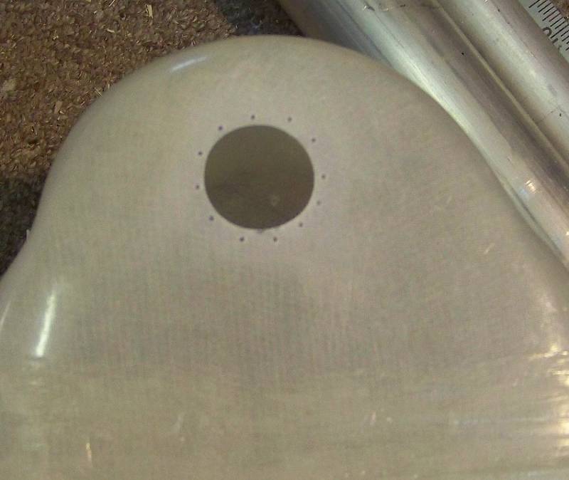

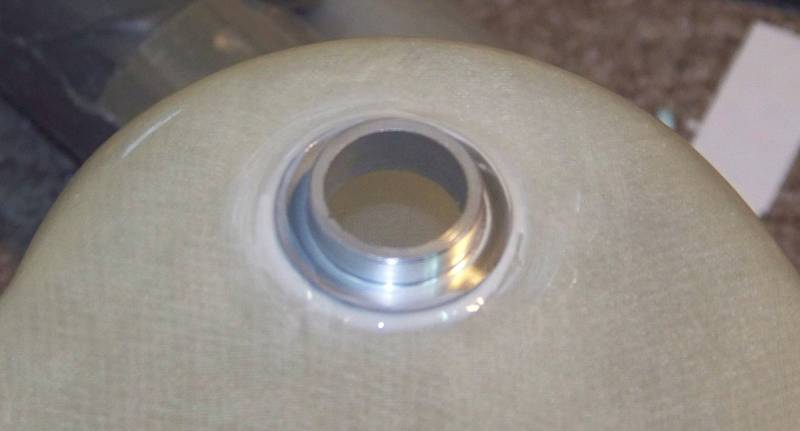

Guys,
Here's the pictures of the tank fittings installed. They are *perfect* and *MUCH* better than installing the rubber stopper on the tank itself...

Great job Bob,
I just got a message from Rich, mine are on their way. I like what you did with the little holes around the tank hole. I guess it will work like a rivet. I don't use Hysol , I wonder how well J-B Weld will work ? I can always drop the tanks off at my flying buddies house and have him Hysol them on for me.

Jef,
I think that Goop might work, you can buy at Walmart or any hardware store, I used it to repair a hole in my Du-Bro tank and it worked great and Jet A didn't attack it.
Bob,
your tanks look great!!! I too like the holes around the permiter...great idea!
