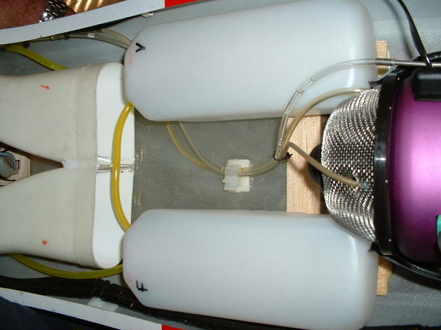

Old 01-02-2009 | 10:49 AM
AFTERBURNER1's Avatar
My Feedback: (80)
Joined: Jun 2003
Posts: 4,434
From: Anaheim Hills, CA
Default RE: Comp Arf Flash. Help.
I Use this configuration in my Flash with a JetCat Titan SE... Works great!! Hill Climbing at its best. Hope this helps.
