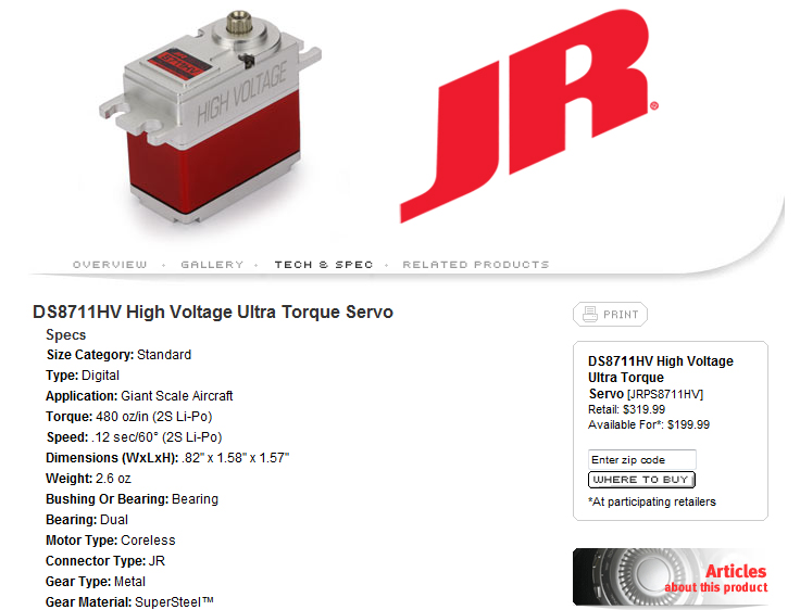

Is anyone using them yet? If they got them down to $89 it might be worth it. Its cool to be able to hook these directly up to high volt lipos though.

The new 8711 servos will not be available until mid Feb. Don't hold your breath for them to be $89.00. Joe C!!

Not a chance at $89.99. I would say something more like $149.99 will be rock bottom, but we'll see.

Ian, they $200 a servo

I think there will be a great demand for these servos, I am sure they will be designed to work with any chemistry of a Li cell (3.3 to 3.7 nominal, maybe over 4.2 off charge).
The issue is what about the other servos and devices? This will just add more complexity, as it you really want the 480 ounce inches you will want the full battery rail. So what, 2 rails?
I think ACT has been selling 7.2 volts servos for awhile, there is a market for them I think

There are a few solutions to power these servos with older type ones. One is for the mfg's to upgrade some of their power boxes to have HV going to the main channels while lower voltage going to other servo channels. Or using seperate regulators to regulate the power going to the older servos and leave raw voltage going to the HV servos.
I think that these HV servos are a great idea and they do have a market out there. I also think that the radio companies have missed a great oppertunity to change the sevo plugs to a higher current carrying ones (to achieve the most/best efficient use of the power available)[>:]
