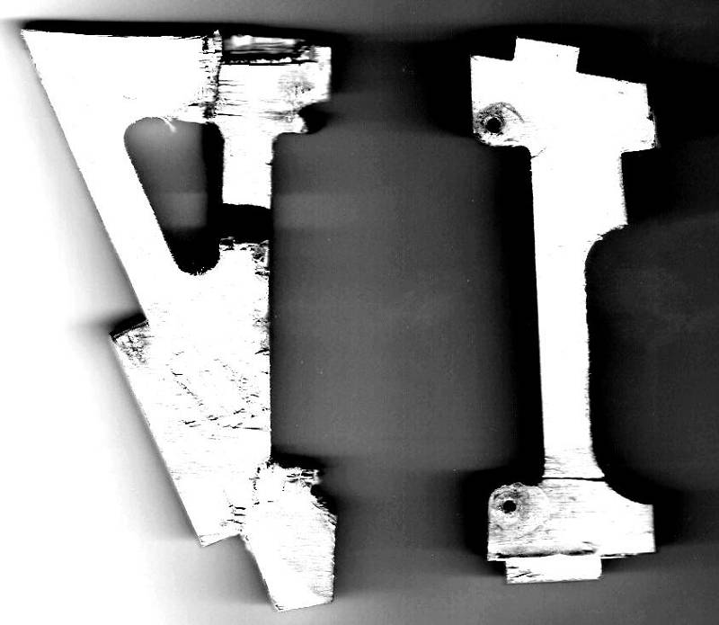

Actually I do have a band saw with guides, but it is difficult to use with small parts.
I'm cutting these (BVM BARF MLG Frames):
1. CATIA V5 DWG of scanned parts
2. Scan Photo of broken parts

oh yeah, you would need a scroll saw for that.
Dude, send me the file to your drawin and i'll have a buddy of mine cut it on his CNC router. It would take about 30 minutes per part to do.
What material are you going to use. He's got bits to cut anything except carbon fiber.
