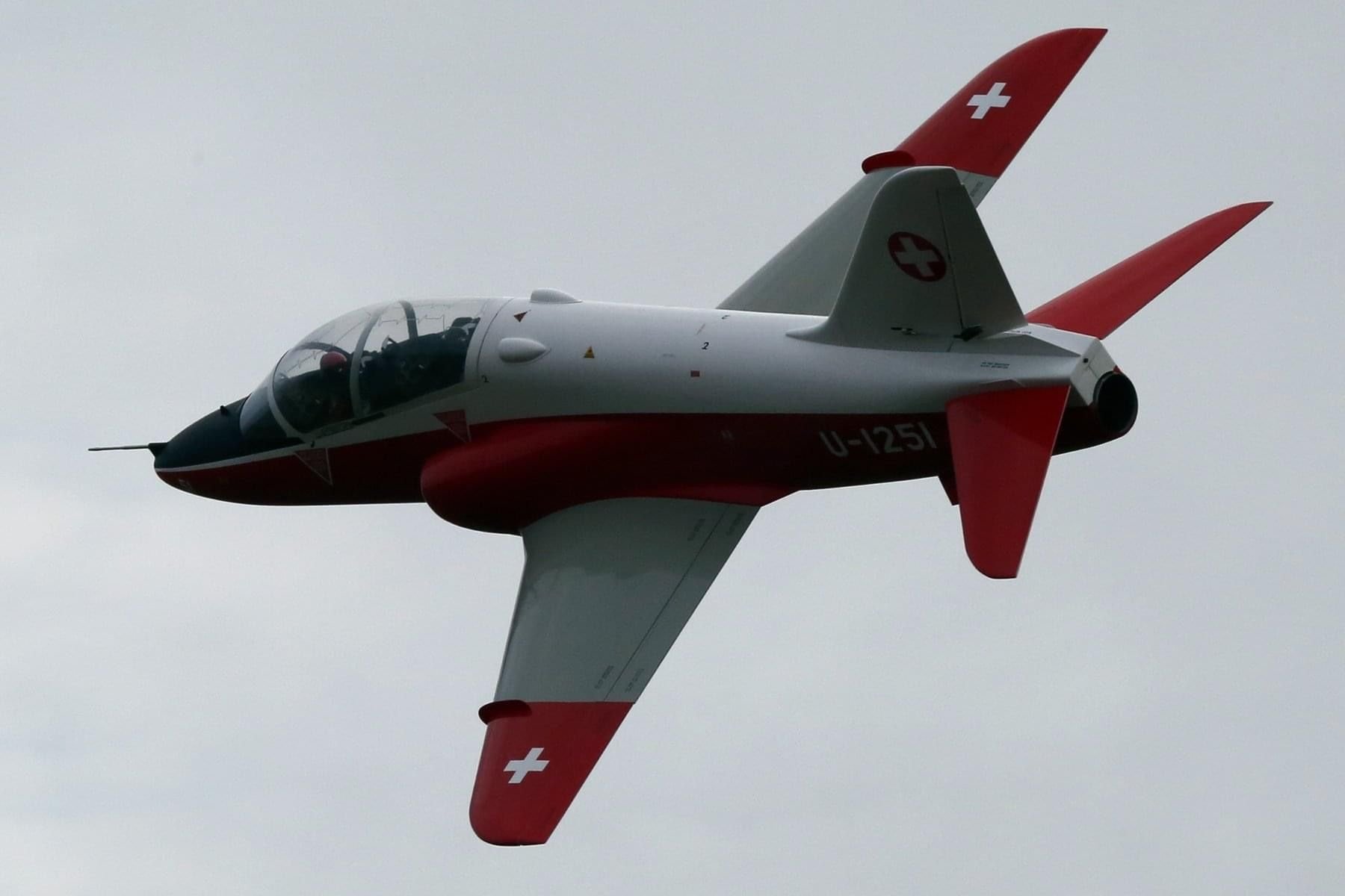

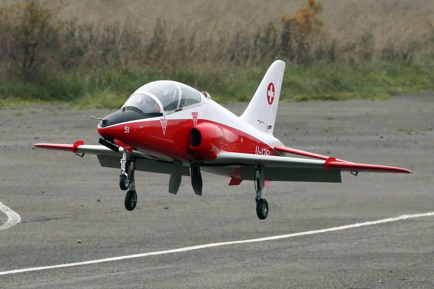

The Airworld 1.4.5 Hawk is emphatically NOT a wing dropping machine.In fact it is thoroughly docile and predictable jet. An absolute pleasure to fly. I have been flying my TWO. for almost 14 years with Jetcat 180s since Meiringen.and they are serviceable waiting for spring !
That said, B Ae via Duncan Simpson, sent me drawings which showed the exact locations and angles of the wing dressings, which I have replicated.
Heres one, flown at three JWMs at 19.9 kg.

DG nice picture! And FWIW shows the perfect deck angle for landing the Hawk, just hold that until it settles, beautiful.

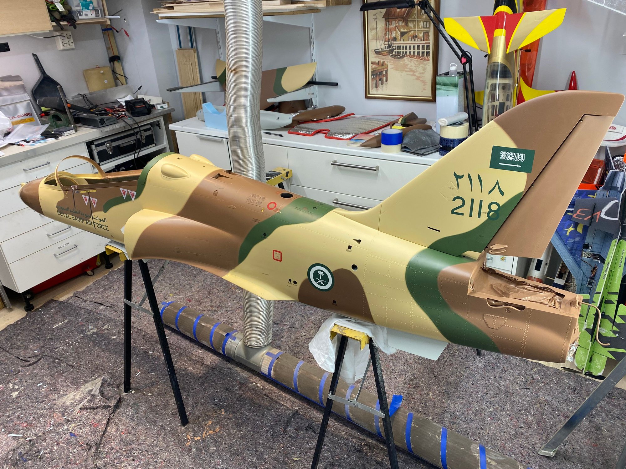

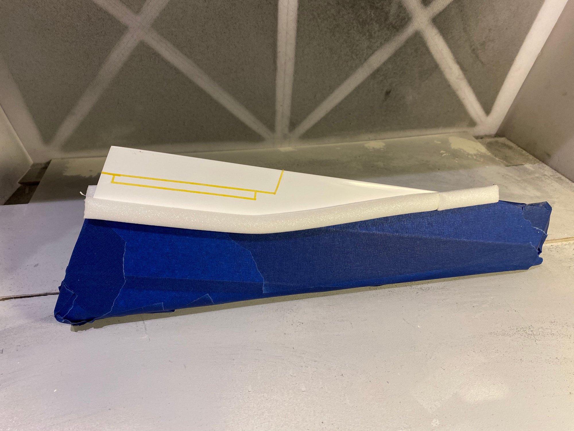

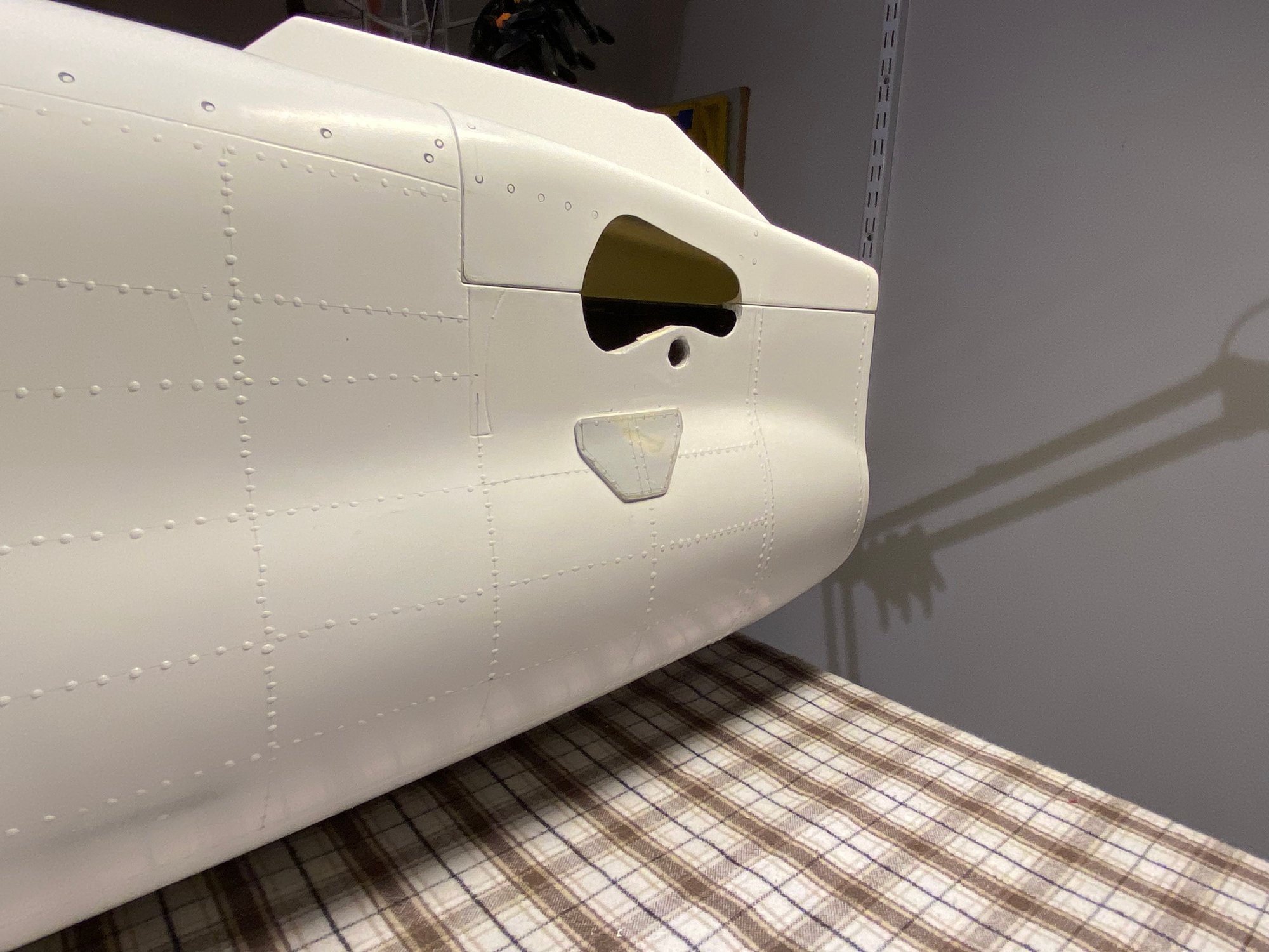

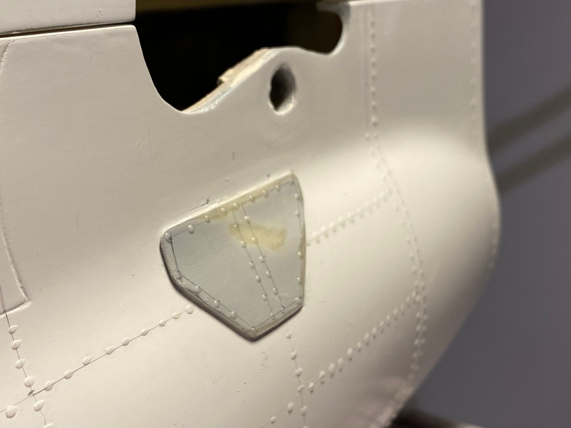

Default Progress
Done some more work today. Slow progres, but at least it is not going backwards…

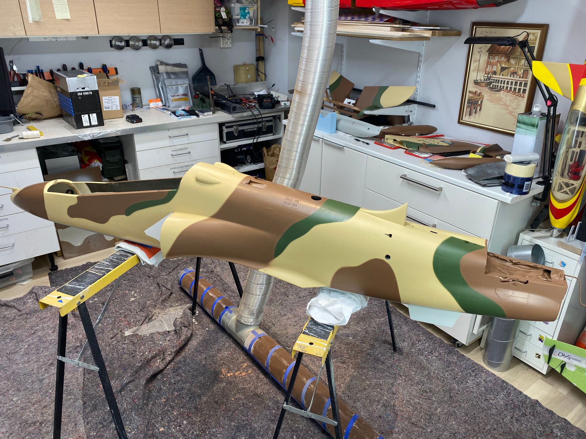

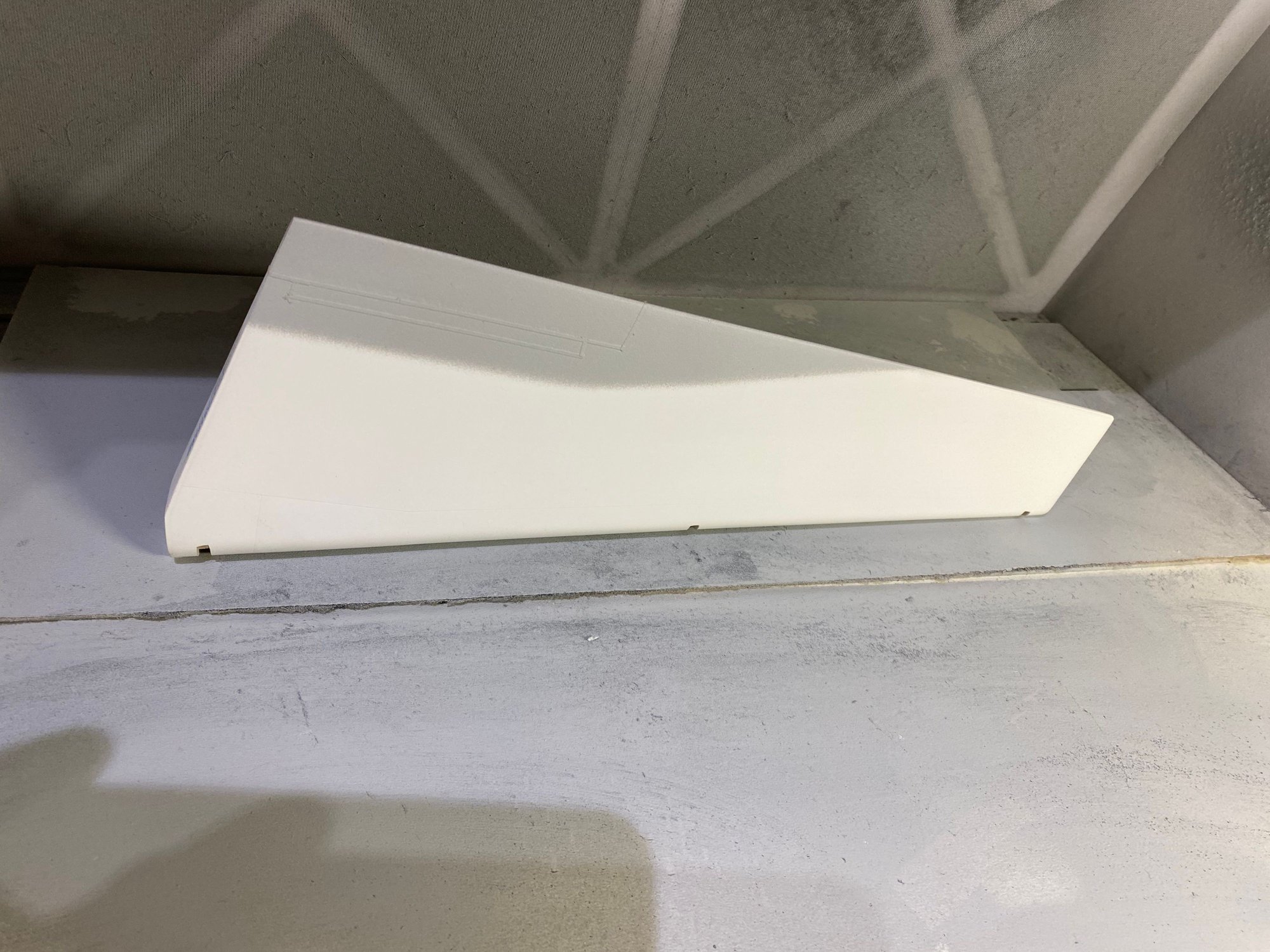

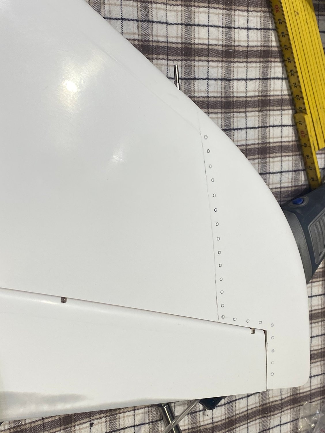

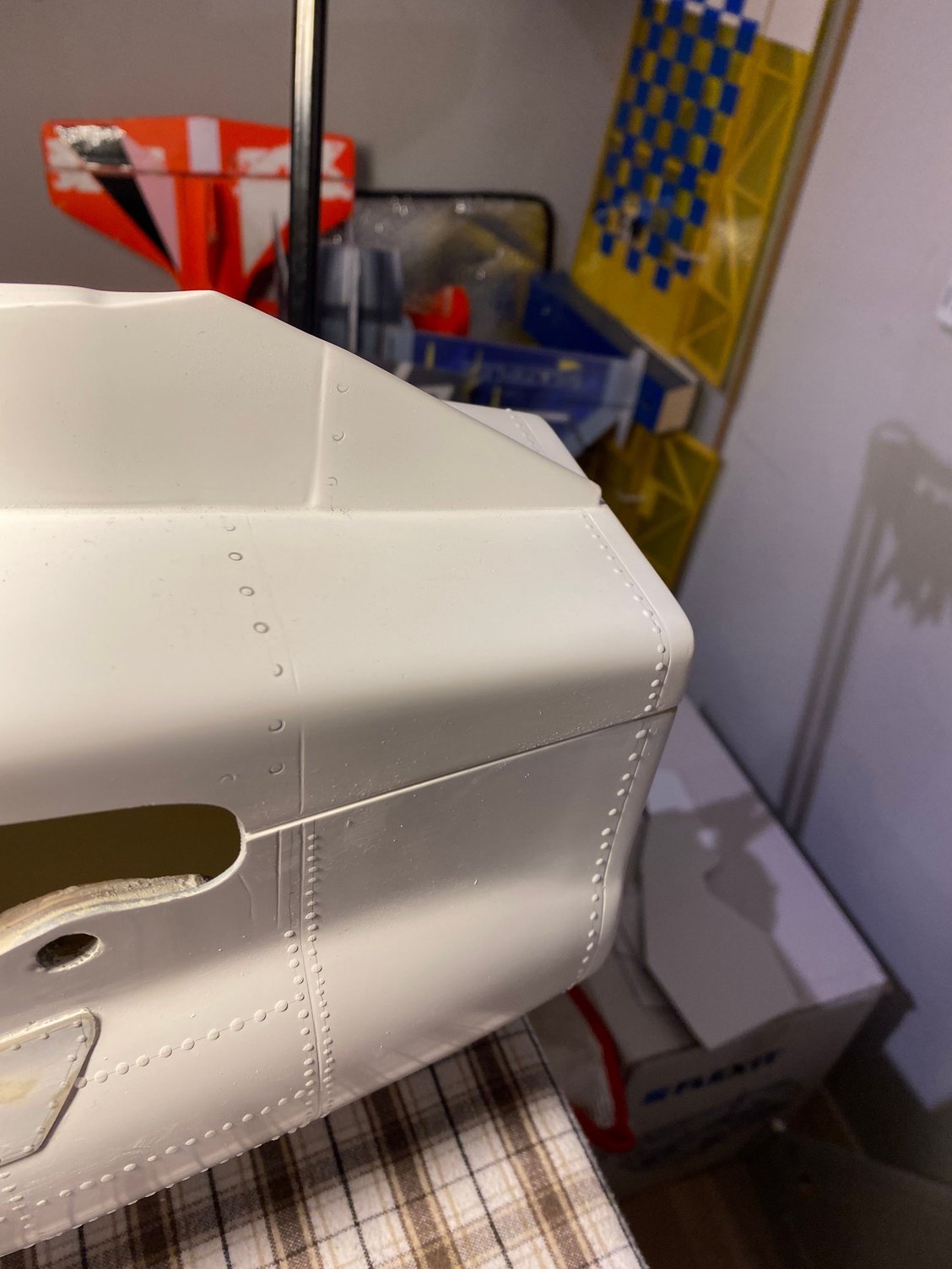

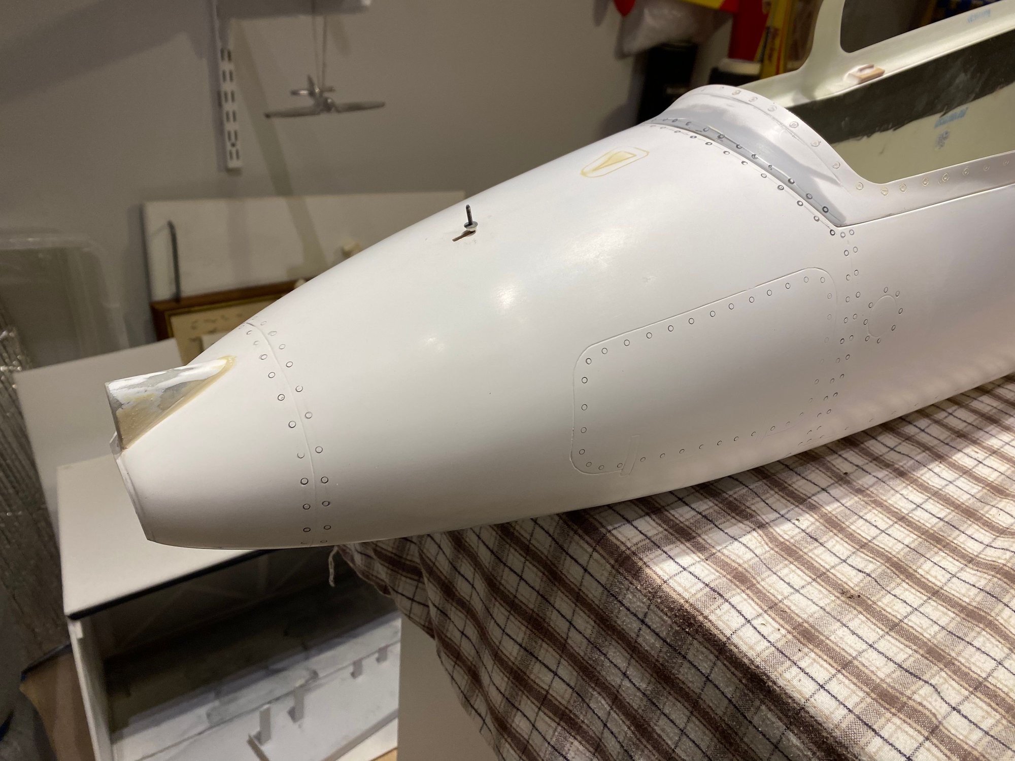

Default Getting there
Soon ready for painting. One of the last of her kind…

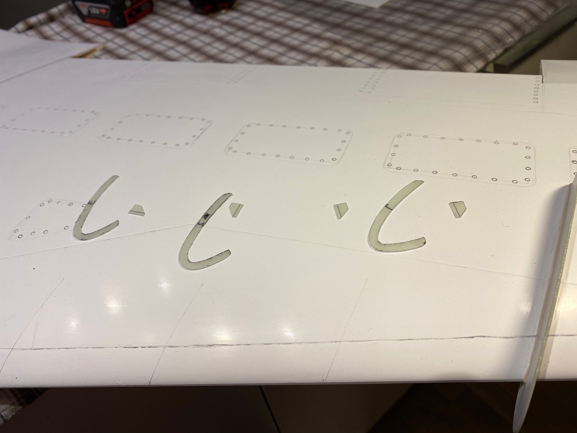

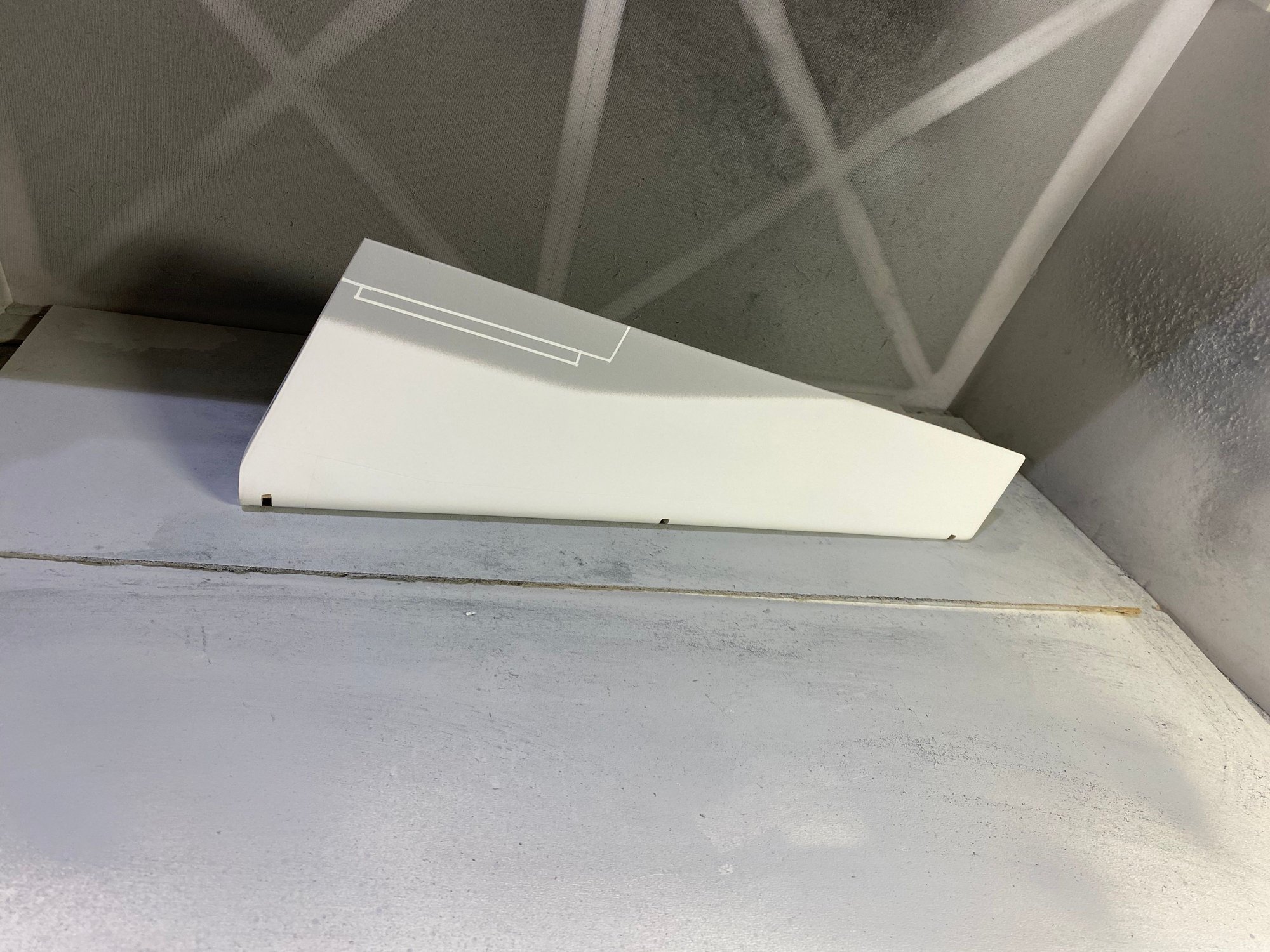

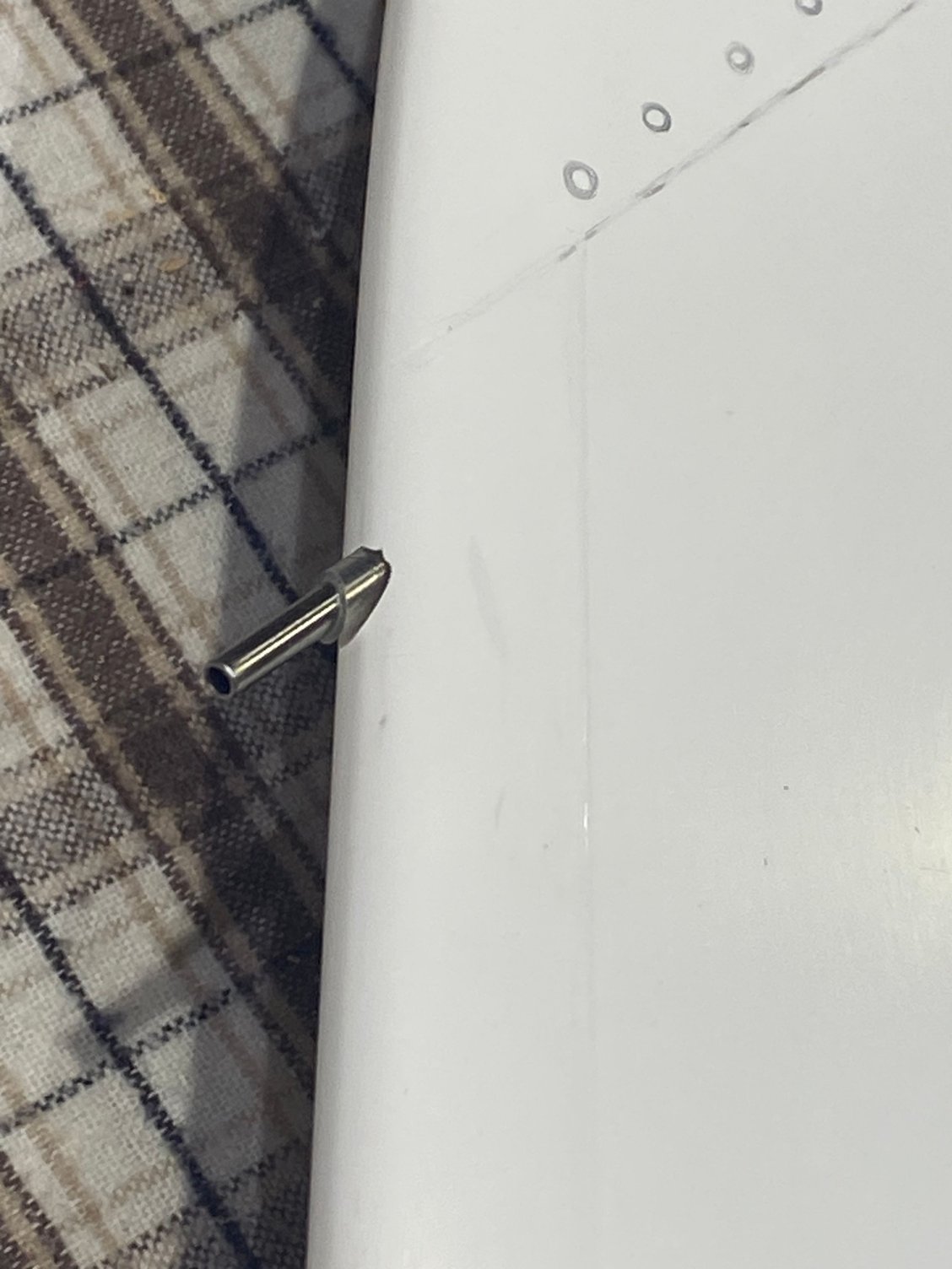

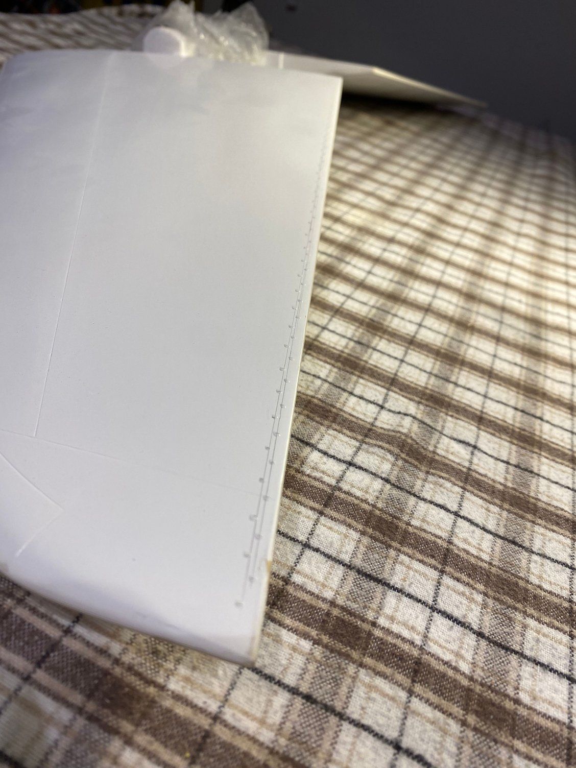

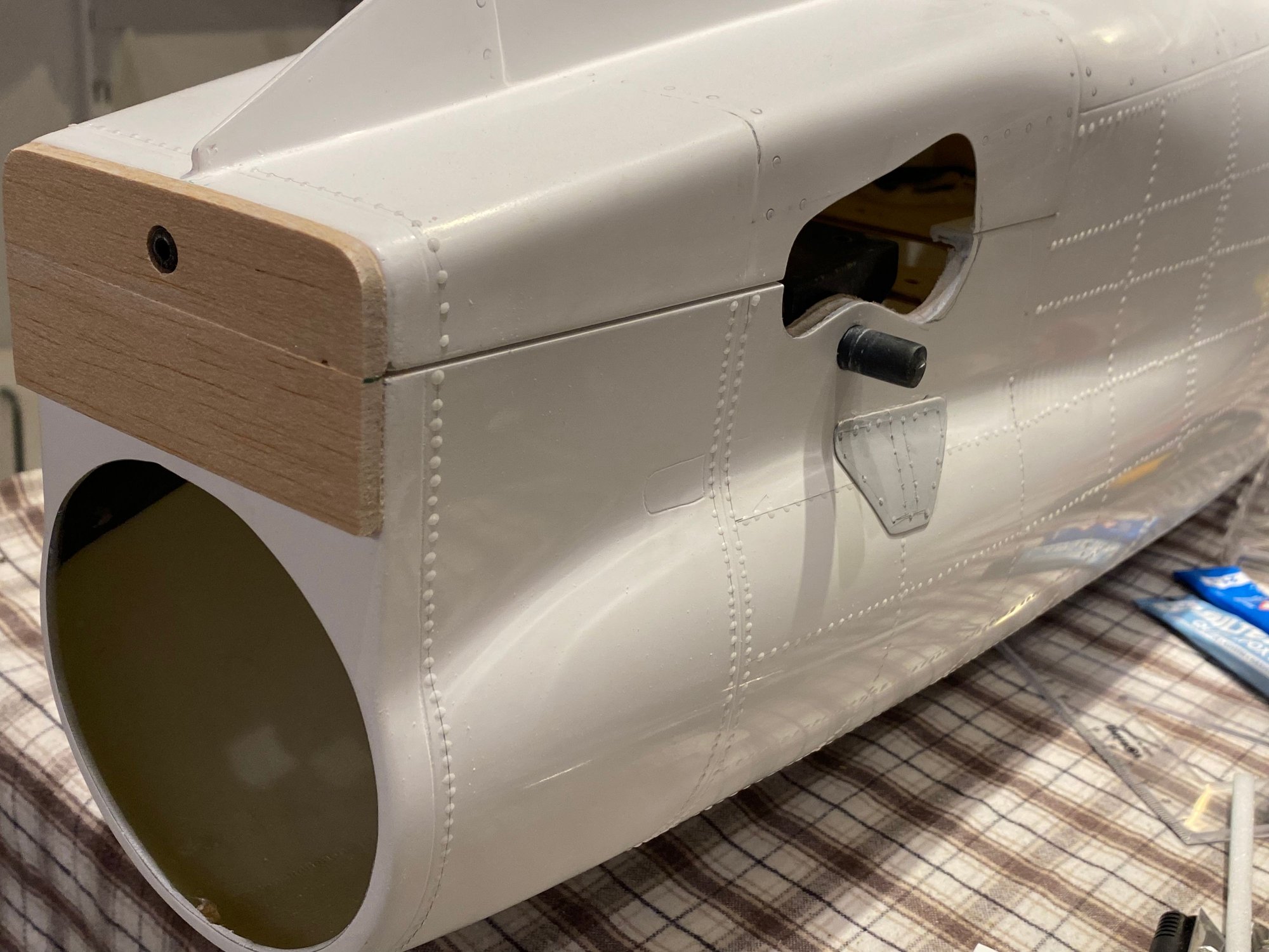

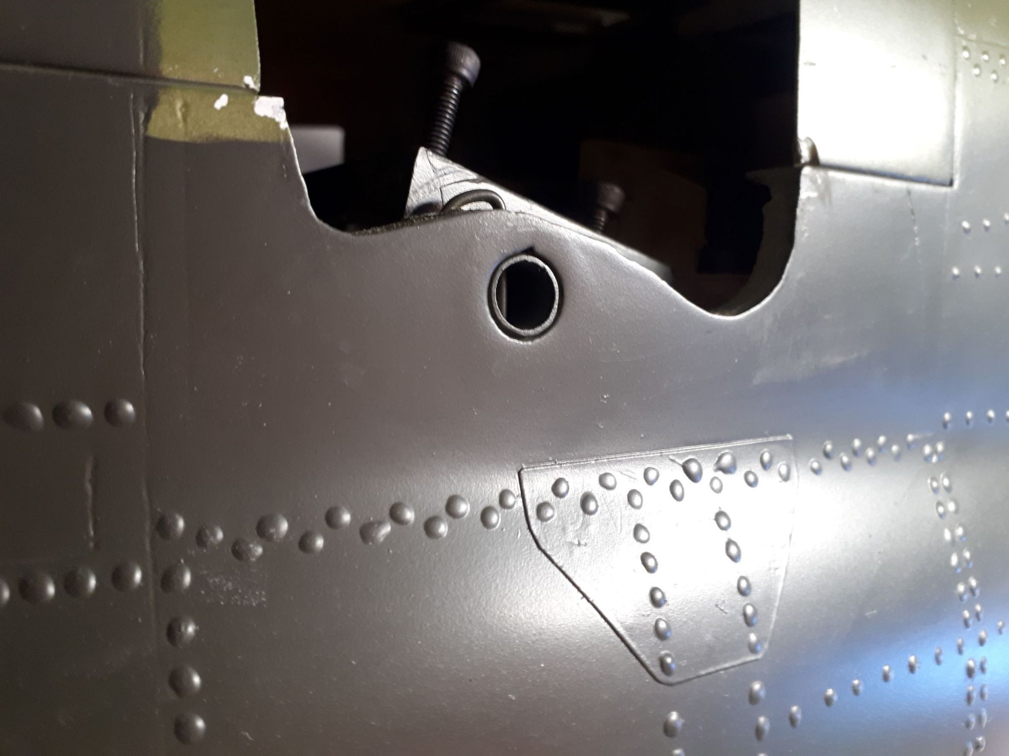

Default Some more work..
Installed pitot tube in the vertical fin. The Futaba TAS01 reads wrong speed if installed in the fuselage where turbine creates vacuum.
Added vortex generators and fences on main wing.
Perfect building weather conditions in Norway nowadays…

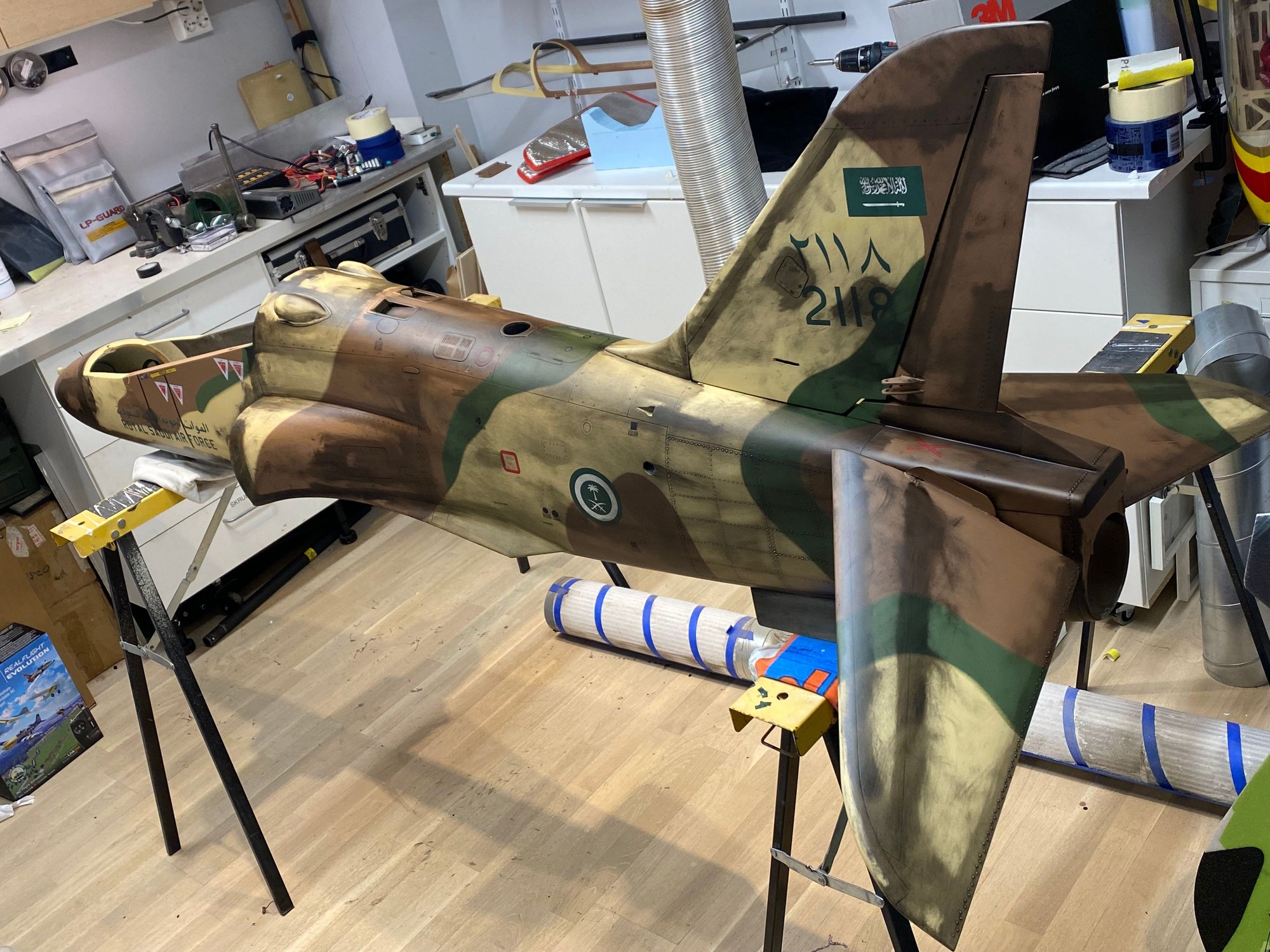

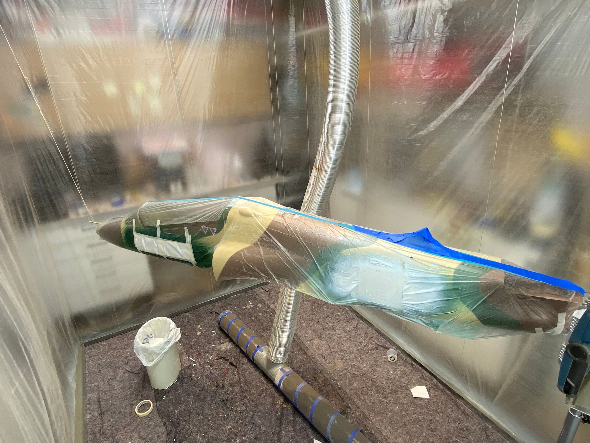

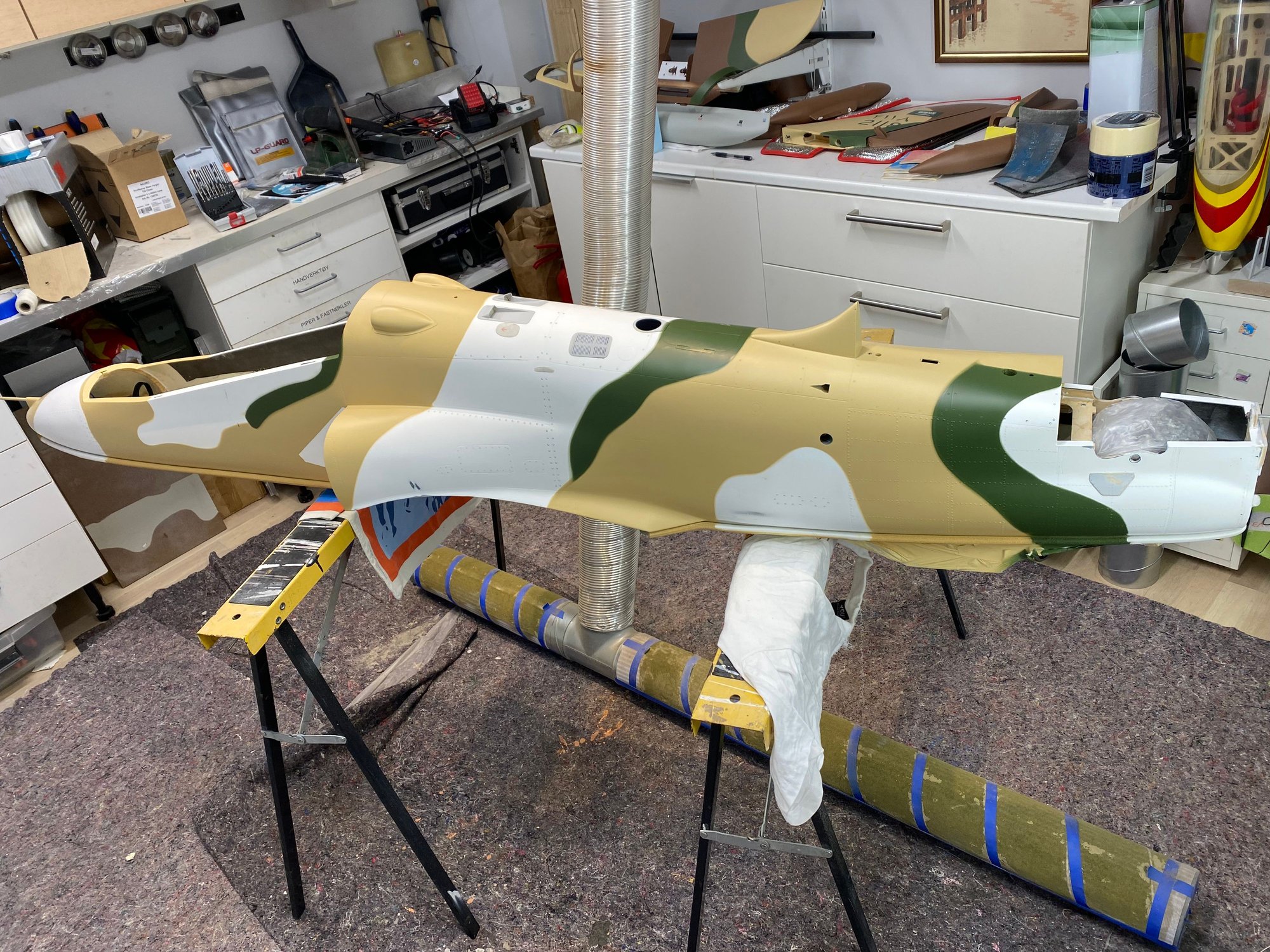

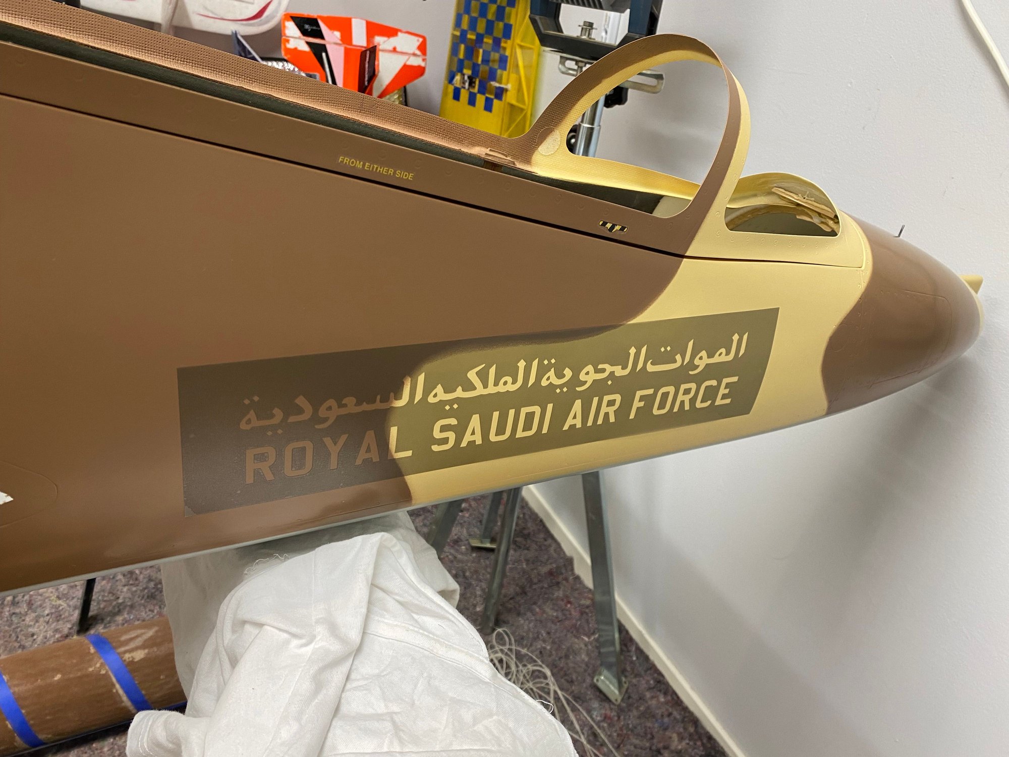

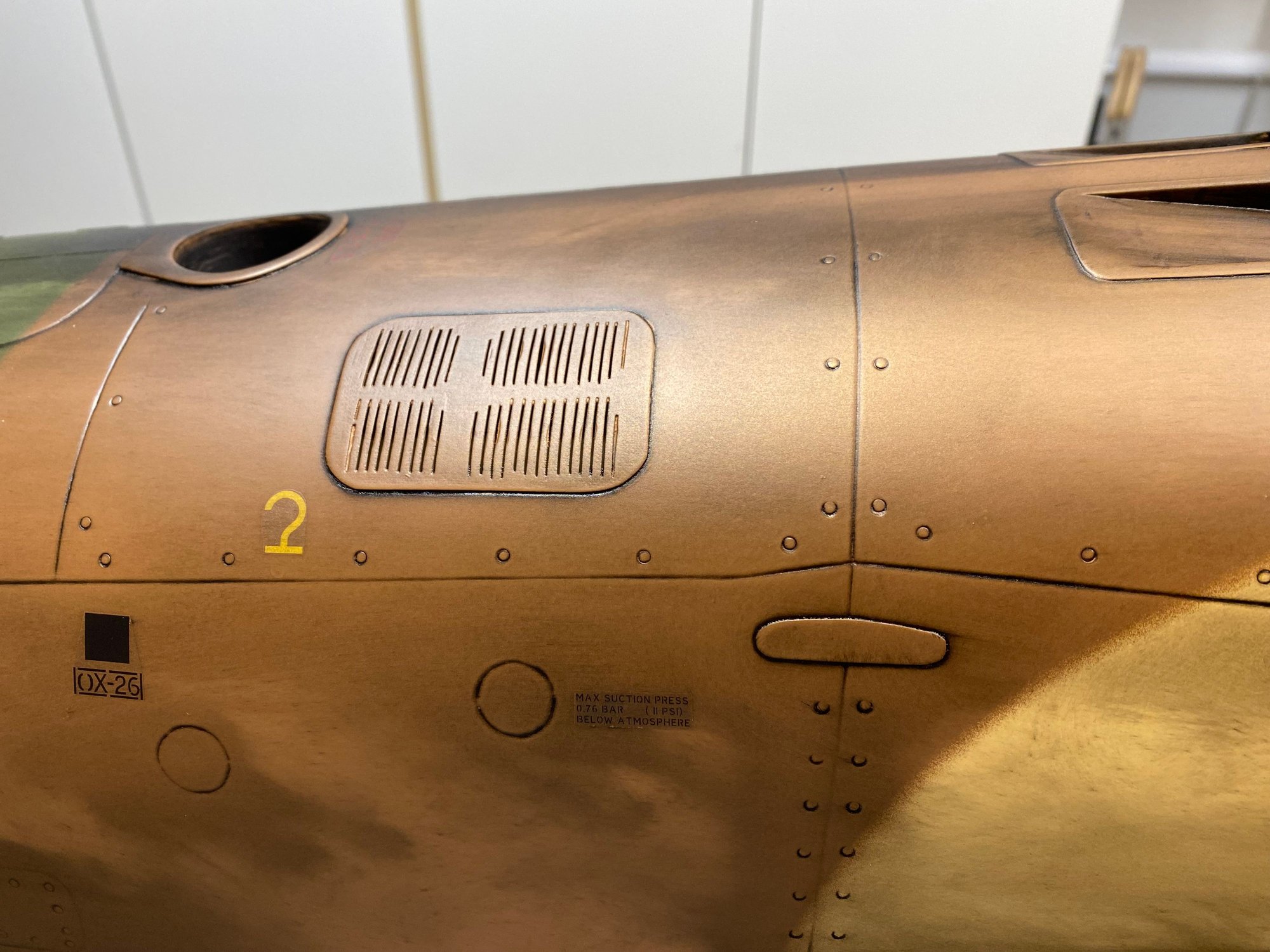

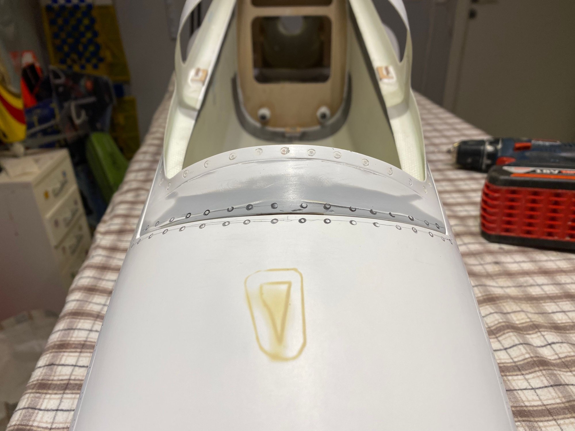

Default Working on my paint and weathering
