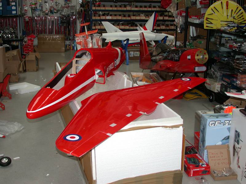

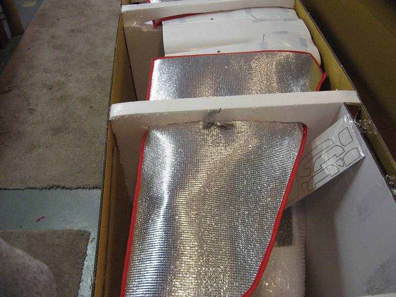

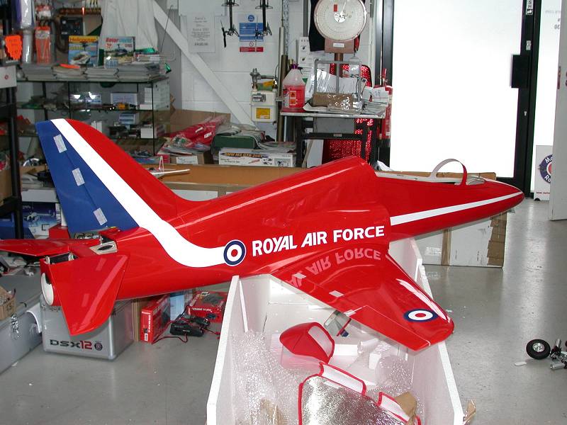

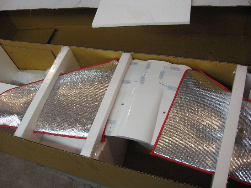

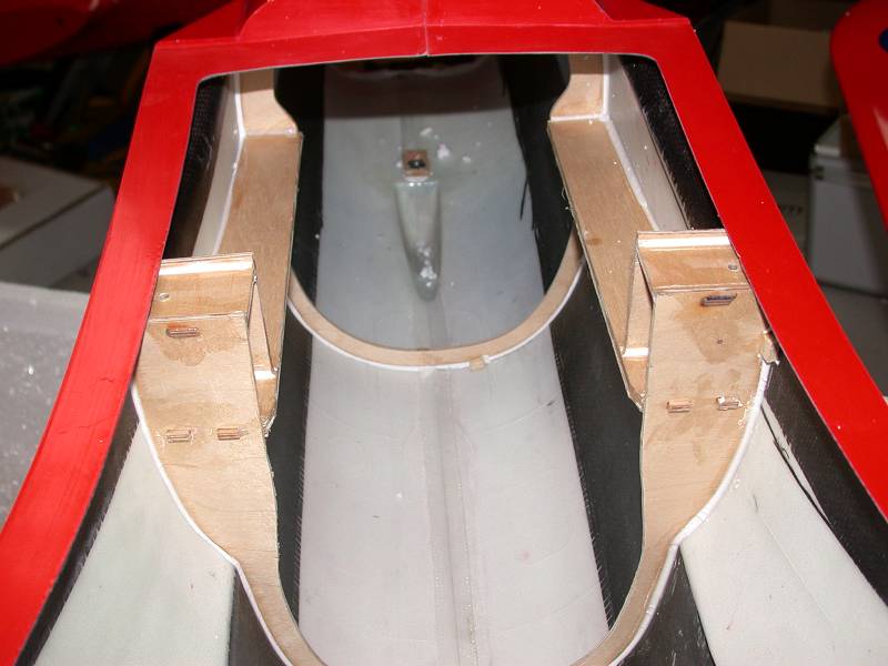

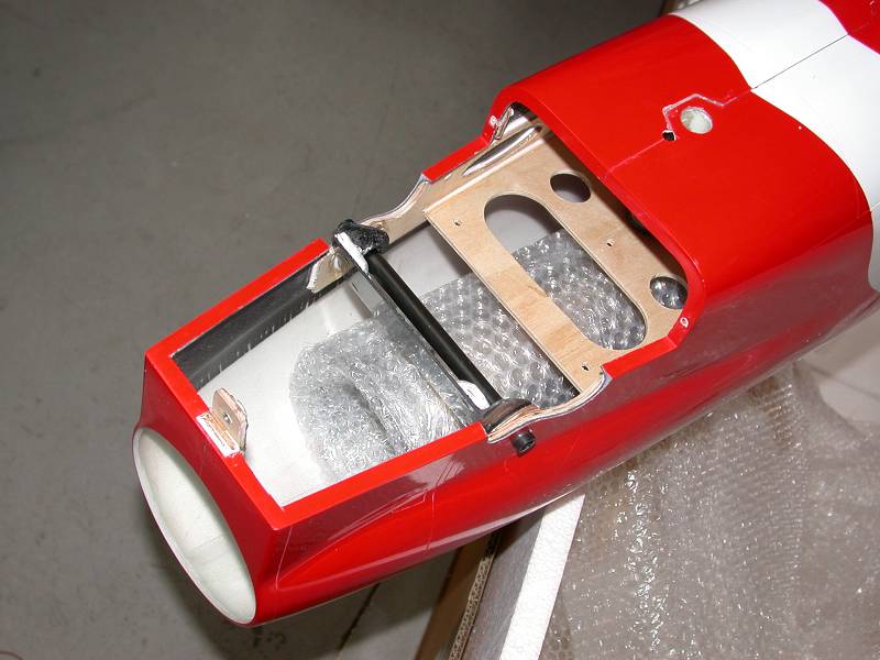

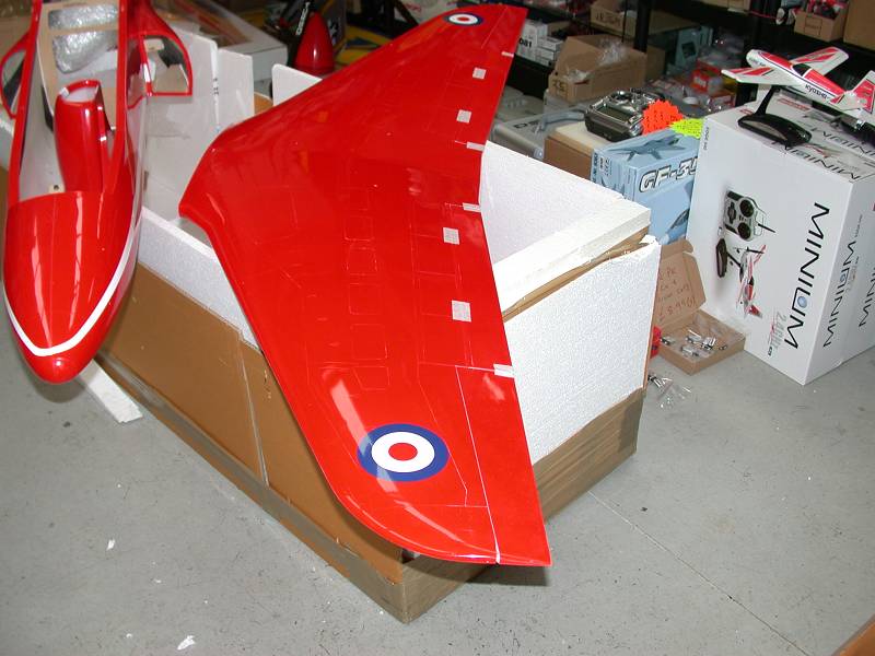

Guys
Early Xmas this morning, I've unpacked both a Comp ARF Corsair and the new Hawk kit
The Hawk is a first production item sent ahead so I can help with the building notes. I'll keep everyone posted and do a build thread as I go. (won't start for a few days as I've got another Hawk on the board to finish-Eflite EDF!!)
So far I think they have another winner!
Dave Wilshere

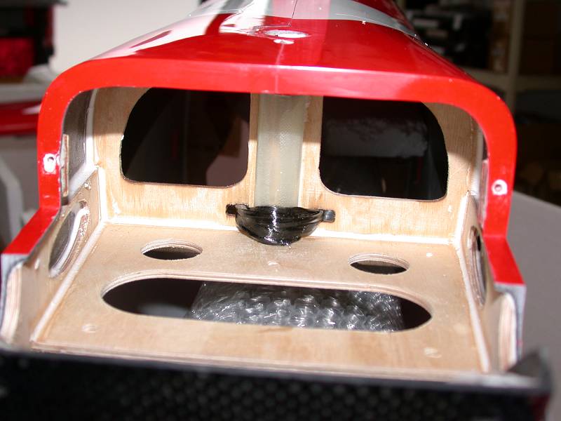

Dave,
Man thats a nice looking kit. The fillets I see around each is former tells the tail about the craftsmanship on these. What size turbine will it take for this kit?
Keep the indepth photo's on this one coming. It's going to be a good one. Thanks for doing it.

Guys
Turbines in the P120-160 class are perfect.
You are free to use any gear as normal, but the Comp ARF set up will just fit in. Quality of gear will be very high-German made.
The kit is going to be offered with a Sports Scale gear to start with-photos soon.
Simon...you are right...in Black!
Not intending to do a Corsair build thread, sorry.
So far I can't tell you what the final package will include...when I know I'll let everyone know. For sure the basics will allow a nice scale model, but things like the live Flap Hinging are meant to be Sport Scale...It's a perfect Scale Flash/Lightning follow-on model.
Dave W

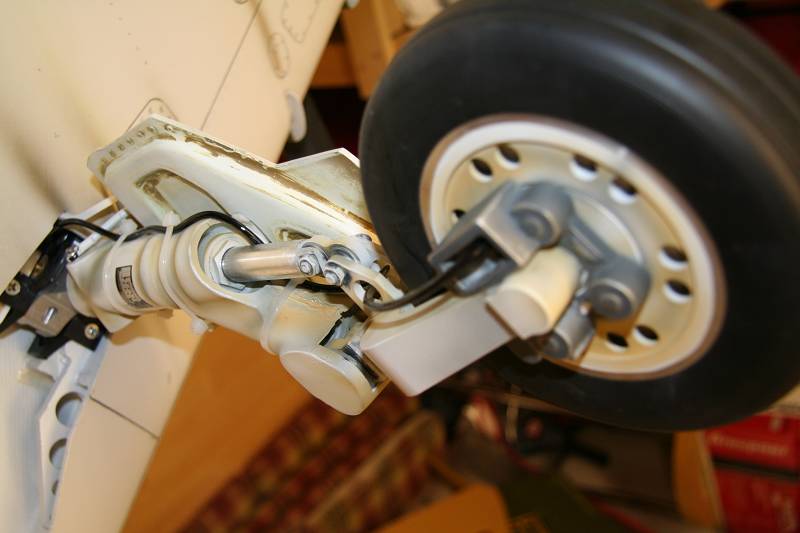

for what i know it will be same gear as introduced by Graupner some time ago.
so as far i can remember scale gear is about 1800 euro,s..
while sport gears start at far lower then that..
Old 03-31-2009 | 08:28 AM
schroedm's Avatar
Posts: 5,193
From: SevenoaksKent, UNITED KINGDOM
Default RE: Comp ARF BAE Hawk build thread
Maybe an answer would be to replicate what Skygate do on the big Hawk i.e. just use a plain old oleo and the fit a scale molded cover around the oleo?
Looks OK on mine....

The scale gear will be introduced-just smaller version of the SkyGate set up, price expected around 2000 euro, but in my mind worth every cent!-Beautiful work.
I hope Digitec did their home work and the gear fits! The scale gear is open when the load is off, so longer, if you make the gear the "landed" length normally, it won't fit in the wing.
Regards
