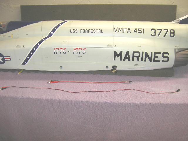

The mystery has been solved. After days of chasing this cycling problem, I have finally found the problem. I could never understand why the Triton was showing such a low voltage during operation and cutting off the discharge, but then when I checked the batteries with my Hanger 9 tester under 1amp and 2amp loads, the voltage was always very high. Furthermore, when cycling my ECU packs also Nimh I had none of these issues. So here it is. The charge leads from the Triton to my ECU battery are 10" long, 13 gauge wire. The charge leads to my receiver packs are standard charge leads sold by Great Planes and are 39" long and 20 gauge standard servo wire. The Triton was fooled into thinking the battery voltage was low when in fact the resistance was coming from the long leads. This explains why the Hanger 9 tester showed a higher voltage than the Triton. The packs are now cycling correctly and producing the best numbers ever. I have to thank my friend Rich Miller "RCISFUN" for answering my repeated phone calls and helping me through this issue. Thanks to you guys as well for your input.
Dom

No the RX packs have 18 gauge wire. The problem was the charge leads.
Here are some pictures of the old charge leads and the new ones I just soldered up.
