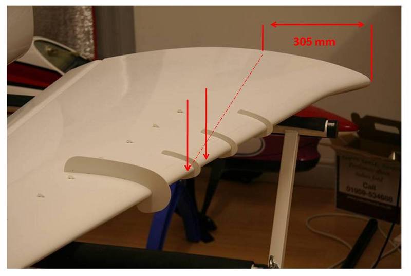

Hi Mark,
The recommended CG as you know is 305 mm AFT of the LE of the Wing. This is exactly where the 3mm wing bolt hole is located on my model and when the reference is transferrd parallel to the Main Spar it ends up being just outside the second outer wing fence. My CG is actually about 295 mm, the model balances between the second and third outer wing fence as indicated on the photo (I hope the quality is clear).
I could move the CG back but with the extra weight it handles well and is very stable. I ended up using a PowerBox Royal with TWO Duralite Lithium-Ion HC 4,300 MAh, 2S2P and they are mounted on the floor between the 2 pilot seats.

LMAO!! I don't where that picture came from but that's my wing on my stand with my empty take-away cardboard box in the background
I really need to double check mine. I have a 4cell nicad AND my ECU back under the rear elevator cover!! RX Lipos are strapped to the wing tube. Either I have pilots with lead boots or (as I suspect) my CofG is too far back!
Always good to see installation pics. I may have to end up redoing mine during its overhaul so post away [8D]

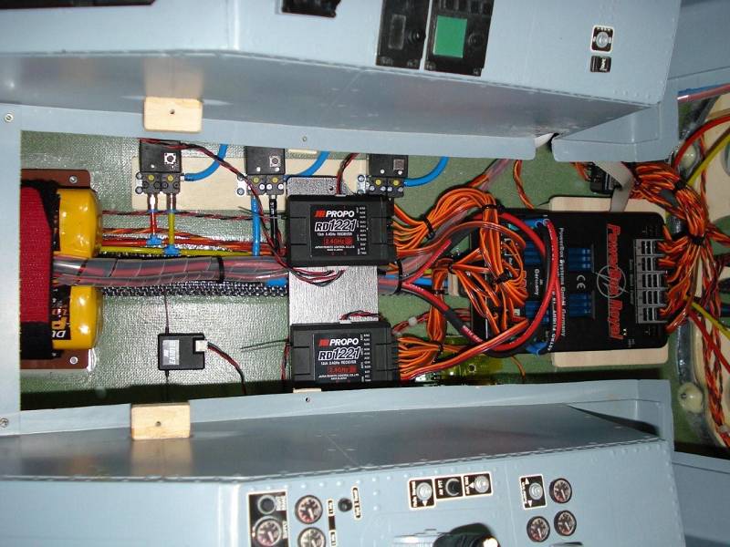

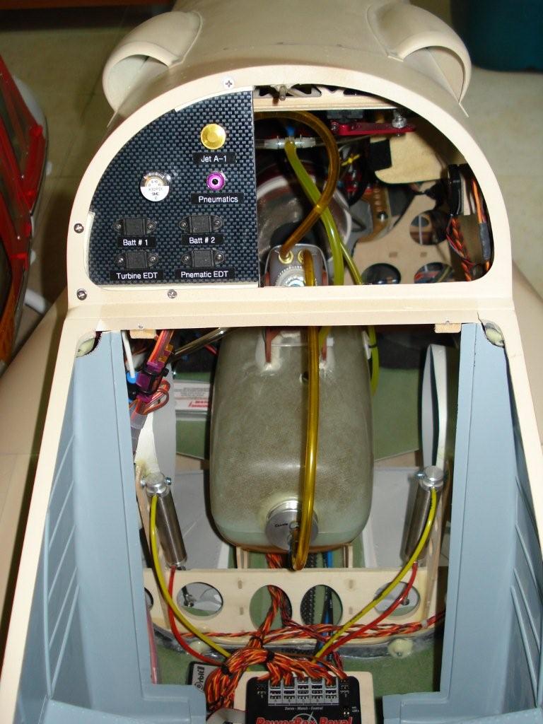

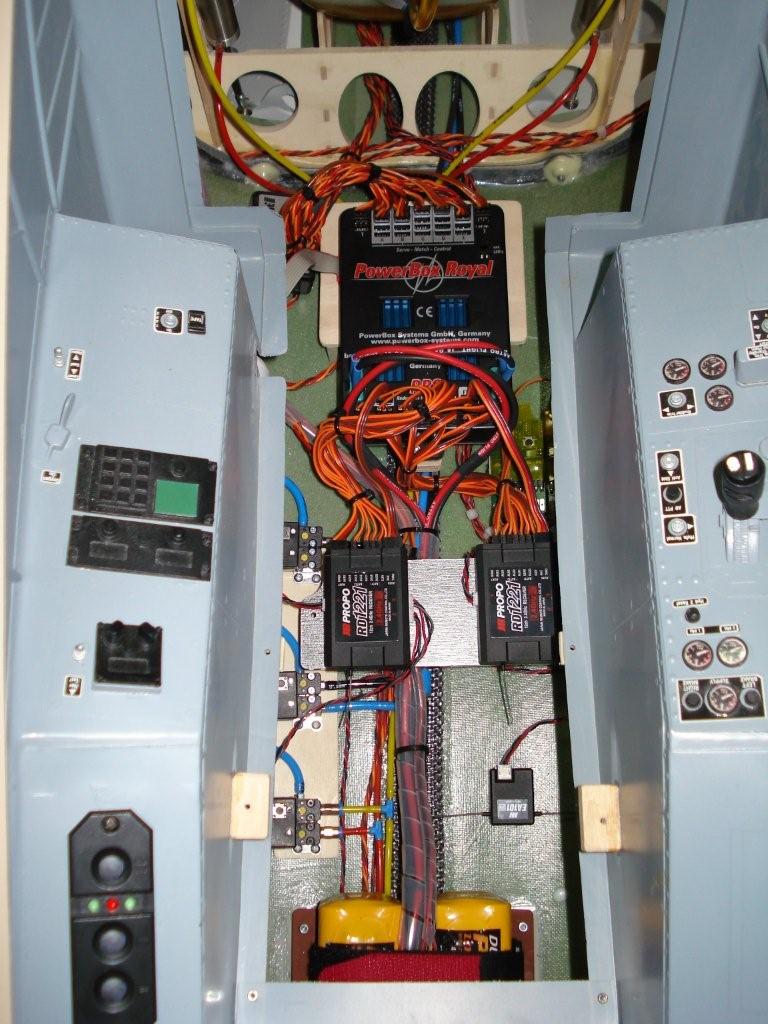

It is your wing, I just quickely downloaded the picture from your other Skygate Build Thread and drew the lines on it.
My ECU battery, ECU, Fuel Pump and Valves are all mounted on a platform between the intakes and the turbines forward mounting former. I have nothing mounted behind this location except for the turbine. All the other gear is basically below the rear pilots seat, nothing forward of this. My UAT is mounted on top of the Main Fuel Tank. I made a Half Panel in the rear canopy "D" Shaped area which has my re-fueling and de-fueling valve, pneumatic accessories and battery charge pionts.
I will take some photos tonight of the installation and post them tomorrow.
