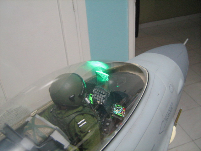

I don´t have any extra equipment. Just 5V to pin 1 and ground to pin 4 (normally I use a receiver battery for power the displays on) and that's it!! (watch the pictires I uploaded in my post No. 78)
The screens play the videos I have recorded in theuSD card. They are in.AVI format.
I don't know which kind of formatit plays because all the info I have, reads that it can play images and videos, but don't specify which formats( I supposethat it support all type of formats)
I just used asoftware called Camtasia Studio and recorded the PC screenwhen playing Falcon 4.0 Allied Forces software that is an F-16 combat simulator. The I used the smart focus tool on this software to record only the MFD screens (first the right one and then the left one) and got a .AVI file for each MFD (32 Mb each file) and then I uploaded the files to each uSD card using the sofware I downloaded for theuOLED displays, and done!!!.

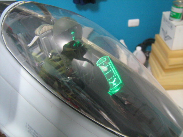

You told me how. Don't remember? See post No, 21 on this thread.
I played again the Falcon 4.0 simulation game, paused the action and got all the HUD info.
Then I draw by hand with a small ruler, all the simbols in a masking tape, placed the tape in the plastic HUD, and using a X-Acto sharp knife, I scratched the HUD following the pattern I draw in the tape.
NIce job with your panel Want to see it working......

Hi Guillermo!
I was wondering if that's how you did it - it just looked so nice and detailed that
I thought you had found a better way!! Good idea with the masking tape!
A better way is to find a trasparent uOLED and stick to the HUD like a tape and display all the information a OSD can display in a telemetry system
