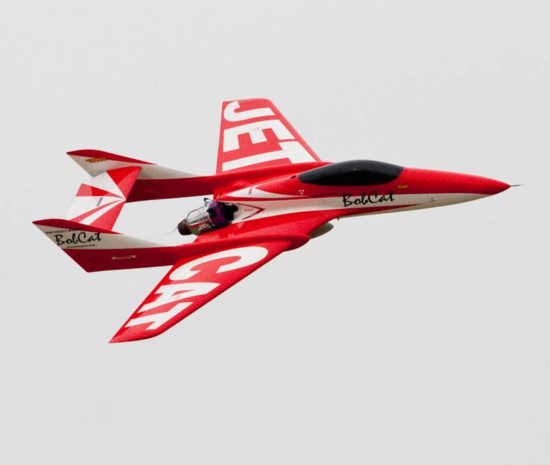

Matt,
I have not noticed any differences with or without crow in a crosswind...and believe me, if we have a wind here....it's a crosswind [
Chad
]Chad
My Feedback: (8)
ORIGINAL: mr_matt
What do you guys think?
I might be heading for a heavy crosswind weekend and I am not sure how the BobCat ARF will respond with and without crow.
Anyone got any thoughts on the matter?
Thanks in advance,
Thanks in advance,
Semper Fi
Joe

Basic aerodynamics.. you always need to add a little airspeed for every added 5 Mph crosswind. You may remember the day after the hurricane frontal passage at Superman! I remember adding about 15 mph to my approach speed while doing touch-n-go's.
My BobCat is an early built-up XL..no flaps so no crow between the flaps & ailerons. But I did have crow available for extra drag (both rudders in) but personally I would never crank in extra drag during a 1/4ing or direct crosswind of more than 10 mph. Cross control and if anything added lift say 10 degrees of flap if you've got it is the best method in a crosswind landing!
An easy formula that works with any aircraft is: apply enough rudder to keep the landing gear tracking parallel with the runway center line.... and then apply what ever aileron is necessary to keep the aircraft on the center line. Of course pitch control and power as necessary! This formula in extreme wind conditions will end up in an upwind main landing gear touching down first then the other main and nose wheel will follow.
I had an instructor working with me during my Commercial check ride prep that believed a good crosswind landing required nose wheel and upwind main touching at the same time and then lower the wing. Needless to say he could never demonstrate what he was talking about.. so I had to teach him how to do it safely!
I had to land in Hays KS one day with about an hour of fuel remaining... after three go-a-rounds in a 43 gusting to 50 mph direct crosswind in my 182. They actually sent line boys out to wing walk us in... not a bad idea, I thanked them you bet. I used my well tried and trusted formula for crosswind landings it worked great.. but the reason for the three go-a-rounds as you might have guessed..was that I had to increase airspeed each time until I could get the rudder off the stops to hold parallel. That was a fun day
)Lee

Matt,
One school of thought is not to use full flaps in gusty crosswinds. They mostly provide drag and you may have less control authority at slower speeds. Not sure that's so much of an issue when used in combination with crow which is designed to kill lift as well as add drag. I would probably opt for the crow.
Another good technique in a really strong crosswind is to land in a crab (angled into the wind) and if the runway is wide enough, actually land slightly across the runway. That is, line up towards the downwind side of the runway and turn into the wind (a little) just before you start your flare. This way you are getting a headwind component out of the crosswind, reducing your ground speed and not fooling with cross control rudder so much. As soon as you touch down, use rudder/nosewheel steering as necessary to keep it on the runway. Holding aileron into the wind will help keep the wing from tipping.
Good luck in Tucson,
Craig
Craig

Matt - I know it's not quite the same since my old Bobcat is not the ARF, but anyway... in a particularly strong crosswind I simply don't use the 'crow' (reflexed aileron) on mine - I just crab it in instead.
Since the crow pitches the nose up, I personally find that makes the aicraft more susceptible to crosswind gusts because the wind has that much more exposed surface to grab hold of (note extensive use of scientific & aeronautical terms). I actually only need the crow on that Bobcat to help slow it down for some of the shorter fields anyway (remember, no flaps on the original Bobcat) so it's no big deal to land without.
The strongest crosswind I've landed the Bobcat in was one where I had to lean forward about 30 degrees to avoid being blown back on my butt. I only did that once.

Matt,
I always found with the Bobcat (old style) and the Kingcat that the crow helped smooth out the crosswind landing, it still allows you to keep power on. Land a little hotter the crow still looses lift even in a crosswind. I rememer myself and Tommy D doing touch and goes in a 25-30 mph crosswind several years ago at Superman.
DR
DR

Anyway Matt, my suggestion is to keep the BobCat as clean as you can during a crosswind landing, and crabbing is not a good idea. Too many airplanes have been bent trying that one!
Lee
