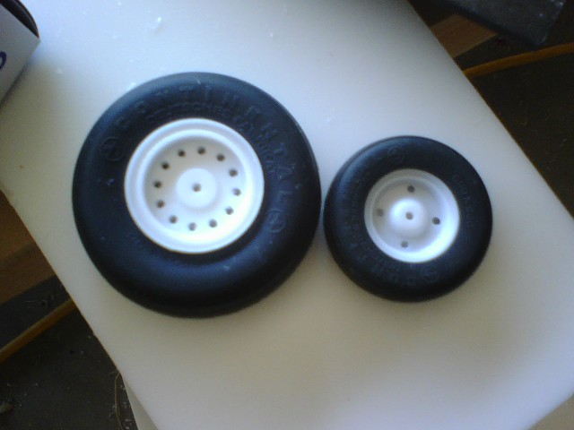

Sic
I used the robart 2.5 and 3.75 but for some reason they only lasted a few flights until the mains pretty much fell apart. They were replaced with some foam tires that John said he had got from Tamjets. I did not see these tires on the Tamjets site but i could have overlooked it. The brakes were also purchased from Tamjets. The robart rims were still used in this setup. Here is a pic of that setup. I machined a scale rim insert and a pressure plate for the brake that fit these rims. Either way you will need some pretty robust tires for the mains.
http://www.glennis.com/scalejetgallery.htm . These guys sell some scale rims and tires for a larger a10 but they told me they could scale them down. They gave me a quote around $400.00 for rims, tires and brakes.
chris

Here are some other rims that i machined out of polyethylene. This plastic is strong but is a not really good for painting. These were machined to fit the robart tires.
chris
