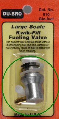

I've never used a pump with a 46VRDF(I assume you're talking about a DF engine), but I did use a DuBro fueler and found that it wouldn't flow enough fuel.
I had to go to a fueler for a large glow engine to get it to run.
I suspect your shared vent is the problem: It's big enough to supply vent for 1 engine, but not for both.
