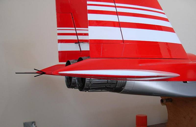

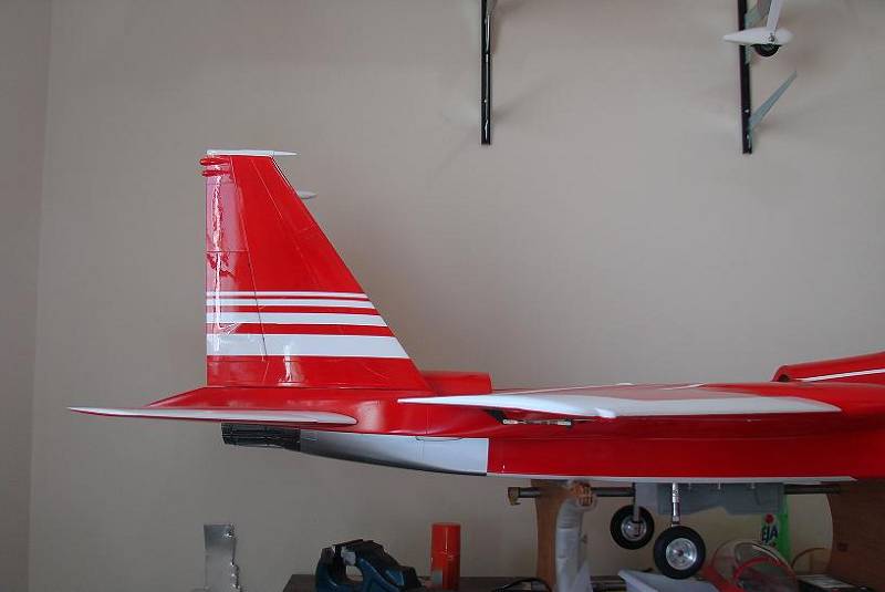

Old 04-09-2009 | 09:02 PM
erbroens's Avatar
Joined: Nov 2003
Posts: 4,292
Received 16 Likes on 13 Posts
From: Curitiba, Parana, BRAZIL
Default RE: HELP F-15 Elev neutral position
as promised:
at+,Enrique
ID:	1176879   Click image for larger version
Old 04-10-2009 | 11:12 AM
Posts: 123
From: Orlando-FL
ORIGINAL: erbroens
as promised:
at+,Enrique
Hi Enrique,
Thanks for pics! I go to make this in my F-15! Good luck for me! hehehe
Nice your bird!
Regards
Fabio

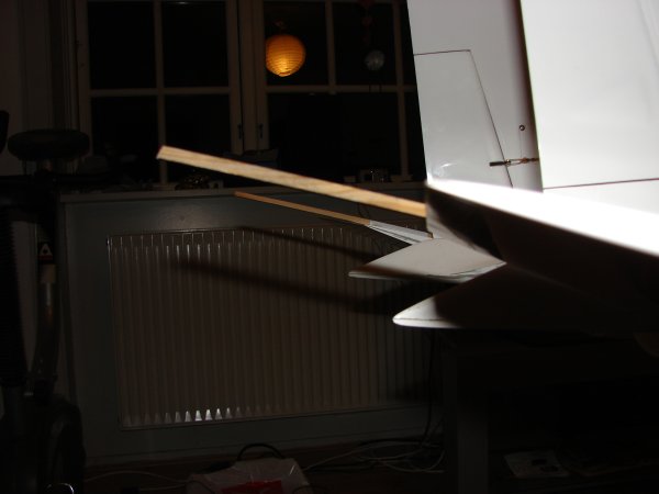

Old 06-05-2009 | 11:48 AM
SJN
Posts: 6,326
Received 7 Likes on 7 Posts
From: Copenhagen, DENMARK
I usualy use this low tech solution.....works great
ID:	1212304   Click image for larger version
ID:	1212305   Click image for larger version
ID:	1212306   Click image for larger version
