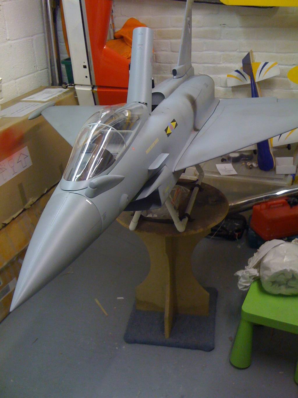

Is she still for sale?
at the right money, of course.

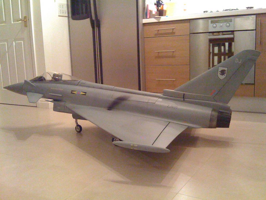

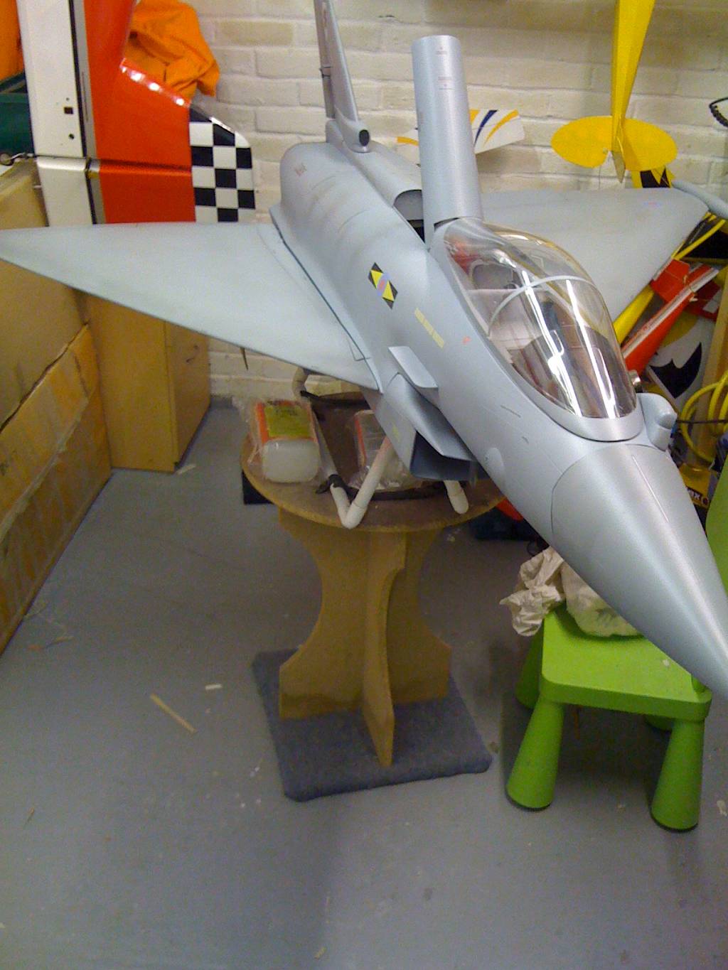

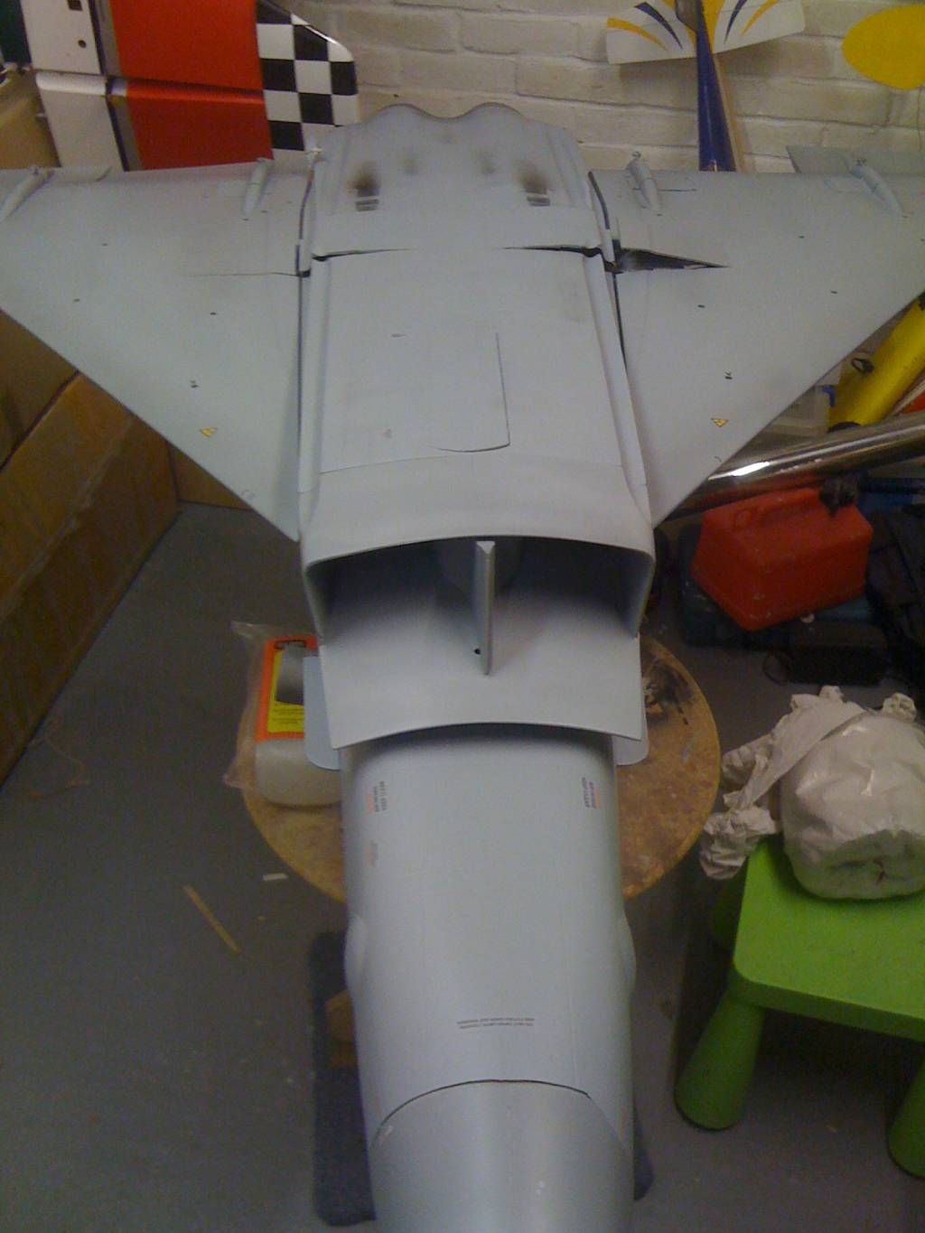

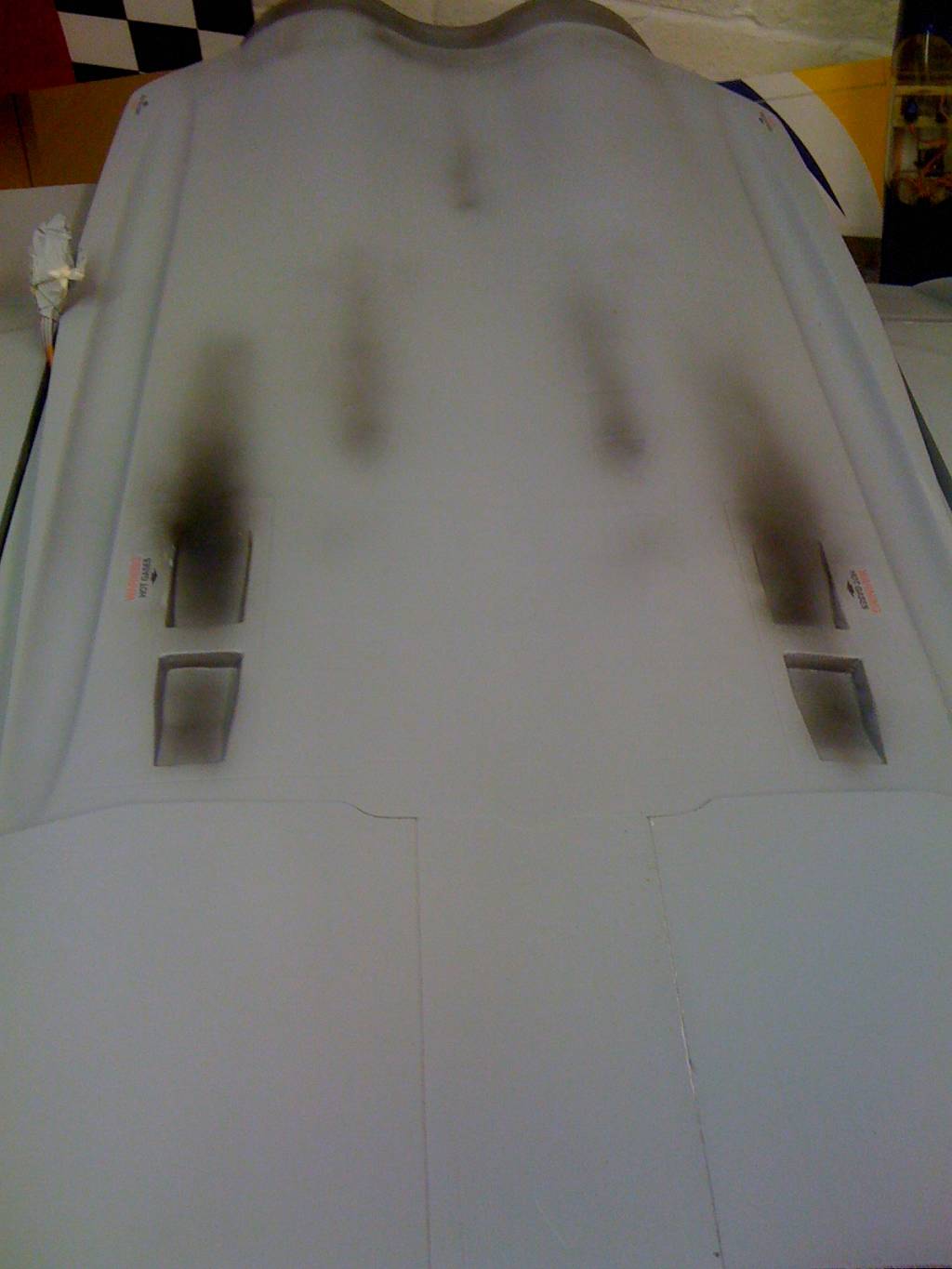

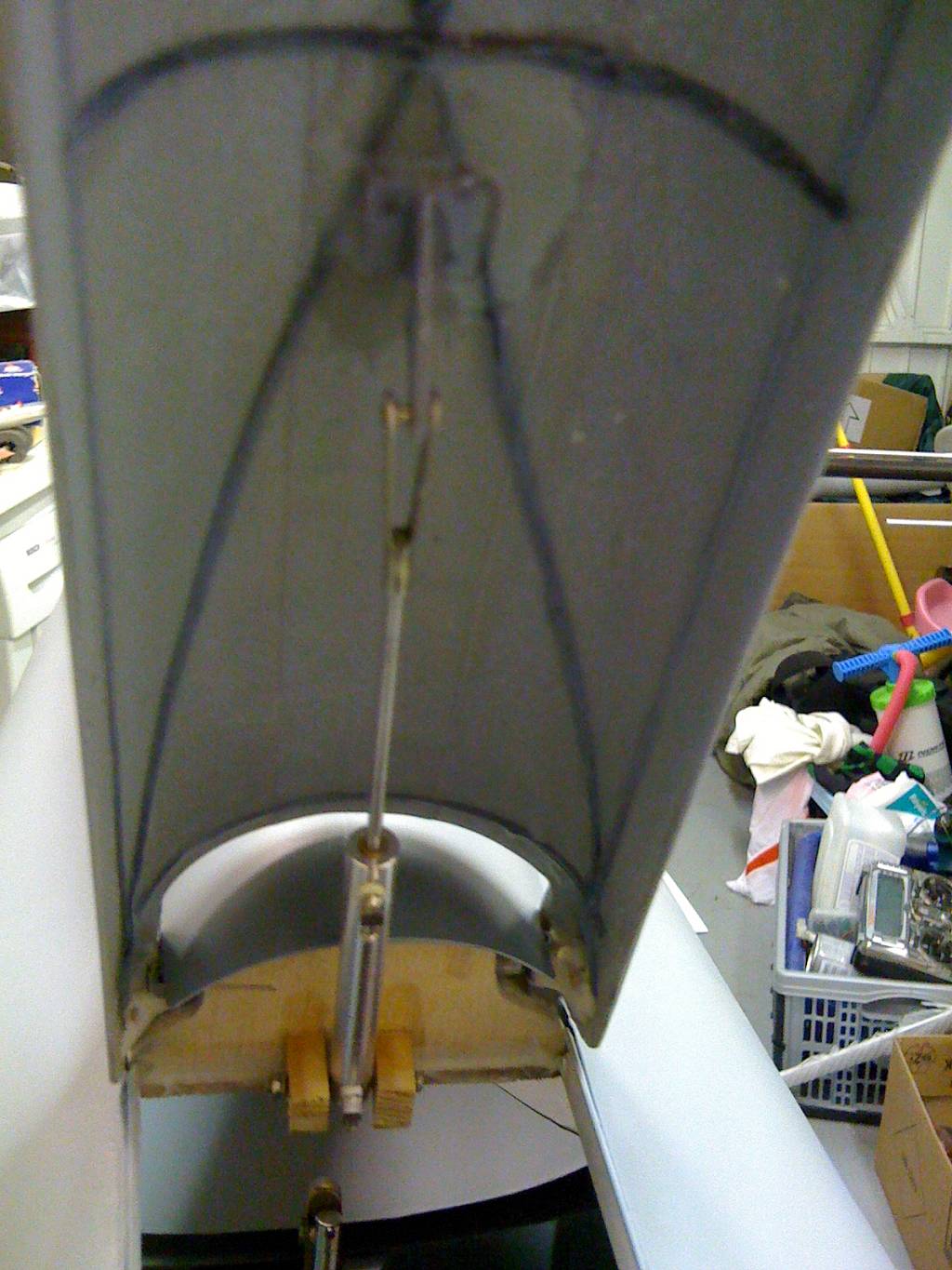

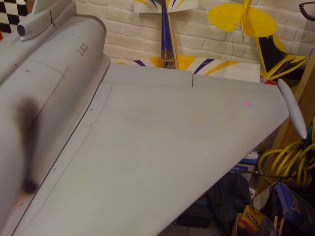

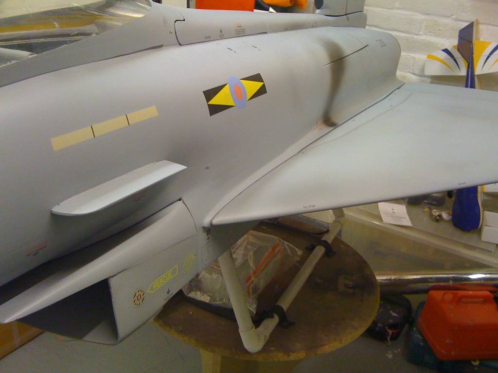

Some more pics after quickly putting the pieces together, except the canards of course.
Matt clear was done using the Plasticote Super range and has come out very well, apart from a small area on one wing where it is a little light, nothing a quick touch up can't remove.
Speedbrake all finished, pretty much just a case of cables, tubes and turbine.

This models now been sold on, as you can imagine im now a very happy owner, just starting to sort it out
lozza

Havn't stopped grinning for a month, the detail is outstanding, at present its a bear shell the elevator servo's were glued in but have managed to remove (I like every thing removable ), have removed all the other servo's as i want it set up my way and with my servo's, retracts really suit the model and got all the airpower valves that came with it, need to test fly my Flyeagle F16 to see how the supersport copes then will make my mind up on an engine for the Typhoon

hi there just found your article on the fox euro fighter had a good read through me and my father inlaw built the original model that jim moulded off all was aticalled in the rc jet international mag 1 thing you might want to consider is some more powerfull servos on the elevator as we found quite a bit of push back onour first model we even considerd useing all four sections as elevators and fly it as a delta formation another thing you want to get wright is the c of g otherwise you will be in for for one hell of a ride if rearward 12mm made all the differance from our fist flight to the second one im currentley building 2 that i got from jim that will have 30 pounds of thrust if you need any infomail me any time archie also canards have loads of authority so small amount was mixed in for take off we found it helps it unstick from the tarmac as the uc are a little far back for modeling but in the scale plcae
