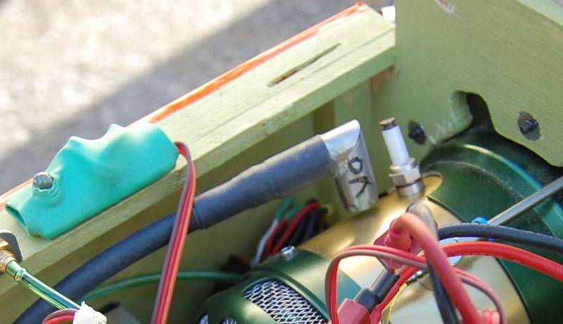

For those of you that are still using propane start turbines , you might be interested in one of the project I have just finished, and that is to replace the glow plug start with a spark ignition instead.
A few reasons for this, one is in very tight spaces , it is easy to damage the glow plug and glow plugs have to be replaced sometimes.
The spark plug will last forever in this application.
Easiest start ever, reliable and in just about any temperature.
The downside, you do have to install the ignition module and it will add some cost to your model.
Just a thought...
Roger

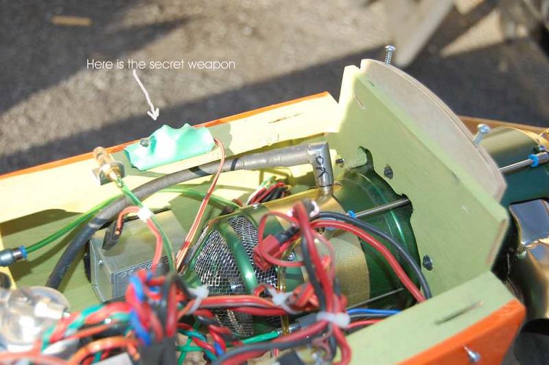

OK here are a few photos , I hope this helps
Roger

ORIGINAL: ianober
Very cool Roger, that ignition unit is MUCH smaller than I was thinking, awesome!!
It is very small but I hope you didn't think it was the little green thing, its not the module, that little green thing a ma jig, is what makes it all happen but the module is lower in the picture with aluminum case.
Roger
