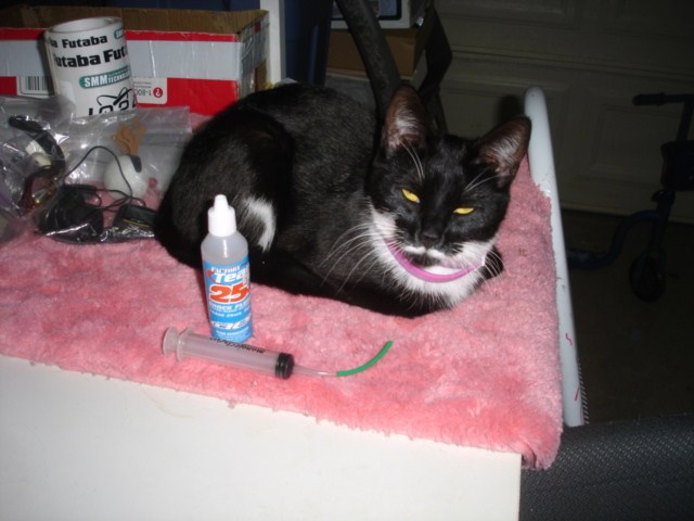

I use # 25 weigt from cars shocks ( I just noticed "cars" funny ) to lube the O rings inside the retracts, it makes them very smooth and you get less friction on the cylces ( more cycles per tank ) [&:] [8D]

Chris,
I just counted how many drops i put into the strut and tried the travel each time. Did the same for the other one.
V..
