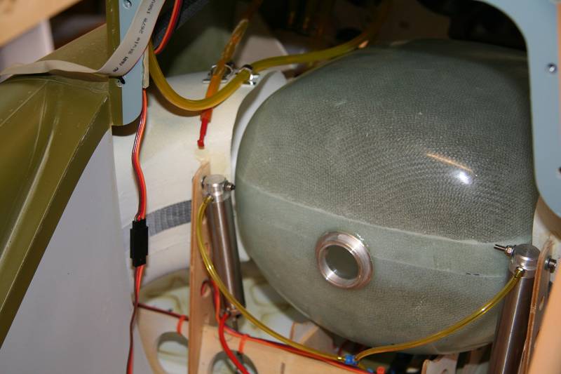

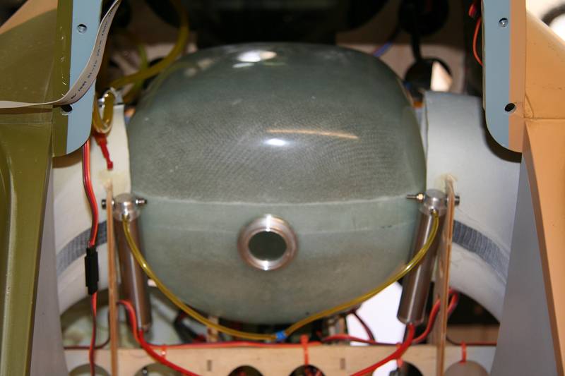

I have finished swapping my booster 160 for a P180 and an now onto installing my new bigger tank.
Please can anyone who has installed the larger 5.8L tank from Skygate post some pics. Resting the tank in place shows it completely blocks the ends of the inlet ducts!?! Did you reshape/cut yours back??

Hi David,
Thanks for the info.
I've attached a few pics of the issue. Perhaps the guys from Kuwait could help - I believe they have the bigger tanks?

Hi Mark
I hope to have my bigger tank soon. It looks like you just have to trim the intakes back just a little. I'm also working on getting my chute installed! I will follow what David S. did with the release setup.
again, it looks like its just a trim job from looking at the pictures.

Hey Ro,
Yeah, that was what I was going to do.
I am thinking that I'll leave the frontmost part of the ducts up against the tank like that and cut them at an angle backwards. The idea being that the air comes in and is directed back past the tank with the tank kind of acting as a duct?
I don't think the P180 will have trouble with that? Do you?

depo,
I just cut my ducts back at an angle so the air comes in and is 'ducted' to the turbine by running over the tank. Have had no obvious lack of air issues with the P180.

Hi Darryl/Leon,
I've had about 11 flights with the hawk on the P180 with the inlet ducts cut back and all has been fine. The bigger tank (available separately from Skygate and now Tomahawk Design) and P180 is much better all round - more power, more half throttle flying, more fuel left upon landing, more flight time and much simpler fuel line setup (without all those saddle tanks etc).
