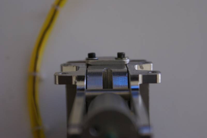

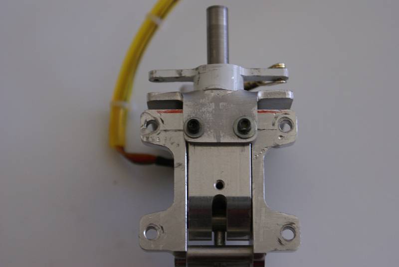

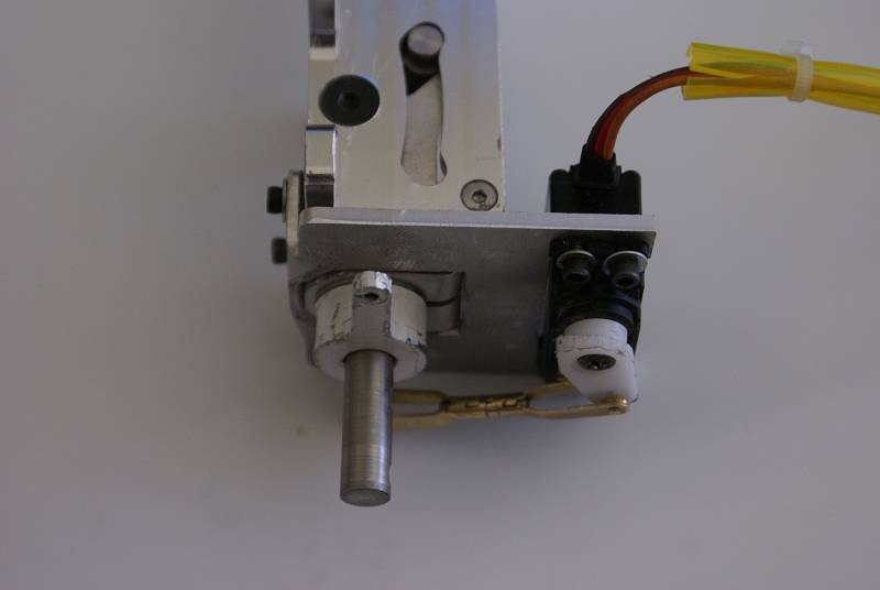

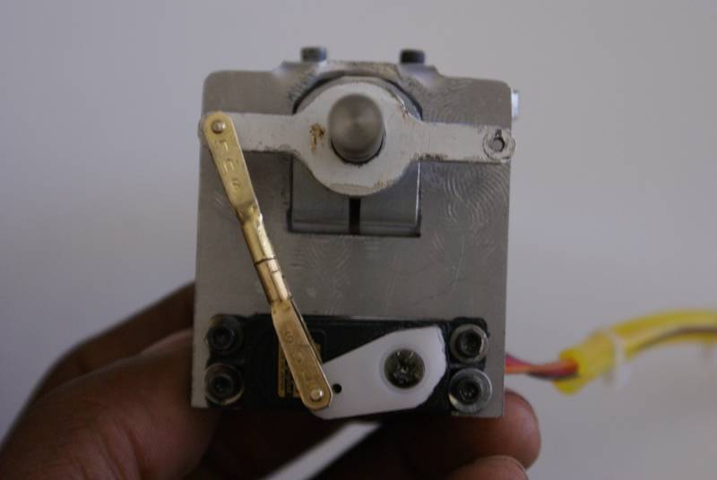

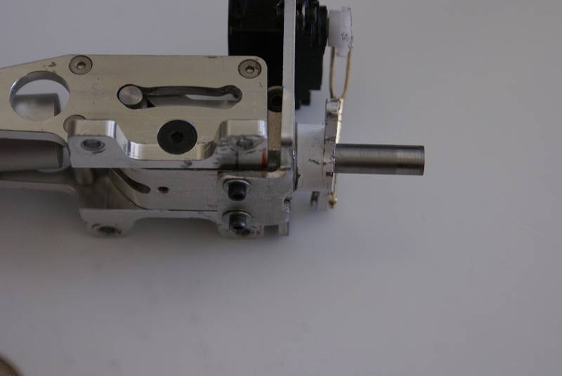

Here are some pictures of the first test piece i made for the smaller servos later ones were made to fit an 8611

Thanks Vince and Wayne. Very helpful pics posted Wayne. However, it seems this part won't work in an F-15 with the retract facing forward and the strut swinging forward also.

P38-J
Nice package in the pictures, I have one concern though regarding the stresses of the servo. Since there is a short, stiff link between the servo and the gear - isn´t there a risk involved in leading all the handling forces into the servo? Seems there should be some "override safety spring" or maybe you have tested it with applicable abuse?

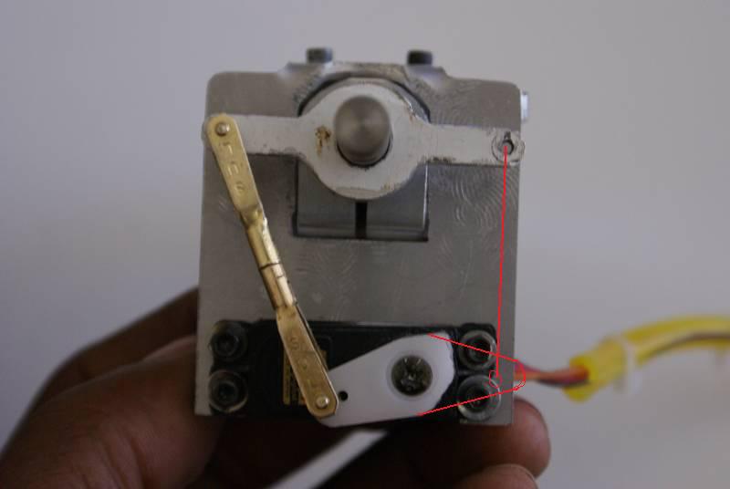

I see a lot of people doing this and I don't understand why. Can someone please tell me what the advantage is of putting the linkage at an angle like was done here as opposed to in a straight line as I have drawn?
Les

Clearance issues with gear door hinges perhaps.
