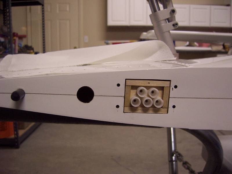

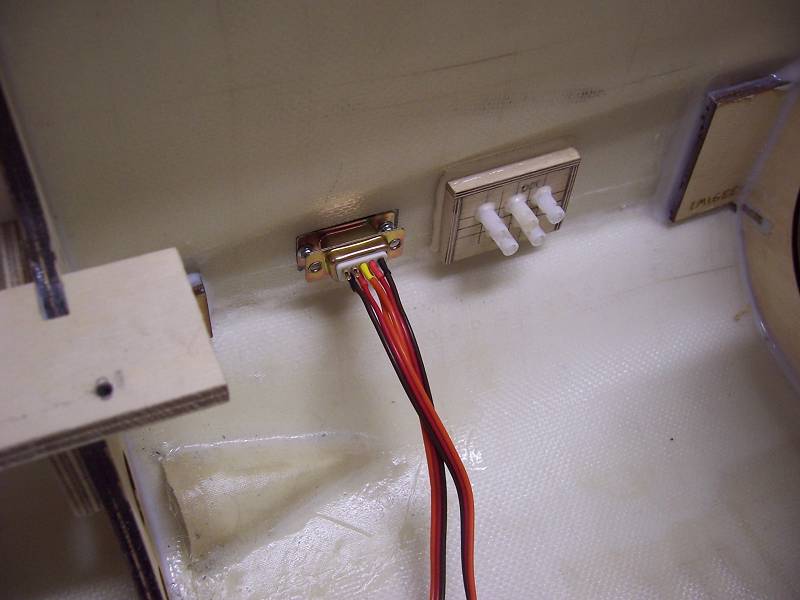

Robart's better D*mn well work properly, I have made them a lynch-pin component in my pneumatic system on my MB339.....
ID:	1197356   Click image for larger version
ID:	1197357   Click image for larger version
