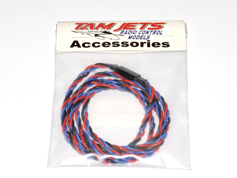

The best one I got is this 39" 20g silver multi wire with soft silicone coated.
Is good wire. But the connector is Futaba. You can trim it to fit JR.
http://www.tamjets.com/original/prod...roducts_id=391

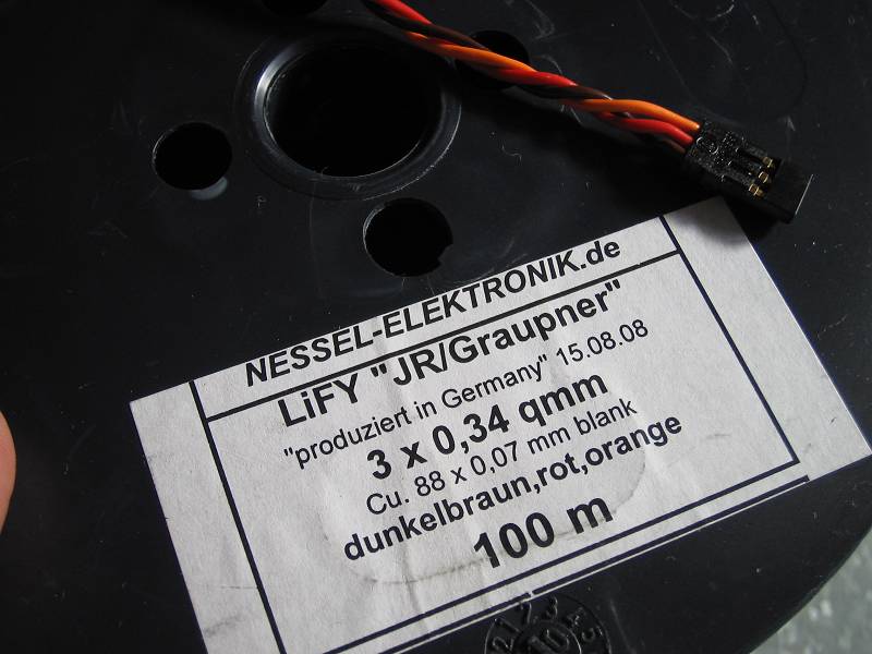

Using a good quality cable, twisted and high quality connectors should be fine. I use a twisted silicone German made cable and high quality JR connectors to make all my cable runs, been good so far.
marcs.
<br type="_moz" />
