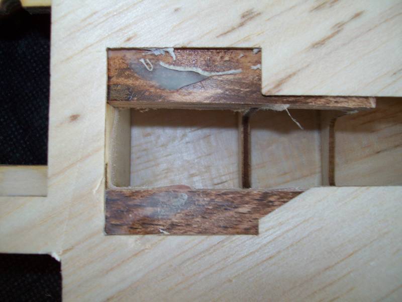

Old 06-18-2009 | 05:16 PM
My Feedback: (41)
Posts: 1,773
From: WEST PALM BEACH, FL
Default FALCON 120

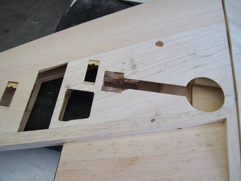

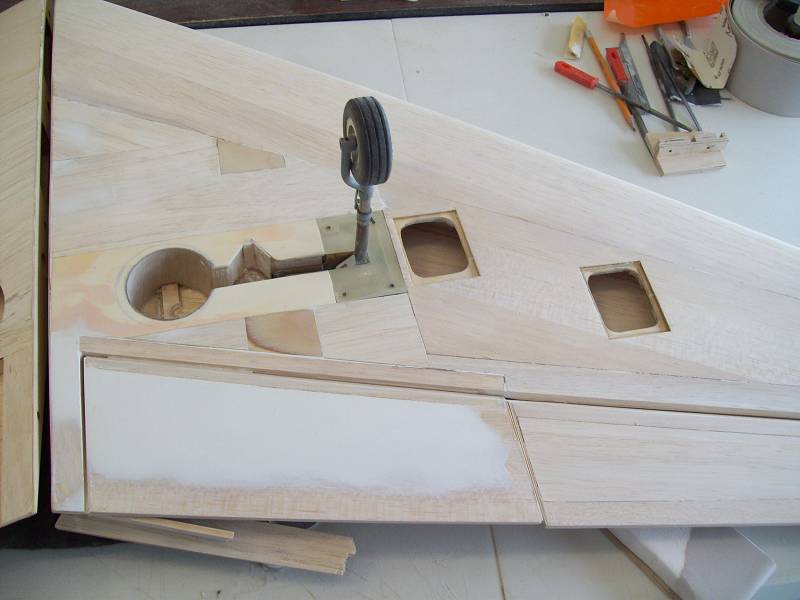

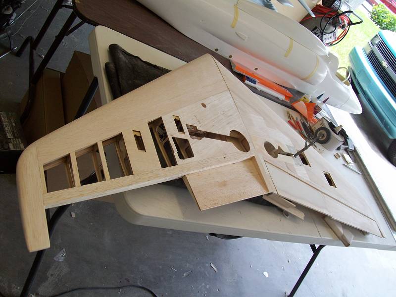

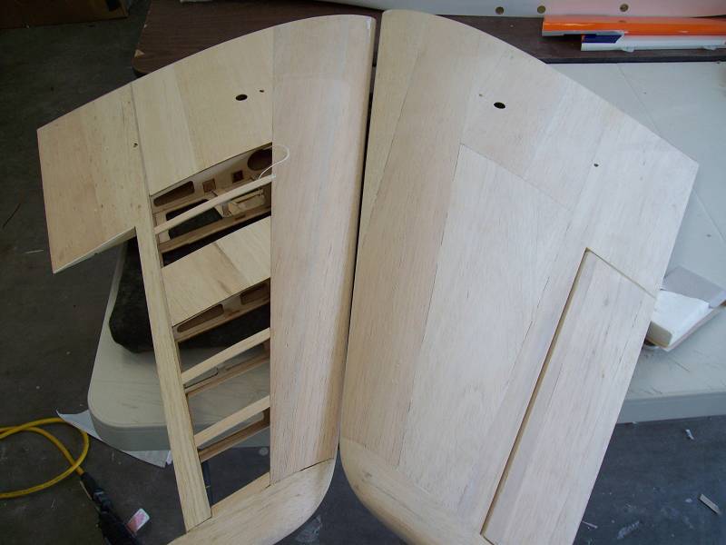

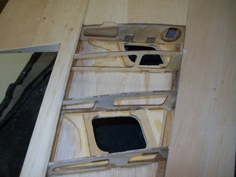

PICS hereare the mods i made to make this plane safe for a p-80.6 new ply ribs.reglue everything.rehinge ,sheet open bays.new wing weight is2 pounds.old one ,no gear 1 pound

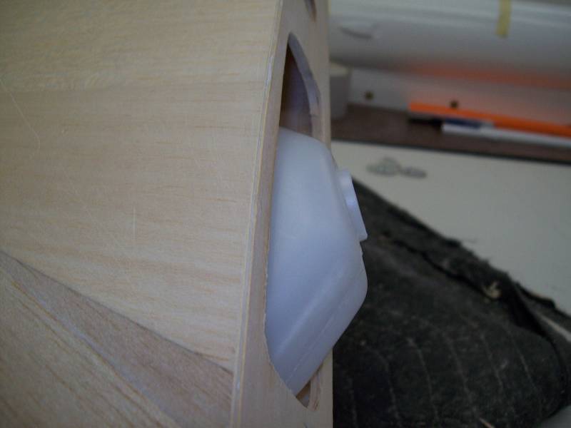

Old 06-21-2009 | 04:46 PM
My Feedback: (41)
Posts: 1,773
Default RE: FALCON 120

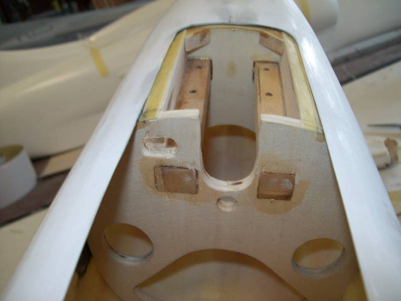

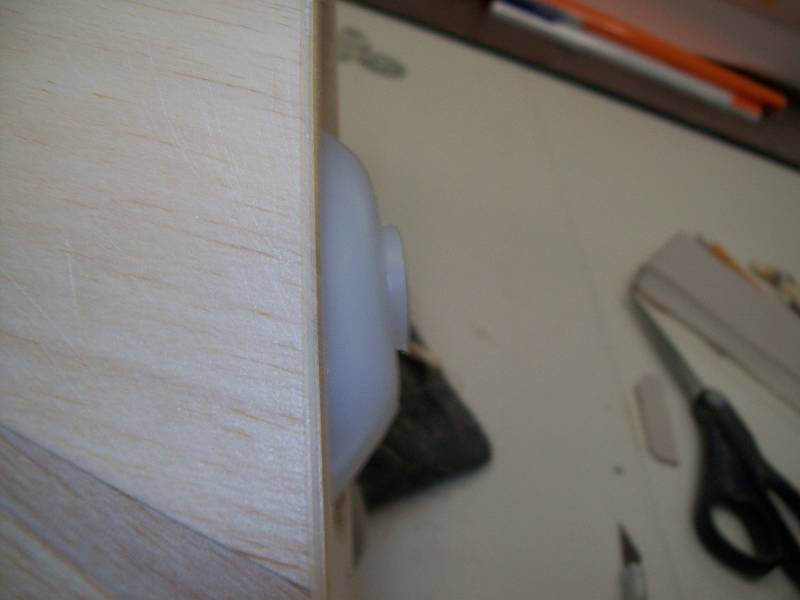

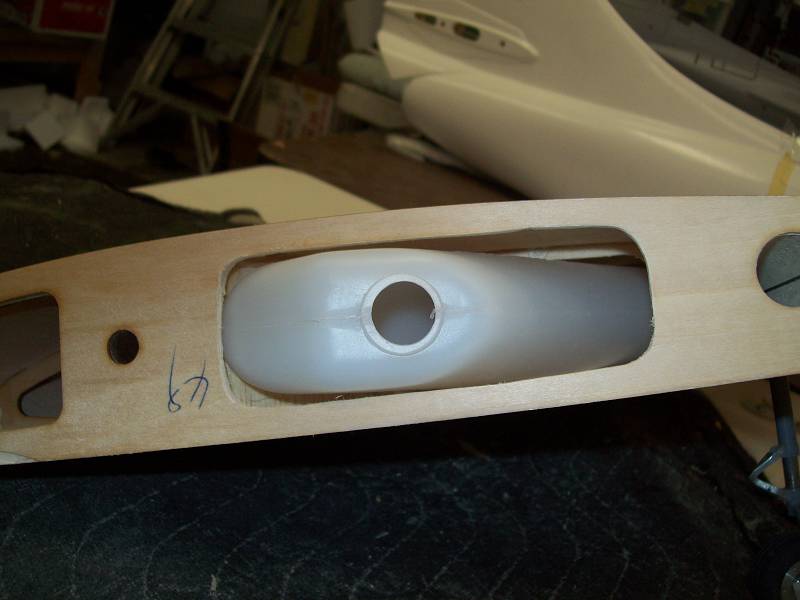

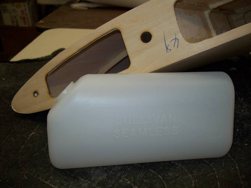

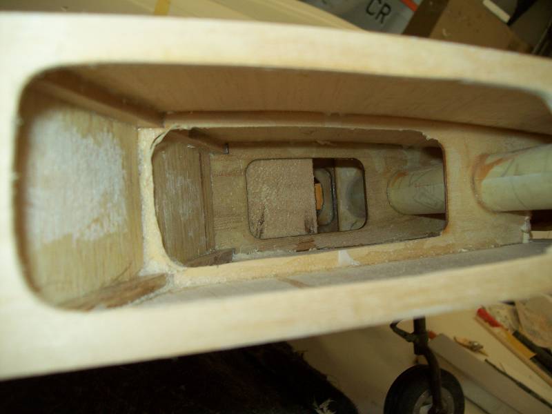

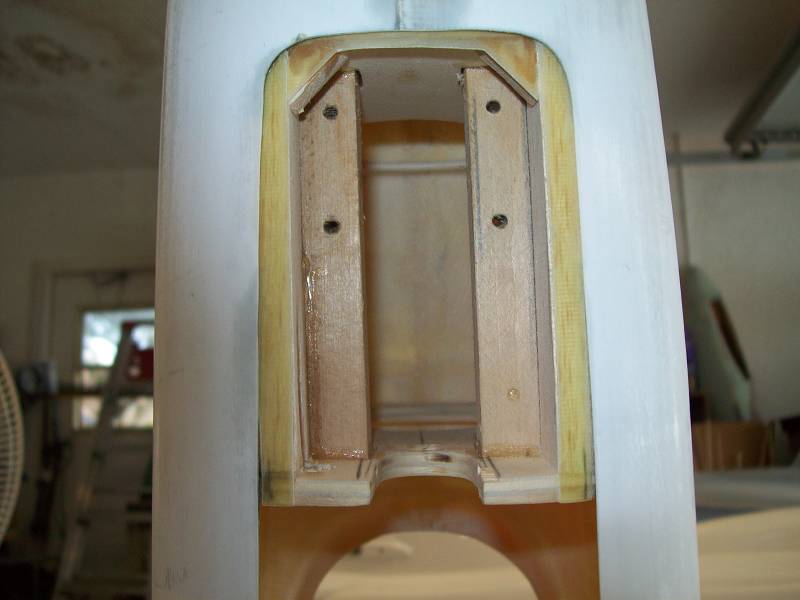

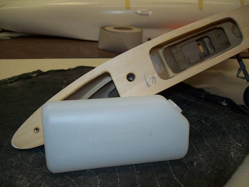

i found a place for 24 oz of fuel.. stock fuel tanks,no fab..fuel tank sticks out 3/4 of inch. now will go into fuse.can connect lines from rear hatch.

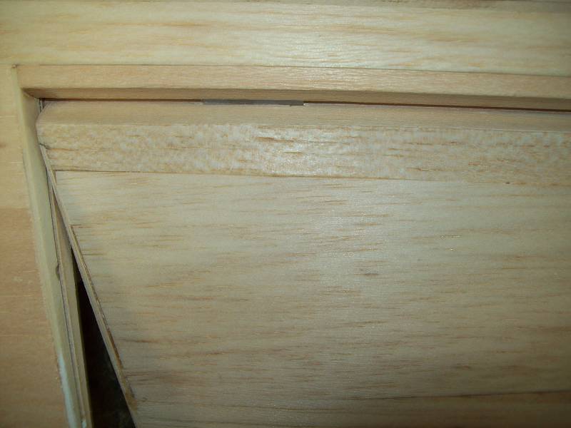

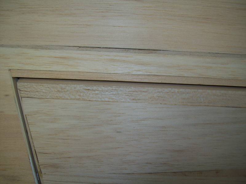

Old 06-23-2009 | 09:41 AM
My Feedback: (41)
Posts: 1,773

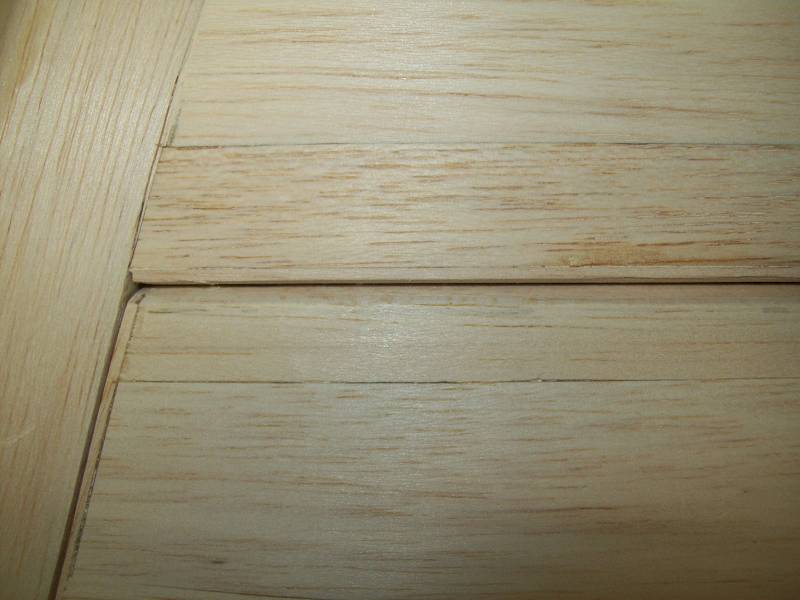

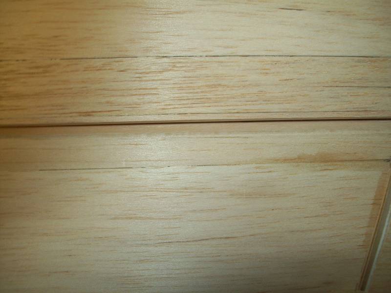

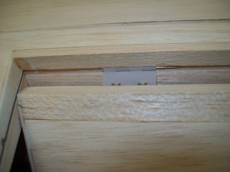

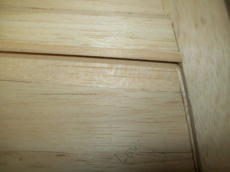

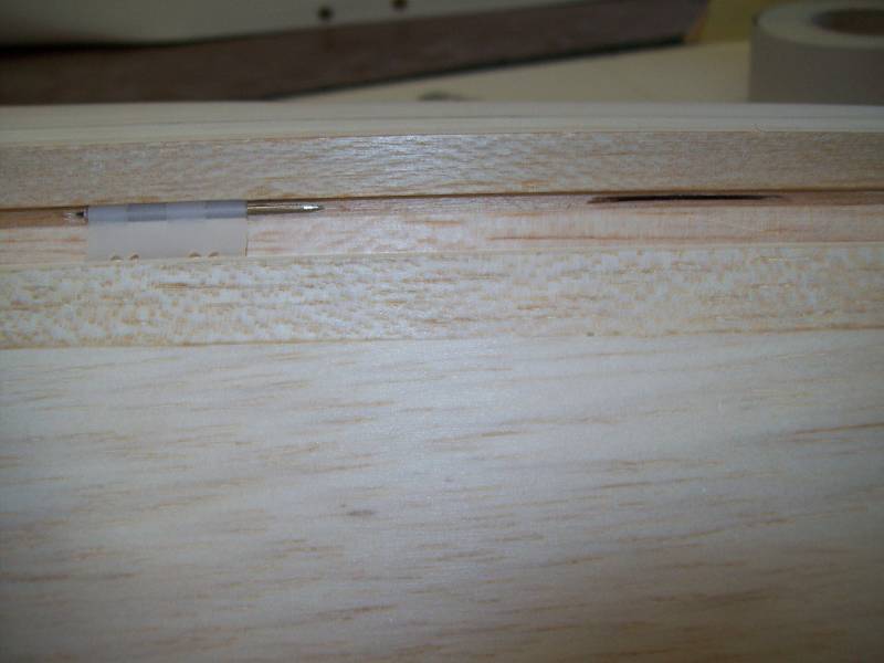

see if you like this idea.. closedup top alerion gap. cant see pin hinges. pin is removed for painting.replaced with one long pin.1/16th..no grove to cut.. cant see them when deflected. 1/64 ply glued to hing slots. then ca, and pined. ply wont splt like balsa grain does..used triangle stock on top of wing so it filled the gap and matched hinge thickness..</p>

Old 06-24-2009 | 08:18 AM
Posts: 3,157
Received 6 Likes on 6 Posts
From: Jupiter , FL
Great!
But I don't understand. Guess I'll just have to send you my wings and stab. [sm=bananahead.gif]
From where or how do you get the pin in? Photo? Don't you have to align all hinges with the pin in before gluing?
Address so I can send you that stuff. [sm=biggrin.gif]
Charles
CASA C-101 brother, #1
Old 06-28-2009 | 02:51 PM
My Feedback: (41)
Posts: 1,773
you use one long pin ,from the end .

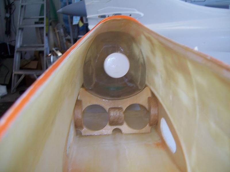

nose gear ,fuel tank
