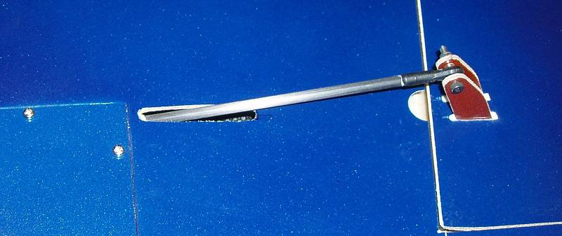

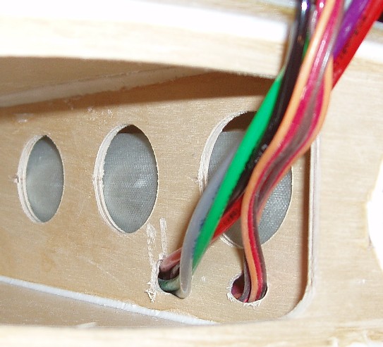

There is no manual. You can figure it out. The new wing design changes the cg to the middle of the wing tube. You have to be creative routing the wires and airline under the wing tube socket. The retracts don't need a spacer under them. The exit hole for the aileron pushrod is further back then the old wing. You don't ave to open up the plate at all. The pushrod goes through the wing skin only.

I hope this helps.

that's pretty weird about the routing of the wires and air lines. from you pic it looks like no way to get the lines into the laser cut holes above where you routed the wires/tubes.

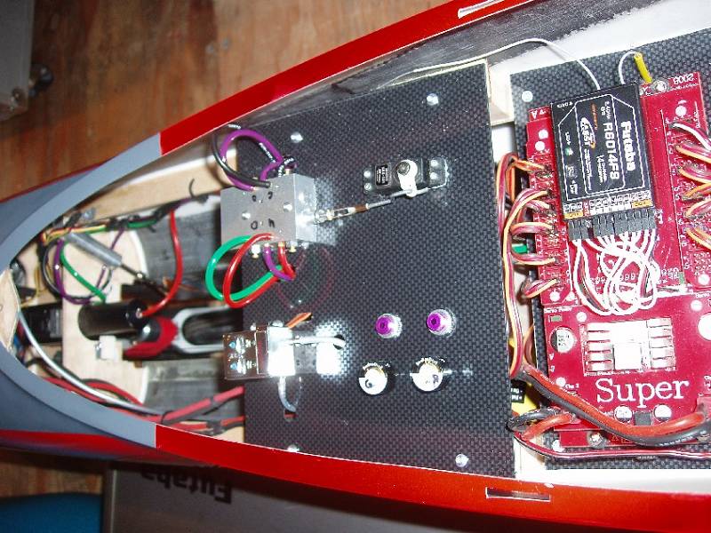

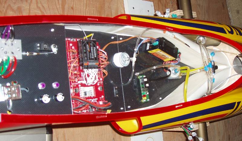

do you both have interior shots of the component board layout? i always like to learn from others.

Default RE: Ulitra Lightning Build Manual
My interior is easy to work on but it doesn't leave room for a deep cockpit.
