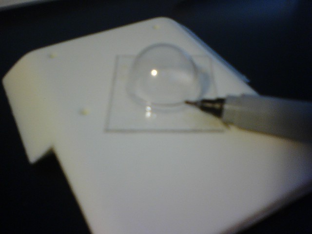

Not to wish to stir up the argument about sound but even with the turbines that I am fitting it won't sound anything like the turbofans on the real aircraft. Everyone has their own preferences for their own reasons.
I have just received my decals from Tailormade decals. They are very comprehensive and awesome quality. Now I just have to work out where they all go
Hopefully I'll get some more work done on it this weekend.

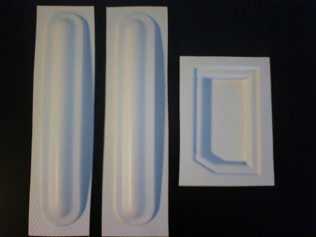

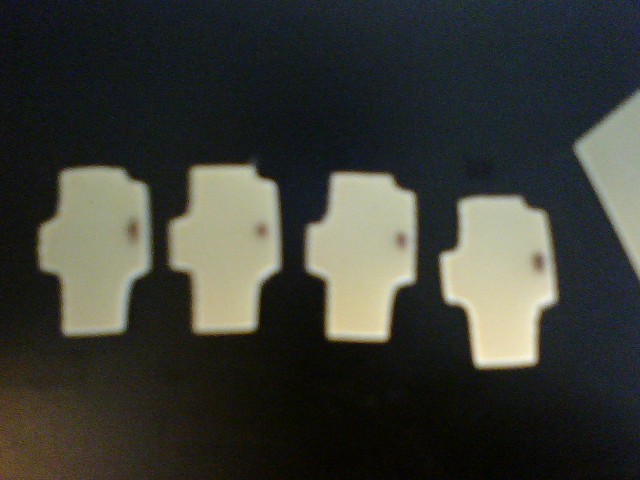

Whaaalaaa. Finished the gear door detail molds today and made some parts. They came out excellent. I also reconfigured the piece that goes between the engine nacelles. I believe this is a vent on the real A10. I use to lay these up but with all the parts i have to make, i decided to vacuum them. These are going to you Mike, when i ship your A10 out friday. Dont worry sic, i will get you some to. You still have a shist load of parts coming. If you show me some progress on that A10 of yours, i would get some more motivation LOL.
chris

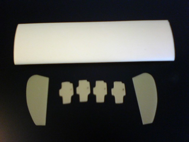

Blisters that go where the wing begins dehydral and the ladder door insert.
All of you that have recieved kits from john and lowell will recieve all these extra parts. I have six kits left that i will include all the detail, including the pylons when they get finished. Unfortunately, the cost of casting resins and plastic sheets as well as time, start to get expensive with all the detail on this plane. I will include a basic detail package with every kit thereafter. But those of you who like more detail, there will be a price to pay. I have not figured it all out yet but the price will be in the $150 range for all the other extras. Sorry.
chris

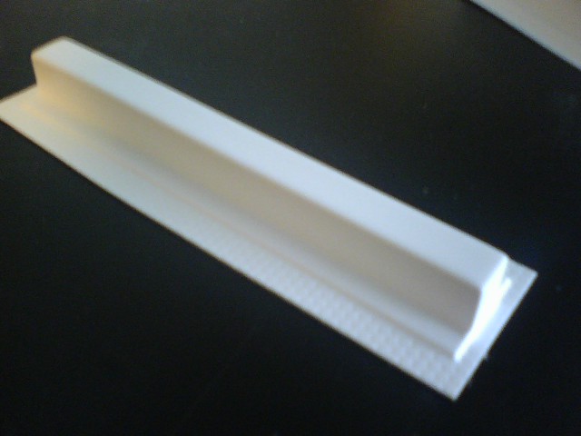

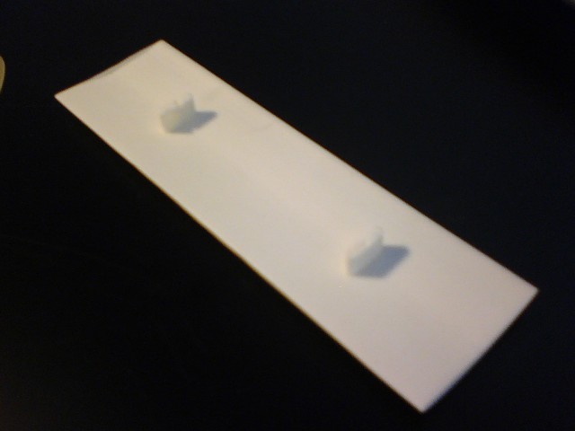

Here are the slats , stand offs and the strakes that goes on the end of the slat on the inner wing portion of the A10. The slats have an old mount setup that i did not like so these can be ground off and you can cut a slot for the standoffs in there place. You will also need to cut some small slots in the wing for these. The standoffs have tabs on both sides for joining the pieces together. In the picture i have marked the larger tab which goes into the slot that you cut into the slat. The smaller tabs goes into the wing. The strake will sit on this flat part of the leading edge and up against where the wing starts to look like a actual wing leading edge. CA the strake to the wing and slat. With the standoffs and strakes glued in place it locks it all in.
Oh and the slats will need to be lined up and trimmed flush (belt sanded is easiest) with wing root before gluing all this in place.
chris

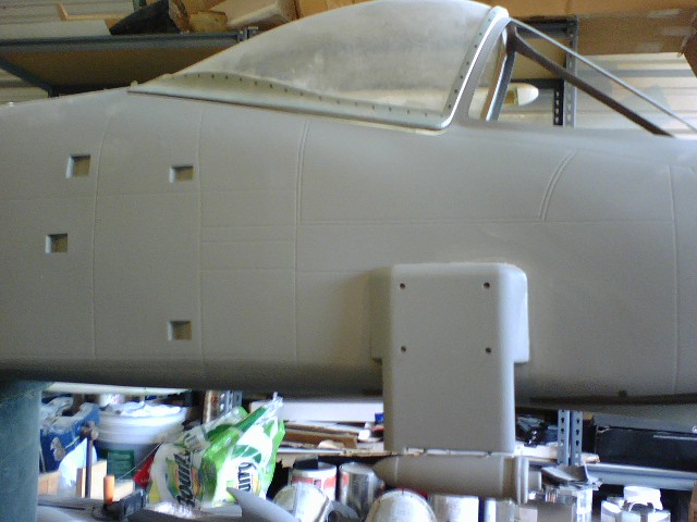

Pave penny laser tracker.
I attached the pod to the mount by drilling holes and using some small all thread and glued them in place. As for the lense, you can trim the flange off (more than in the pic) and take a fine point permanent marker and run it around it while spinning it to get a straight line. Use some sharp scissors and cut it at the line and sand it flat if needed. The lense is a little to long so dont cut it at the flange. You may have a problem with it obstructing the gear door in the down position. You should glue all this to the fuse after you figure out the clearance for the gear door.
The last picture shows the aprox. location. There is a panel line that it almost butts up against.
chris

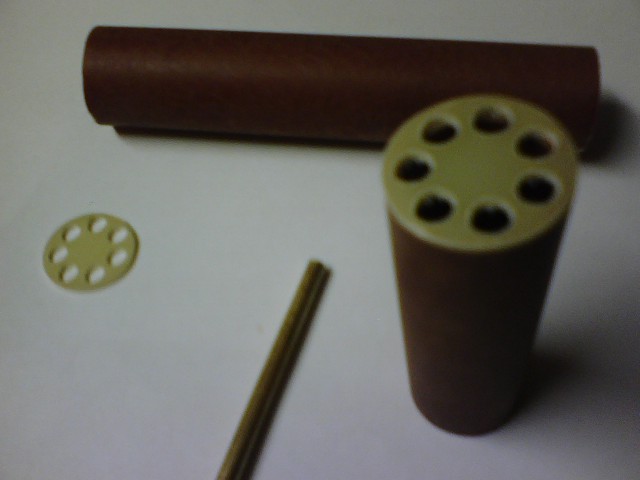

Sic
About a 1/16" to 1/8" of that inset should have remained around the perimeter of the inset ,so your gear doors would have had a flange to sit against. Like i siad, if you had already cut it out, you can put some bumpers in its place.
chris

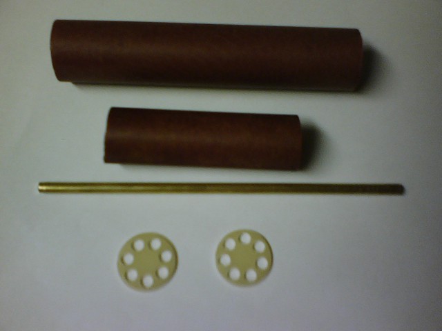

I have 2 different sizes of phenolic tubes, 3/16" brass tubing, and some end caps that i machine for the 3/16" barrels to slide through. The larger of the 2 tubes will need to be trimmed to fit the fuselodge and go back into the scoop. If you want to get real picky, the end of this shroud has a slight bevel to it. The small tube will need to be cut to size and the end caps glued on to each end as well as the venting holes drilled out around the barrels. You can then slide your 3/16" brass barrels through the end cap holes and glue them into place.Make sure you cut the smaller of the two tubes to the right length. This whole piece will not be that long because it will hit against the nose of the fuselodge when sliding it into the larger tube. There is a little amount of play between the tubes and you will need to shim it out with some thin material. I think i slid some 1/32" balsa in 4 spots to keep it all aligned. The wall thickness on the smaller tube is pretty thick and will need to be drum sanded out in order for the barrels to slide through. Unfortunately this size material does not come with a thinner wall. At least none that i have found.
chris

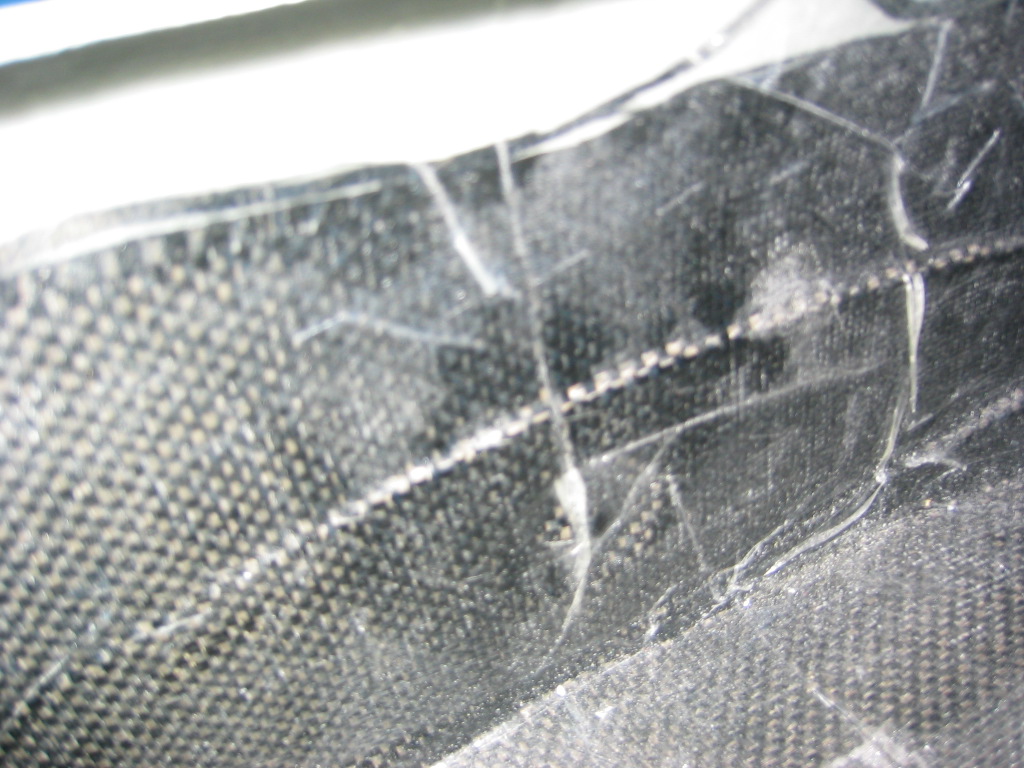

Some real pics for reference.

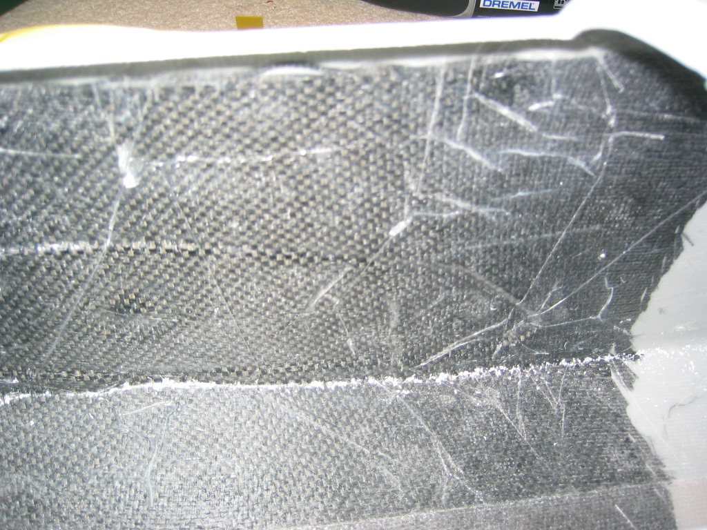

There should be an 1/8" piece already sandwhiched between the glass and carbon fiber in the wing area of the fuse. There were a couples fuselodges that i expiromented with as open mold layups but do not recall not adding this piece. Shoot me a pic and i will try and have a look see. The wingtube socket , like in the pic below, also gets glued through the fuselodge and makes this area a bit more rigid.
Did you get the 5/16" pins for the wing? The 2 outer holes will need to be drilled for these.
I cannot remember if i recieved that pm about the gear. Can you shoot me that one again?
chris

I'm not sure I fully understand about the doors. If I leave a lip on the gear door opening surely the cut out part will be too small to use as the door? It certainly wouldn't be able to sit correctly against the flange.
The wing part of the fuselage does look like your photo so hopefully I won't have to add any reinforcement. I will have a look when I drill for the wings tubes. I will have to look and see if I have a wingtube socket as I can't remember seeing it. Hopefully it is there somewhere.
Unfortunately, apart from 2 bits that I still haven't identified and the main wing tube, I have nothing else in my kit. No wings pins. No hinges (apart from the composite flap ones) and no hardware apart from the bits in the photos on the first page[&o]

I thought they were going to put a hardware pack in the kit for you. I guess not. Check to make sure you have all this and what you do not have i will try and send out asap.
The actual door skin is a separate piece. The piece you cut out can be discarded. I will need to send you these also. The door detail in the pics will go on the skin and all that should have sit on the flange that you were cutting on.

Chris,
What are the parts in the first pic?
I have taken a couple of very bad pics of the fuselage wing area. Can you tell from those whether I need to add any further reinforcement here?

Ah, I think I've worked out what those pieces are. Wing fairings?
Should there be a moulding for the gun scoop in the kit?
