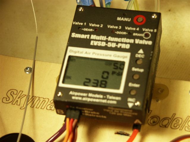

Thanks for the great info Todd, I e-mail Air Power few days ago regarding an issue that I have with my unit, still no reply from Air power yet. Could you give tell me how to reset the PSI screen.
On the screen the PSI stays at 238, I power down & back up many times, there is no air in the unit. Also the system can not hold air longer than 2 mins. and the PSI is still showing 238 see photo.
Thanks in advance
Thanks in advance

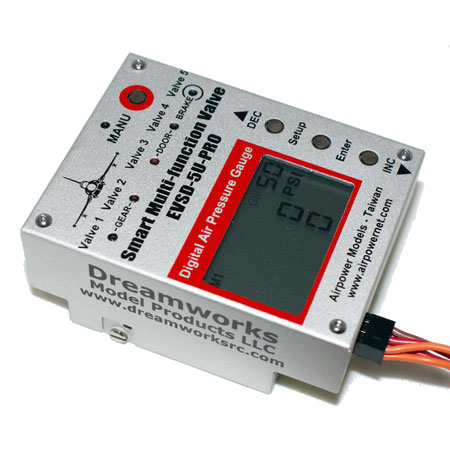

Al,
Who was your supplier for the EV5U-PRO valve? The unit pictured is not supplied from Dreamworks, our model is silver in color to differentiate ours from other suppliers. I would request you contact your supplier first for replacement! If they are unable (or unwilling) to help, let me know and I will handle the replacement.
Todd
Todd
