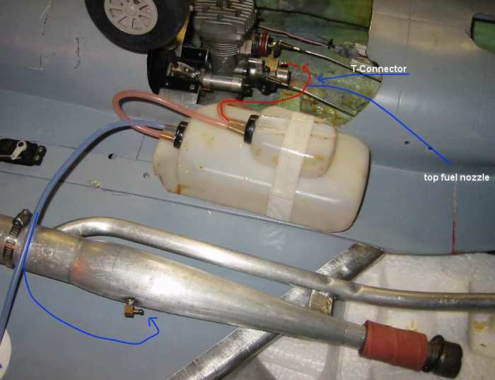

Hi everybody, first time to post here.
I recently got a great deal on a used byron f-16, it 's my first gas ducted fan and I had a few questions about the fuel system.
I have attached a image showing how I think it works, but I'm not sure if it's right.
When I got the plane I noticed the fuel nozzle on top of the fuse right behind the canopy, this was not hooked up, but I would like to hook it up for easy fueling. Let me know if the picture looks correct in hooking the, system, and the fueling nozzle.

Should I clamp the hose leading to the pipe during fueling to prevent fuel from getting in there? I think this happened the last time I tryed to fuel it, it filled up. Any tips on keeeping this from happening would help alot.

Ryan,
One thing is certain, you will get a multitude of replies on this and everyone will have their own way of doing it. I have only had three Byron F-16's and I am certain that getting rid of the original fuel manifold is a must which is not in your diagram. clamping the line to the pipe will just prevent the tanks from filling, as the tanks will simply pressurize and stop filling. either disconnect the line from the pipe when filling or else really watch carefully when you are nearly full to prevent fuel from going into the pipe. Then make sure you plug the fill line when you go to run the engine to prevent air from entering the fill line. I would never say anyone else's way is wrong, or mine is right. you set up as diagram is shown should work with the above cautions..
oh yeah, to make sure that the big tank is filled completely you will need to make sure that the vent tubing is bent up very near to the top of that tank so that it fill to the top before it would ever go out to the pipe.

Some of you guys may be jumping the gun here. If the fuel valve is located on top of the fuse, he may already have a robart fueler installed. It's black and tear dropped shaped. The byron fueler was 2 1/2 to 3 inch long rectangular contraption with a lever on top. The set up in your picture is a 20-24 oz. tank with a smaller header tank. Nothing wrong with that set up at all. Jack's soda bottle set-up works well too. Anyway, see what kind of fuel valve you have on top of your jet and let us know. You can see pictures of f-16 tank set-up in my gallery.

You asked for another idea........I used to use a pair of Sullivan DF 11 oz tanks tucked into the wing shelf. One on each side of the engine in front of the retracts and a 2 oz hopper on one side in the same shelf. plumbe in series. ....... engine to Hopper, to tank on same side then to tank on the other side to pressure fitting on pipe. I have set them up with out the pressure fitting also. Just had to run it a bit richer.
The above system along with putting the tuned pipe up under the canopy, really cleans up the airflow inside of the Byron f-16. Worth about 15 MPH. BION.
