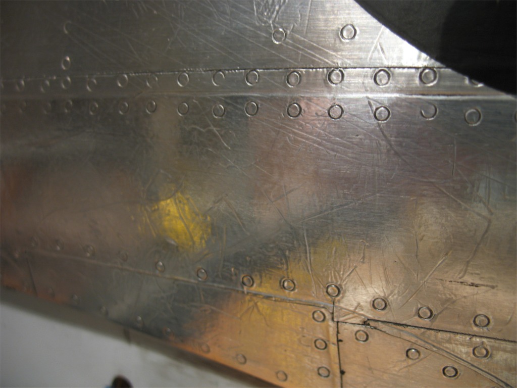

It looks good until you get close to it. Whoever applied the Flite Metal didn't really know what they were doing. The indentions and wrinkles are from using the wrong tools when applying the panels. Some of these could be removed with wet sanding but I would rather start fresh and do it right and then clear coat it to protect the metal. I knew what I was getting when I traded my Yellow Aircraft F-15 for it so I'm not complaining, just stating my intentions. I still think I got a good deal when I traded my Yellow Aircraft F-15 RTF minus the turbine for the F-86 RTF minus the turbine.
Kirk

Kirk, you aren't kidding when you said they used the wrong tool. seems crazy to work so hard to prep the surface for FM, only to apply it like that. If there is anyone who can fix it, it's you! How do you think you can remove it? Heat to soften the glue? Is the wing and stab a composite like the fuse...ie, will the FM be removable without damaging the surface? I'd say outfit it with the EDF gear you want, fly it, then take advantage of the wonderful ( [] ) east coast building season to refinish it. Can't wait to see how you progress. Btw, you should start a new thread with this...
