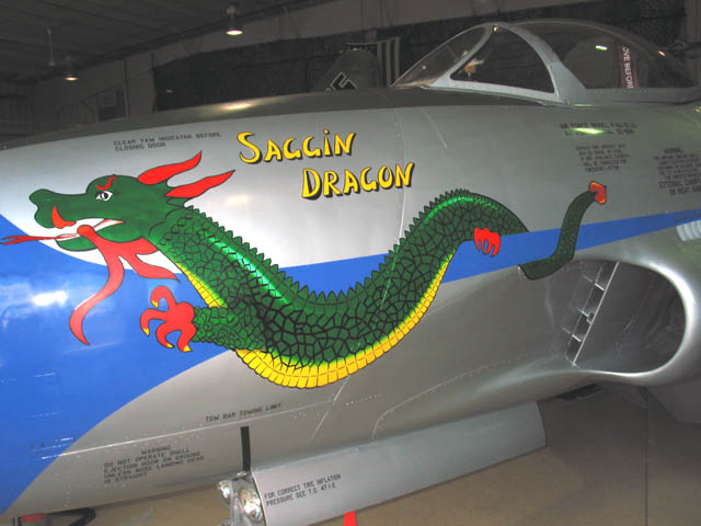

Kirk thank you for the extra information.
Ross, the F-86 is just a consideration. The top of the heap is the F-80
Here's a picture of the F-80 nose art that I intend to use.. took the pictures myself a week ago.. Extra cool!!
