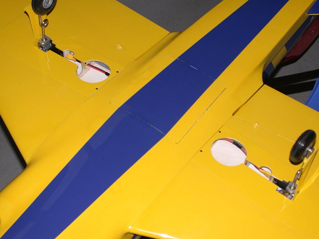

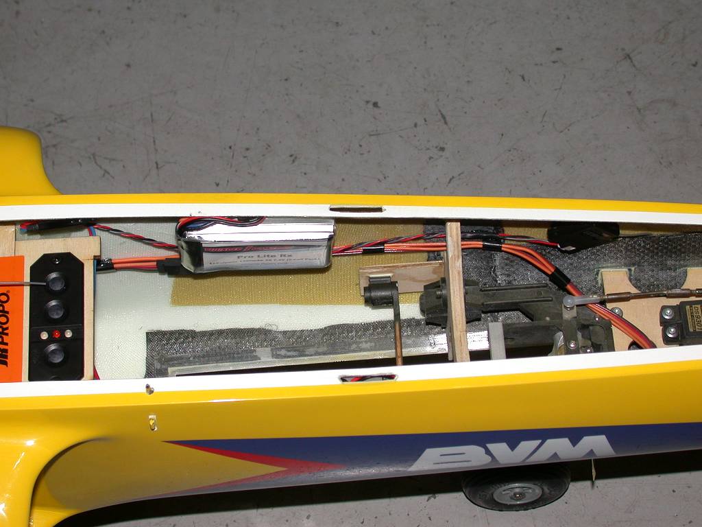

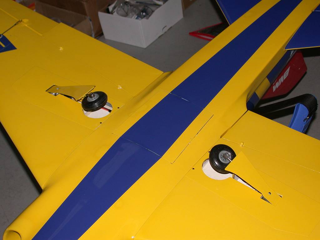

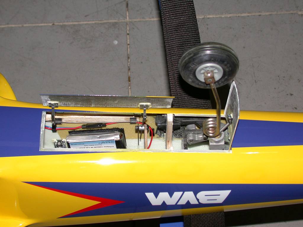

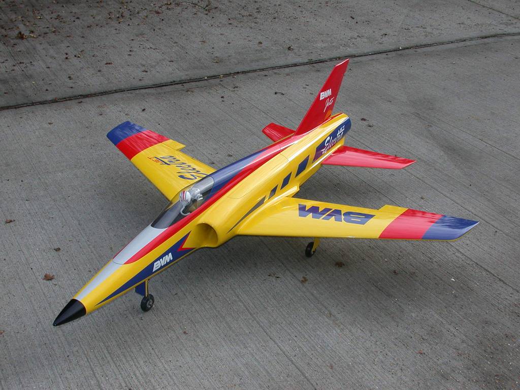

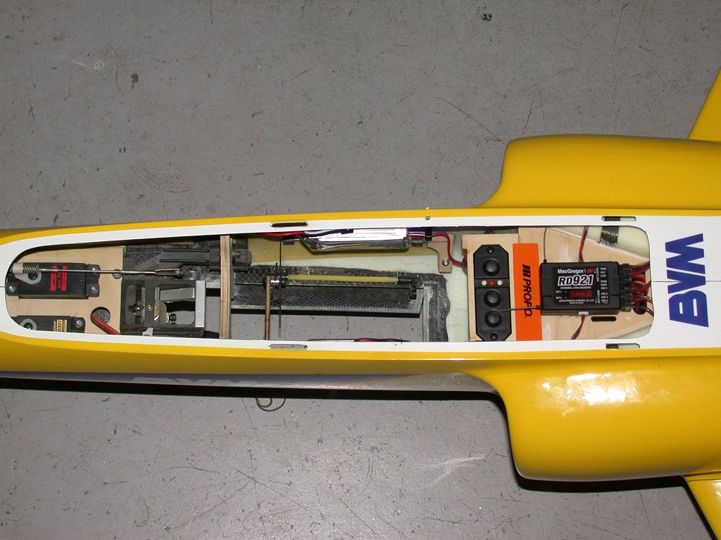

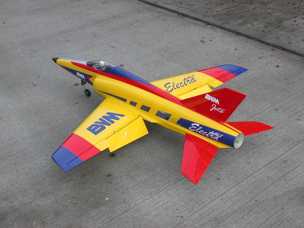

Default BVM Electra kit finished! EDF 4010

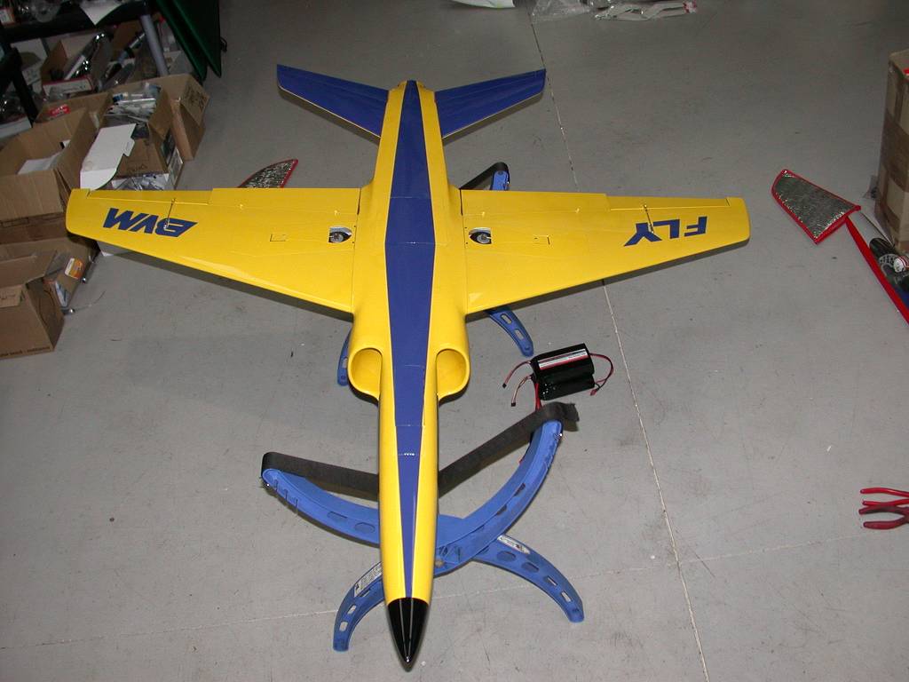

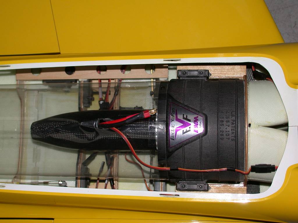

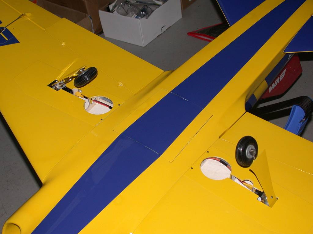

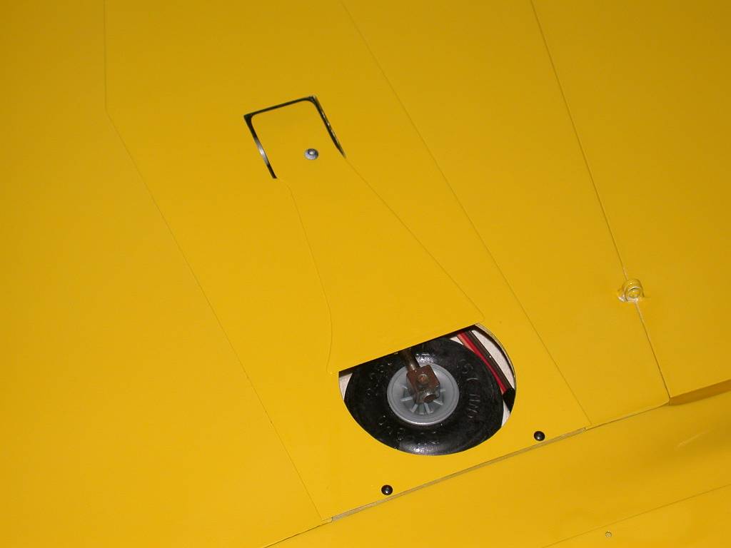

I finally finished the Electra last night (perfect timing as Inspirations arrived this AM!!) This model was painted by Mikey, in my opinion the finest model painter in the world, super light and super smooth. Because I started this so long ago it has a 4010 EDF, but now with 40c Thunderpower 10s packs I think performance will be good. After a long debate (with myself!) I decided to use a Powerbox Sensor switch with two TP 1320 Rx packs. I was going to run the retracts on one side and the controls on the other side, but decided to run both packs through the Rx as usual.
Hopefully if the weather forecasters are wrong as usual I'll fly it Sunday

Very nice paint job. It flies great with the 4010.

Nice Dave, it looks fantastic.

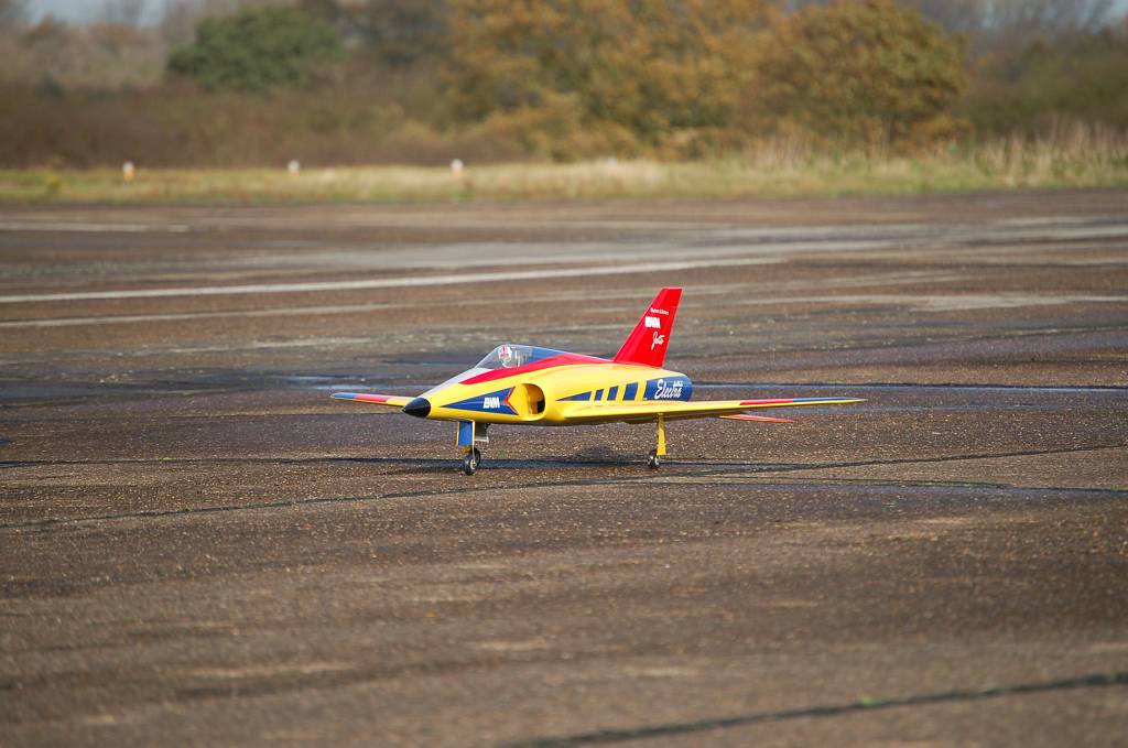

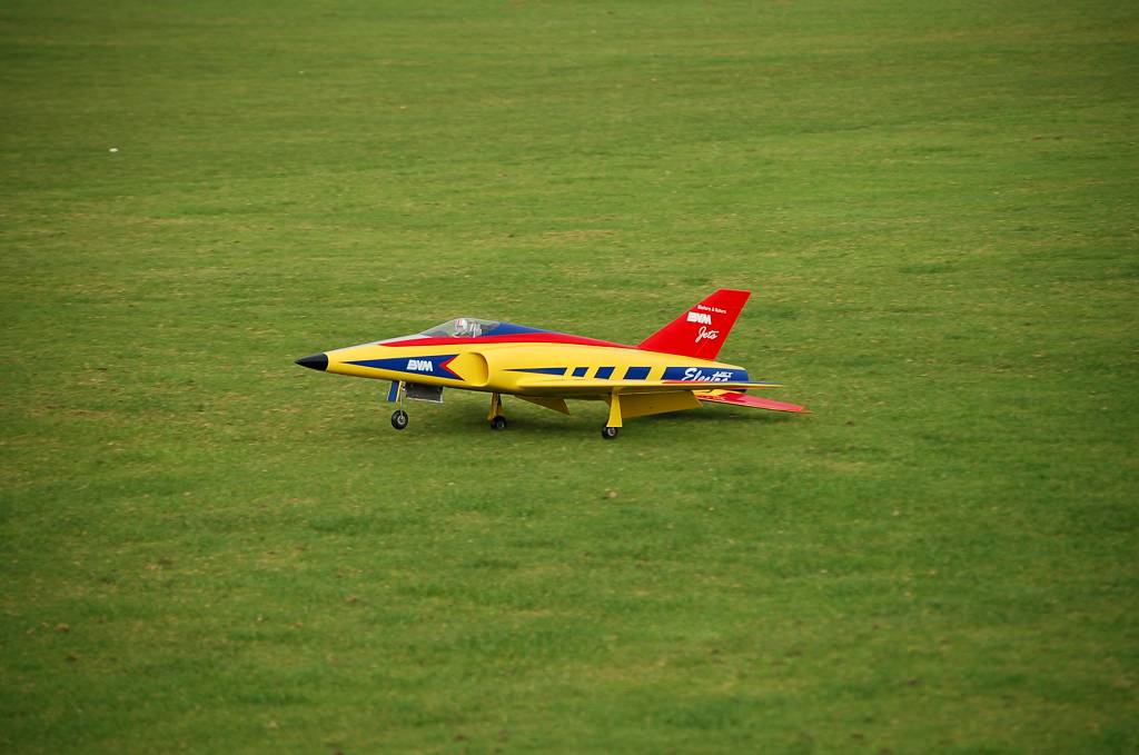

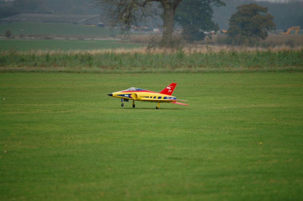

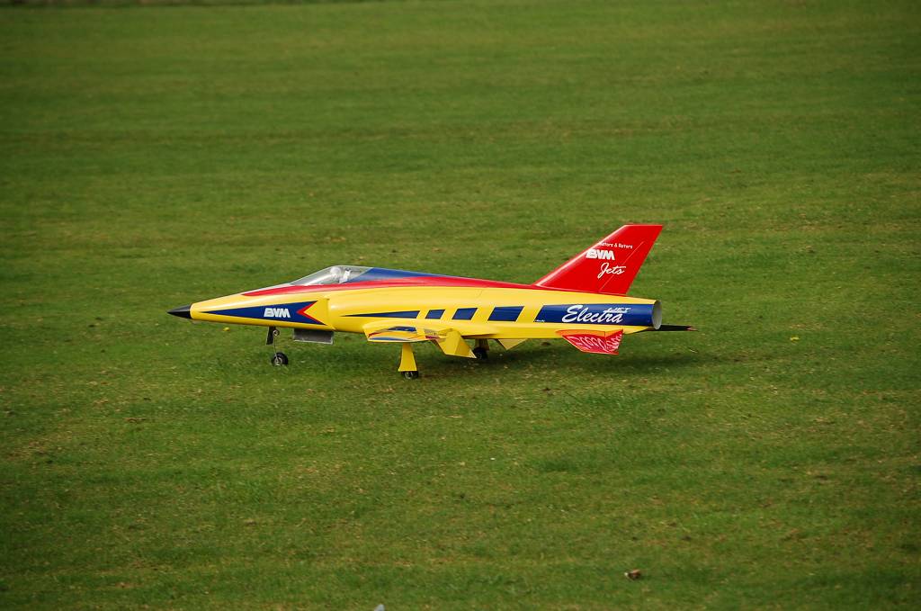

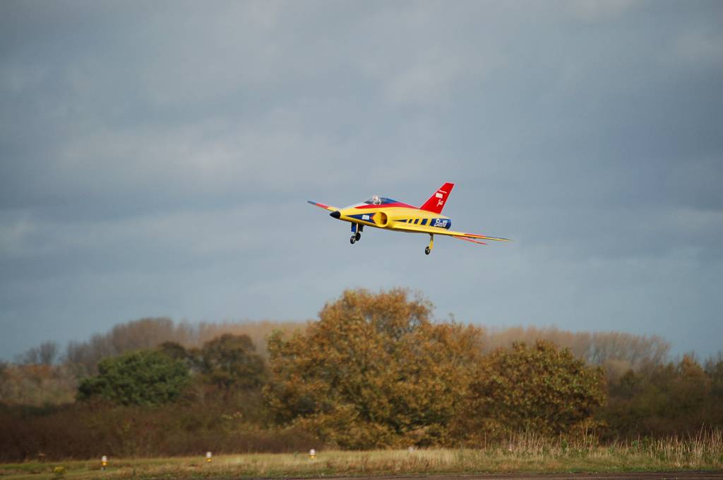

Test flight today, not ideal conditions as it had only just stopped raining and the grass was wet. Even so the take-off was surprisingly short. Still breaking in the 40c TP 6500 10s packs, so don't have an idea of true performance but the odd blast showed it's not as fast as the Sparks I fly, but it is quiet and lands very slowly. Problems with the mechanical nose set up stopped play today, I've listened to Uncle Bob and fitted a metal arm to the nose!;-)
If the forecast is wrong I'll fly it tomorrow at Chalgrove.
Take=off and landing shots by Stevie

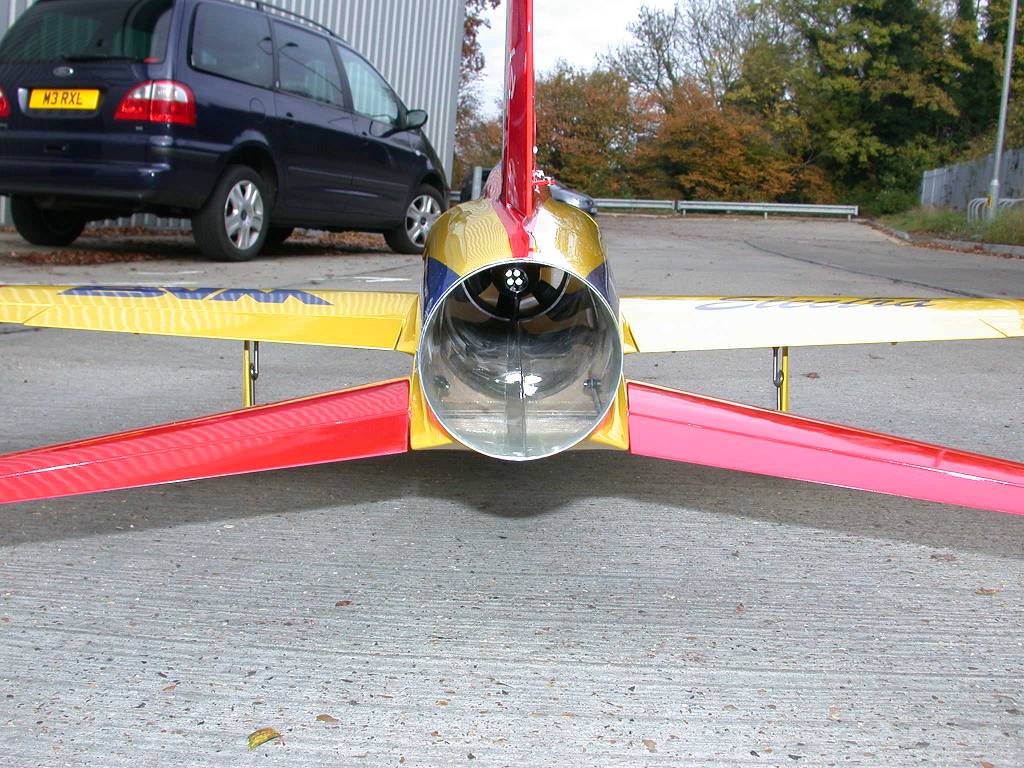

Your thrust tube does not look right, you should try to taper it down. From
the pics you provided it looks over sized and that will cost you some thrust.
Get with uncle Bob to find the correct diameter for the rear of the tube
Dave the one in the pic on the BVM site is an F-86 Sabre and they are telling you
to taper down the end to match the Sabre I dont know the specs on the Electra...

It's to the lazer marks! Lots of taper already compared with the Fan, not checked the FSA, but I'm sure it's correct

Dave, if you are on the ticks you are fine it will be 3 1/2 inches. I think the Sabre is smaller since the inlet is smaller.

You should be 3.5" according to BVM's web site;
"Electra Tailpipe - 31.375" length 3.5" exit diameter"
Looks right, the Electra mylar rubs on the fuse exit...

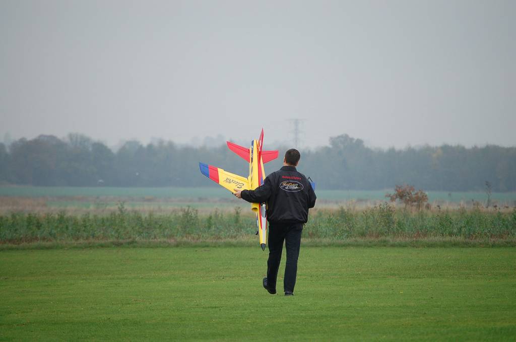

Another flight today, little tail heavy (I ignored instructions as BVM normally goes nose heavy, but I over did it!) Nice flying aeroplane, very quiet compared with my Spark's, but speed is less...
With corrected c of g I expect a really nice aeroplane.
