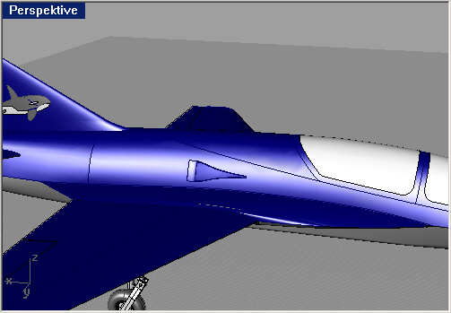

After a few days I started designing an aircraft that combines all his wishes
and a few more.
I designed a mid-wing aeroplane, that is completely made out of glass fiber
reinforced plastic, with a hatch that is nearly 3ft long. Furthermore I took big
aerobaticairfoils with airbrakes. All moving elevators and exchangeable fins
are also part of my idea. Finally the plane shall have an electric landing gear,
but ut should have the opportunity to fit in a mechanical one, too.
And thats what it looks like:
After getting all measures and thanks to my experiance in work with glass
fibre I am now able to say which weight the plane will have. Therefor I made this measure index.
The first aerodynamic measurements I made with FLZ Vortex. Secondly I built
a small model and sent it to a friend of my father, so that he can pu it into
the windtunnel. after a few days he wrote me his suggestion for improvements
and I directly improved my model.
And here the measures:

@E.N.T,
Hi! You can see the air intakes on the pic, NACA
