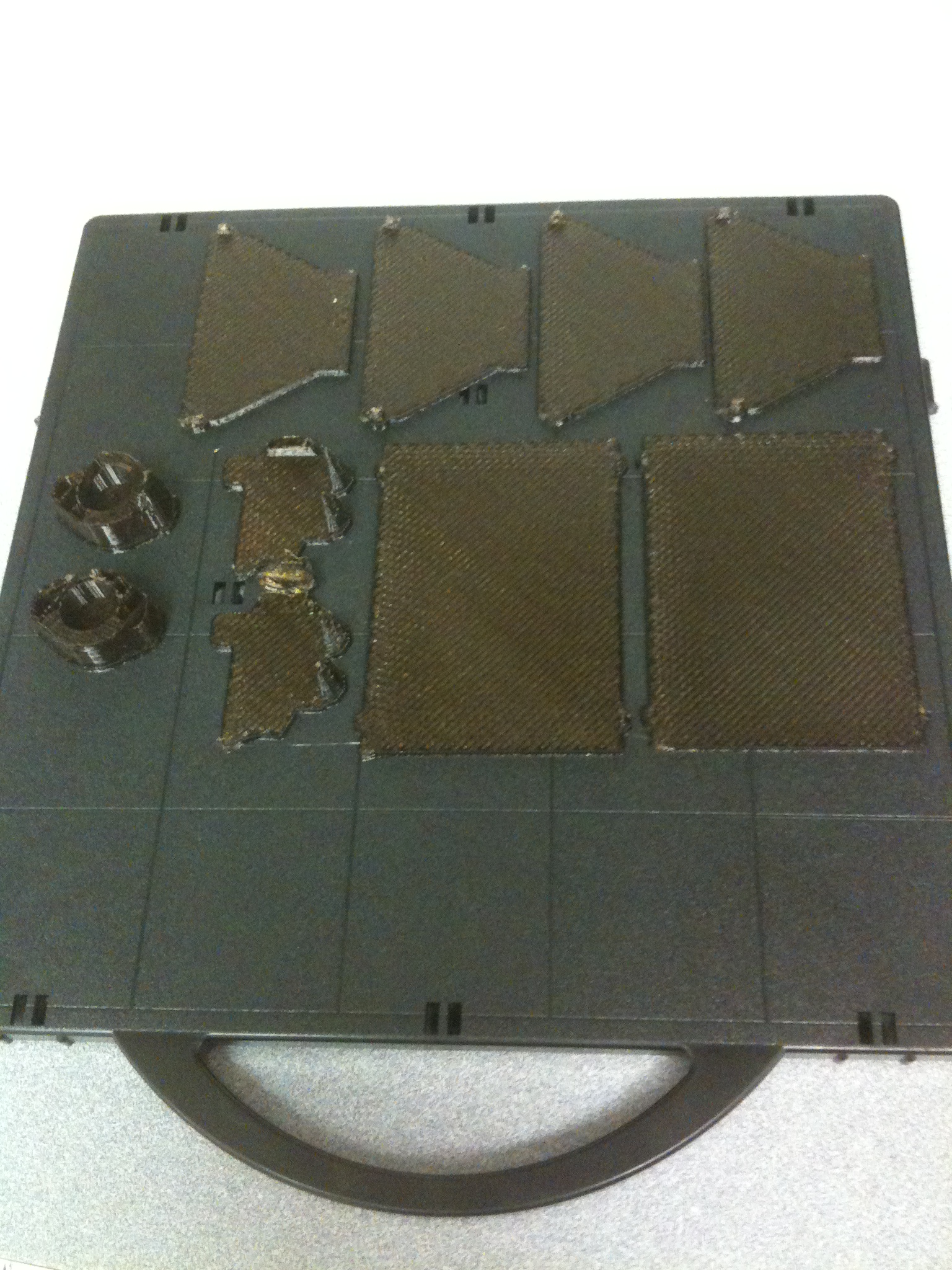

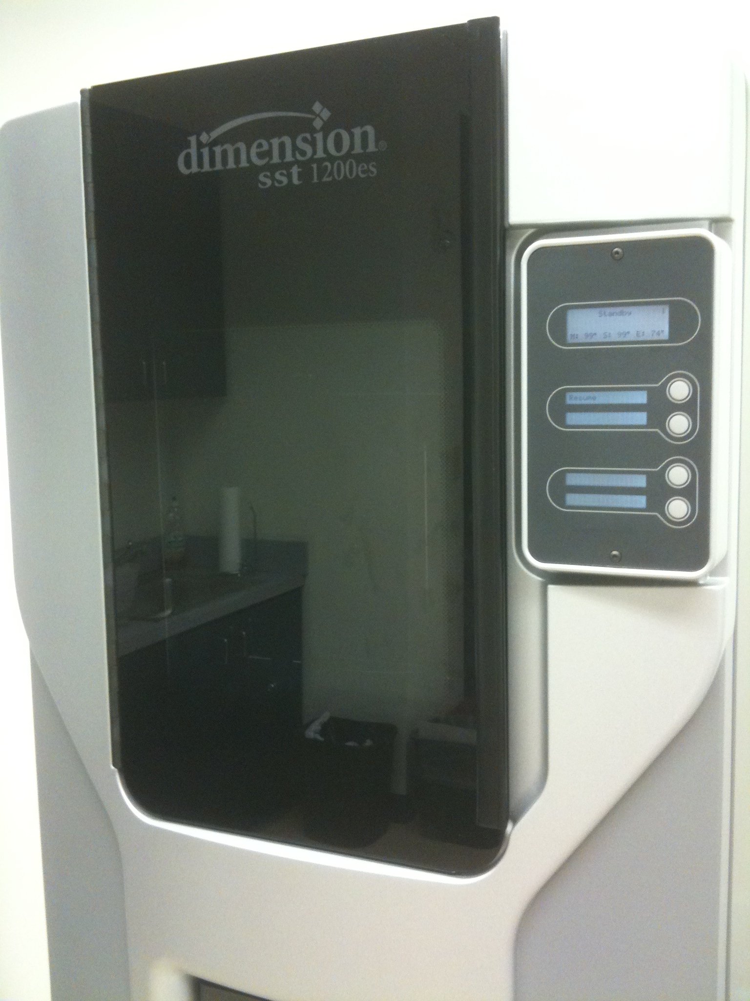

I have a Dimension 1200es in my office. I use it weekly and love it!
Dimension uses FDM (Fused Deposition Modeling). The material is ABS. The parts themselves are quite good - However, they need benching (filling and sanding) if you want a smooth surface. The FDM process leaves light ridges and patterns on the part.
The material comes in a cartridge that yeilds 56 cu. in. of build. You also need the Support Material cartridge (again, 56 cu. in.).
Each cartridge, material and support, costs $250 USD.
The Dimension 1200 printers build on a disposable 10" x 10" platform which you need to replace every time you use the machine. Each platform costs $5.25 USD.
I have an uber-scale 1/9 cockpit designed and ready for my Y/A F-15. I've also designed a set of scale strut details, antennae, missile details, launcher details, etc for the Eagle.
It's a great tool and time saver, but you also have to include the price of a CAD seat, cleaning station, maintenance suite and disposables into the cost equation.
