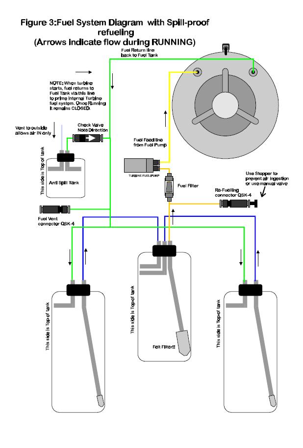

Hi David,
This is from the KS manual. The anti-spill tank works 100% to keep JETA1 from your car. The fuel system depicted also keeps overflow from getting onto pit area when refueling. Its fuel and forget and enviromentaly sound.
BRG
Andre
