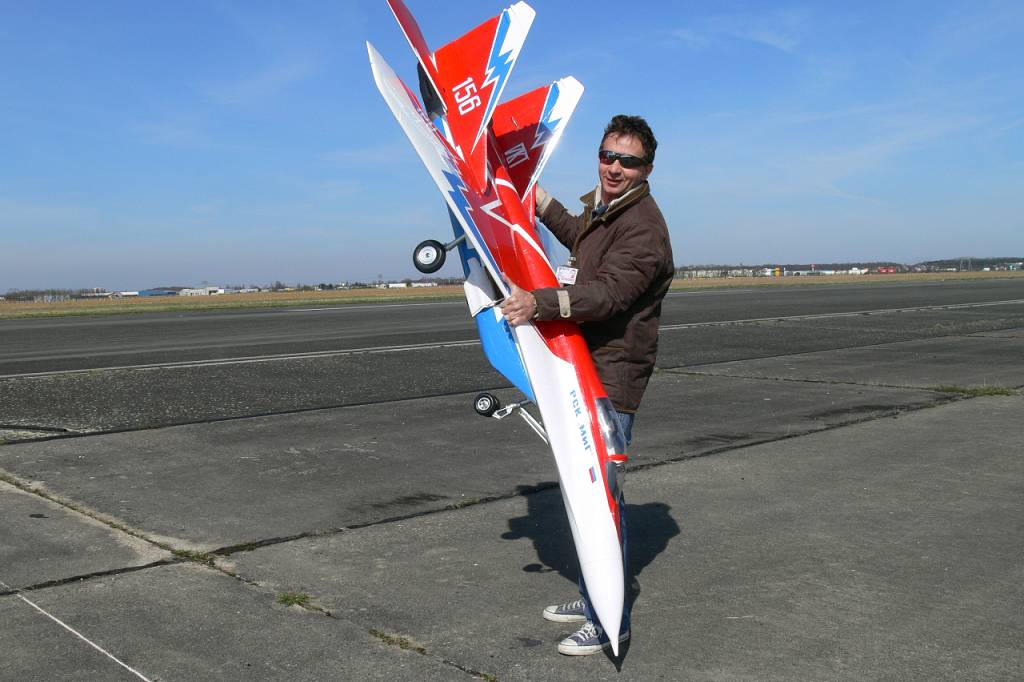

Hello ,
I use JR DS 3401 for rudder and ailerons,perfect size and power.
Regards.Etienne.
